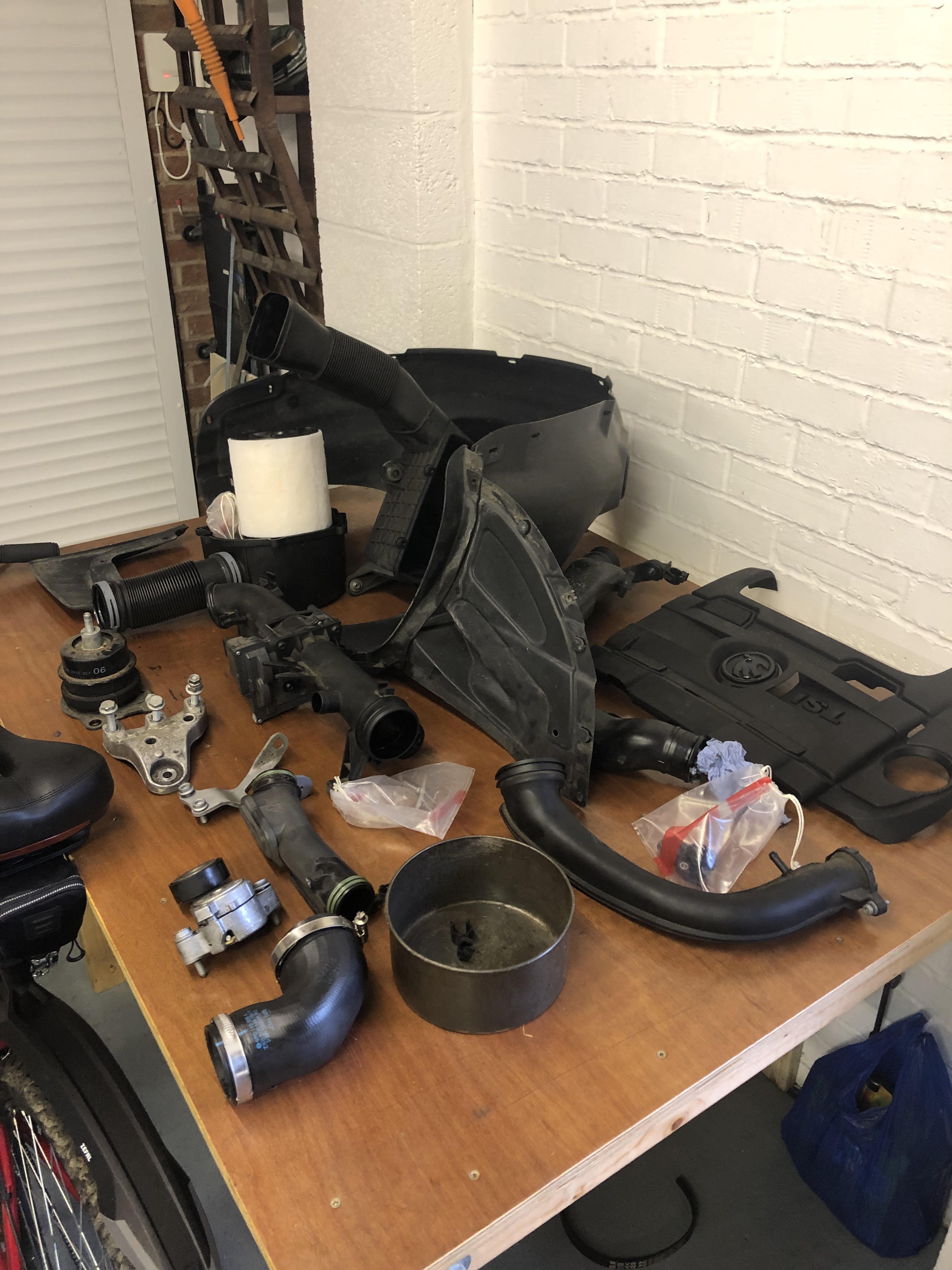

If I'm honest, not noticed any real noise with the car until the other day, took the wife shopping and whilst she popped into the shop I was parked between 2 other cars with the engine idling. Opened the window to let some air in and noticed a noise when she was running, not easy to describe, but sort of grating, intermittent rattling, not to loud, but noticable enough from what is normally a quiet little engine.
after call to local VW dealer and lots of money spent on order parts :blink: and then a few hours in the garage..........I have a bench full of lots of removed bits to get to the dreaded water pump.
The person / s  that designed many things on this twin charger were to put it bluntly..... f'in idiots, in 25 years of tinkering with all makes of cars I have never come across the mess that this engine is when you need to access / fix something. Some things are just plain WTF.....!!!
The bench of bits and a little video of the rattling culprit.
