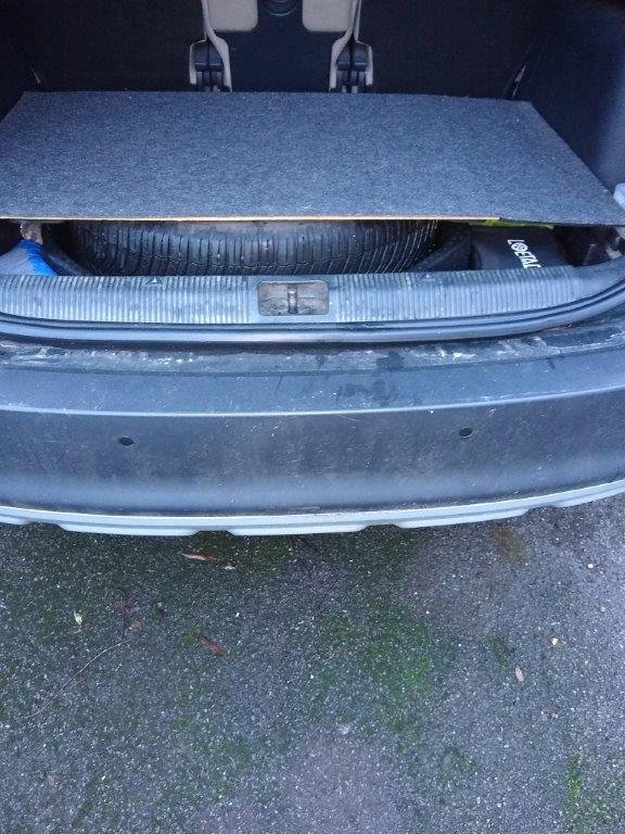

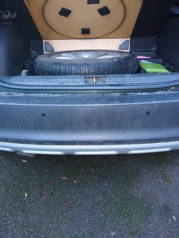

I've just switched one of my wheels for the Skoda supplied spare so took the opportunity to take a couple of pictures of the road wheel in the boot. As you can se in terms of diameter it's a tight fit, the floor won't go completely down and finally because of the boss(?) in the centre of the wheel you can't lock it down into the well with the large plastic nut.
Mine are 16" wheels (rather than 17") with 215/60 R16 tyres so slightly larger than the tyre used on the same wheel for the Greenline.IMG_20211227_152356700.thumb.jpg.80184af700c687d1b2cd35044d22d2a6.jpgIMG_20211227_152411413.thumb.jpg.e8fa22f87a9ae592b4167dc8a894101b.jpg
What if the wheel is upside down, I can't remember the format?
As far as I can see it can only go in one way because, if the wheel has a boss, of the restraining "screw" in the middle of the well but more importantly you've got the polystyrene moulding that sits over that and holds the jack etc.
Even if you dispensed with the jack/tool holder (the bits could go in the other boxes alongside) and had the spare without a boss I don't think you gain anything because the tyre is the same diameter one side as the other.
The only way it might work would be to take out the surrounding boxes - which of course support the false floor which would then let the wheel drop flat on the floor of the well. But whether that would be enough to let the floor lie flat I don't know.
If Nimit is trying to get to the position where he could effectively have five wheels rather than four road wheels and a spare I think he's set himself a challenge!
