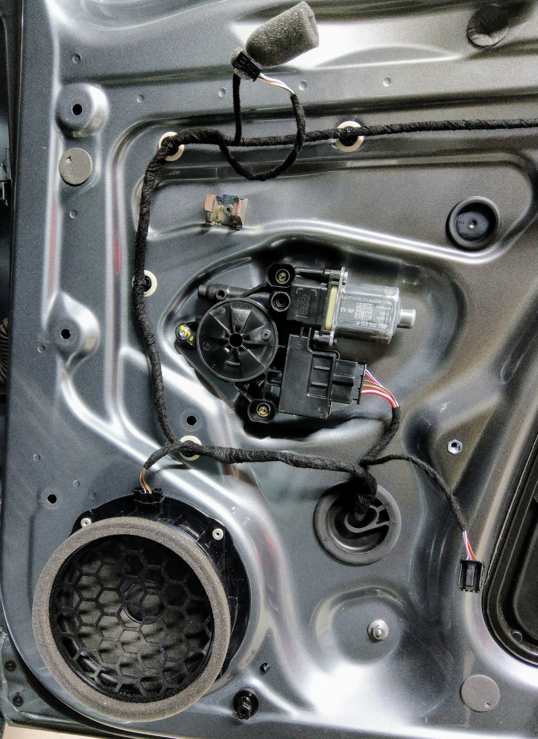

This is what I’d do also, but be aware, the speakers are riveted in and not screwed.

Do you know if it's a single speaker in each rear door? Also , how easy is it to access speaker?
Ta
If u have the Canton setup, there is a speaker riveted to the door, and another small one on the door card, next to the handle.
U will need to remove the door card to access both speakers.
