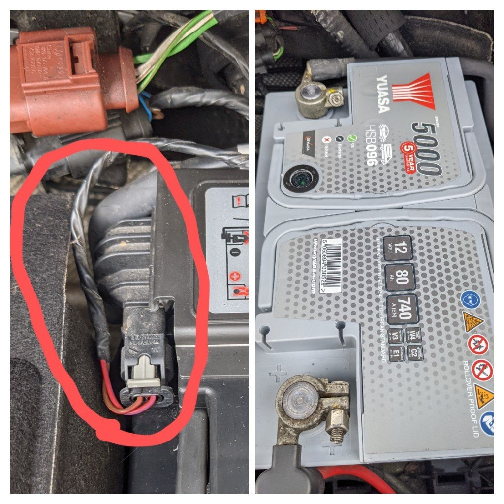

Just as an extra to this.
I've had a look at my other 2017 stop start Yeti and the battery connection has this extra cable which I belive is the battery monitoring.
The older Yeti (Yausa battery) doesn't have this but My Audi which was non stop start did.

It will also have a negative earth point to the right of the battery that must be used when charging or jump starting the car.
