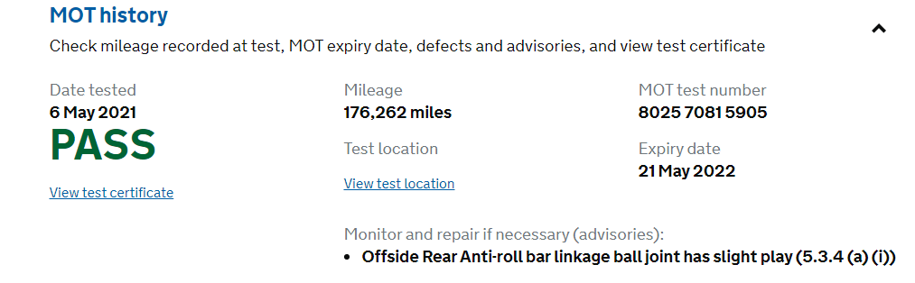

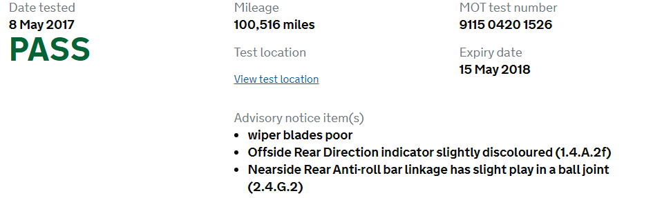

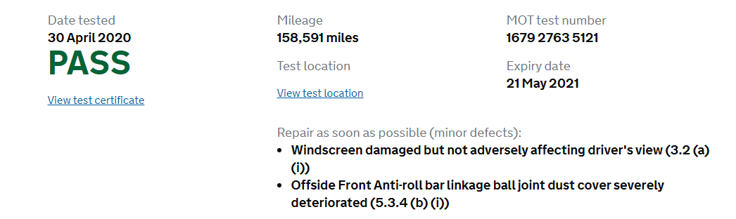

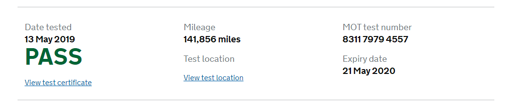

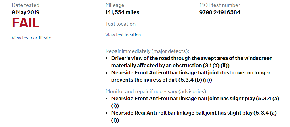

On checking the MOT history yes you're right the last 4 MOT's were carried out at the same garage. Looks like the MOT tester likes checking anti roll bar drop link ball joints! In 2019 the car must have had 1 front and 1 rear drop link changed as they were advisories on the 1st MOT which it failed and then not mentioned on the re-test 4 days later?
I can't say I noticed any play in the 2 rear linkage ball joints I changed the other day though admittedly I didn't check them on the car with a lever.
As previously posted I've also recently changed both front drop links one of which had play in a ball joint. Though can't remember which side it was now?  The only suspension related noise I could hear was after the front drivers side spring broke which also damaged the top bearing. When I changed both front suspension springs I found both gas dampers were very lethargic so changed them as well. At +180,000 miles not really surprising.
