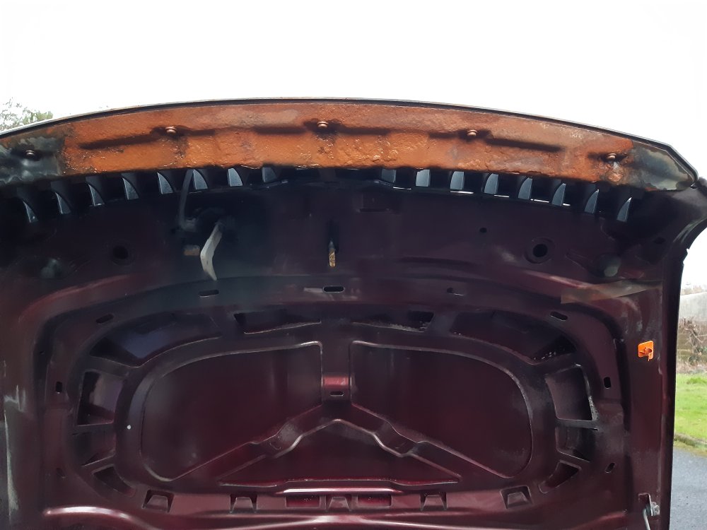

I would like to improve the look of this corroded panel underneath my bonnet (see attached picture) and have a few questions that I would be very grateful to anyone who can help
1) what is this part called and what is its purpose?
2) Is the part sold separately (local scrapyard would prefer to sell the entire bonnet as opposed to this part itself)?
3) There are 5 Torx t15/20 screws that can be easily removed, but how do I deal with the rivets that are also fastening it to the bonnet?
If I can't get a replacement then I want to take it off, remove the rust and flaky paint and paint it.
You could wire brush it now, then apply rust treatment.  The in another day sand it and apply more rust treatment. (After wire brushing you will know if too far gone to bother doing anymore with it.)
It could be prepped and painted as fitted now without removal.

As you will see from the parts diagram HERE the bonnet is one piece, so your options are to fix it as suggested above or replace it.
Edited by MikeTheThinker
Isn't it number 40 in the diagram here?:
https://skoda.7zap.com/en/cz/octavia/oct/2011-663/8/823-823010/#40
Searching that part number on eBay gives me the right part:
https://www.ebay.co.uk/itm/Public-6502-07-7521992P-Support-radiator-grille-for-SKODA-/165099346629?mkcid=16&mkevt=1&_trksid=p2349624.m46890.l49286&mkrid=707-127634-2357-0
That said, roottoot's suggestion is probably still a better solution.

Wire brush and Hammerite paint.

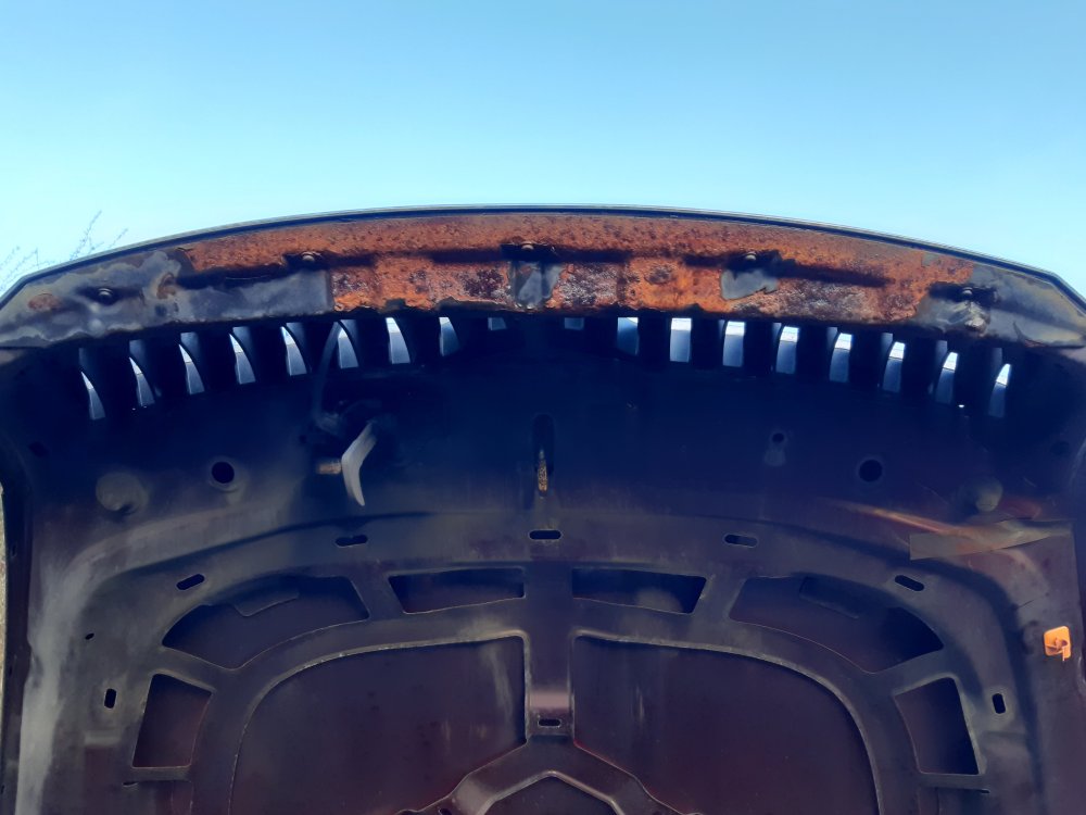

Tried cleaning it with wire brush attachment on drill. Should I continue brushing?
Chip any flaky bits away with a screwdriver using a woodpecker like action (wear eye protection), don't go mad, just use the weight of the screwdriver and don't aim for baby smooth then a couple of generous coats of Hammerite and it should outlive the rest of the car.
