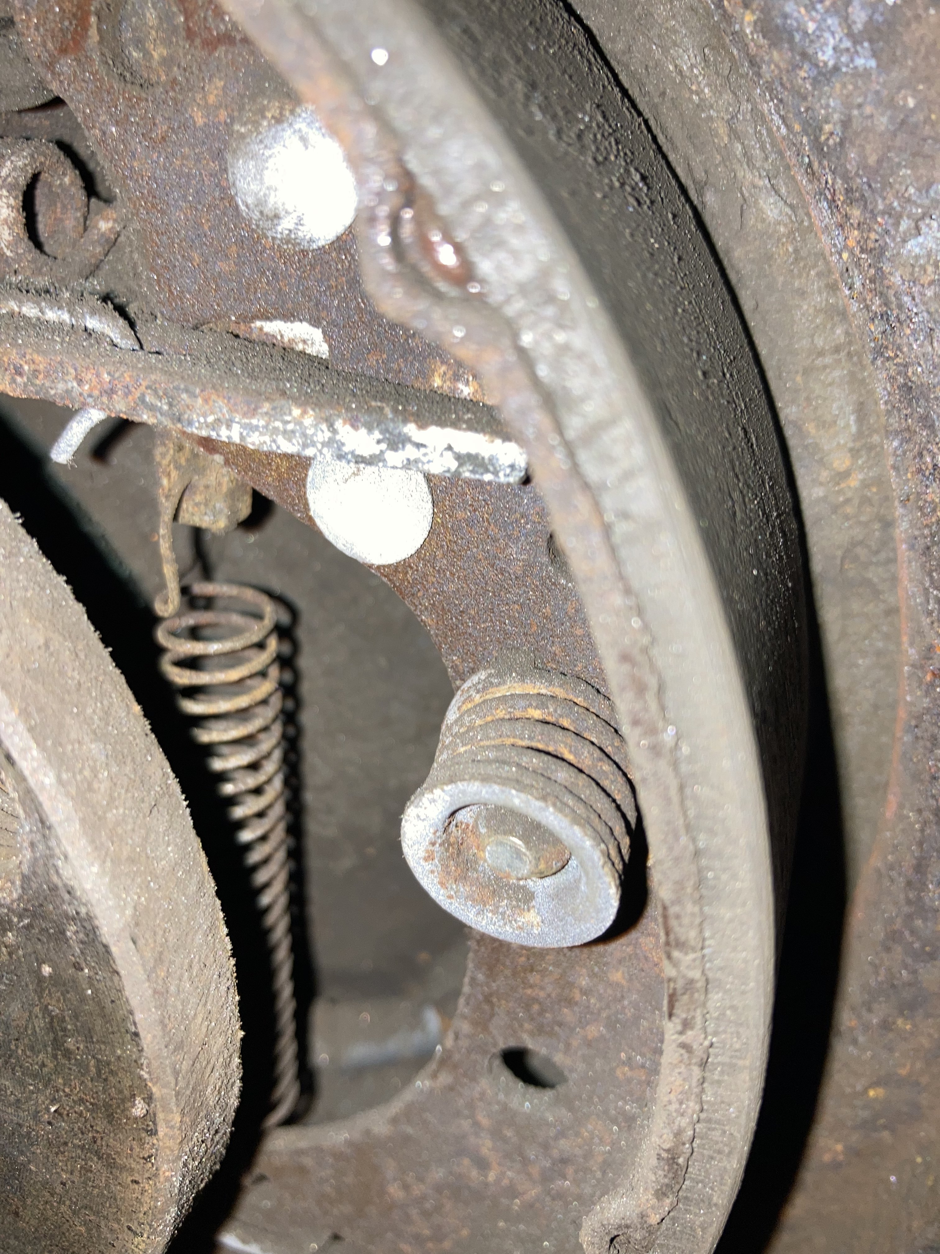

Looking at a friend’s rear drum brakes - it  Recently had new handbrake cables from local garage who dispute it’s come back from them (twice) with a new grinding noise
Brake travel a bit long but improves with a bit of handbrake.
I suspect d the tapered adjuster was either at its limit and/or the teeth on it are worn.
The shoes have plenty lining and the drum has no wear ridge at its rim.
However as I tapped the stiff adjuster

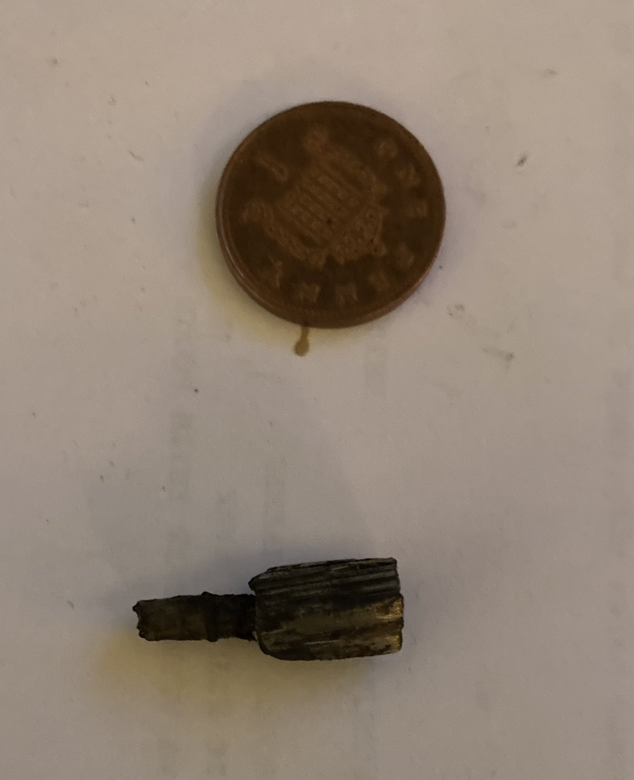

I also found the reason for the intermittent terrible grinding noise as something fell to the floor - if replacing a broken handbrake cable, best to remove the old end fitting  as well as fitting a new one !!
I expect they’ll deny it.

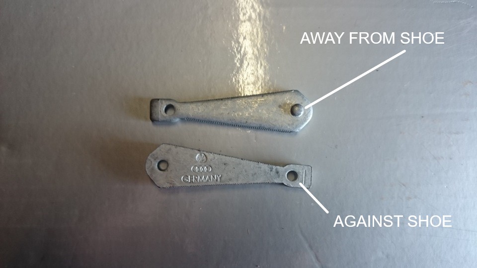

As an aside, does the tapered adjuster sit in front or behind the brake shoe ? Mine are behind. 1A8C4486-CD8A-403A-A1B9-5997CF7520B0.thumb.jpeg.43f4d8be6f907e686b90ad10fe106964.jpegI notice drawing of  replacement ones look like there’s a hole at both ends - mine have a boss at the wide end which engages in a hole in the brake shoe when the adjuster is fully retracted.
The adjuster wedges go at the back and you have to get the wedges the right way around. One side has a dimple and the other side has a protrusion. The smooth dimple side goes against the shoe. If you get it the wrong way around they will jam and fail to work.

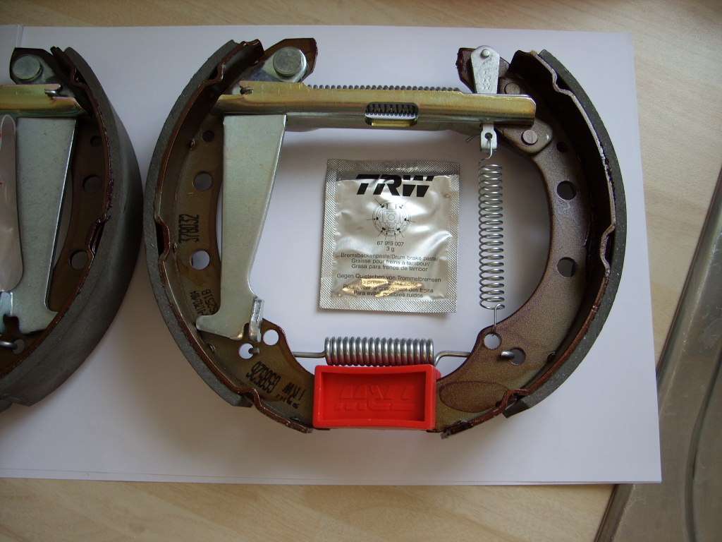

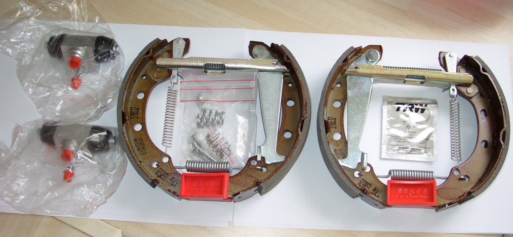

This was mine when I fitted a full pre-assembled brake overhaul kit...

It’s on the wrong way round - which will be why it’s sitting at a slight angle to the shoe. I suspected as much.
Thanks for the advice and clear pics.
I guess the boss is so it can’t fall through if the shoes are v worn ie some kind of limit stop
When I took it apart the drum came off easily and the adjuster boss was sitting in the hole in the shoe which would be why the brakes weren’t self adjusting. I’ll be interested to see what the other side looks like !
No probs. Yes, the boss is just a stop in case the wedge went right down.

I’m sure I saw somewhere a supplier listing all the individual parts with diagrams and items like the T30 screws for the drums but for the life of me I can’t locate it again. Any ideas ?
