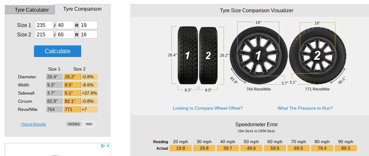

Anyone else had the same effect. Rolling radius is the same (235/40x19 vs 215/60x16)

Tyre width is different. I don't know about speed index or load index (not quoted), or tyre pressure (also not quoted) but these all have a bearing on fuel economy. So can use case, air pressure, relative humidity...
@Q102  Did you actually run a tape measure around the different tyre to be sure the Total Circumference is identical and the mileometer is reading the same for the different tyres?
(Rather than going by a tyre calculator.)

I suspect the wheel / tyre combo is quite a lot lighter, which should account for some of the difference.
Lighter, narrower, more sidewall (less rolling resistance). The same tyre size in a more summer oriented model will probably offer more mpg again.... All other conditions being the same of course. You need to take into account air temp, road surface, journeys travelled etc etc.
@brettikivi I do so wish that others would sit the wheel with tyre on a bathroom scale or any scale that is good for at least 23 kg so that they do know the difference from ones they are changing.  (as well as putting a tape measure around the tyre.)
