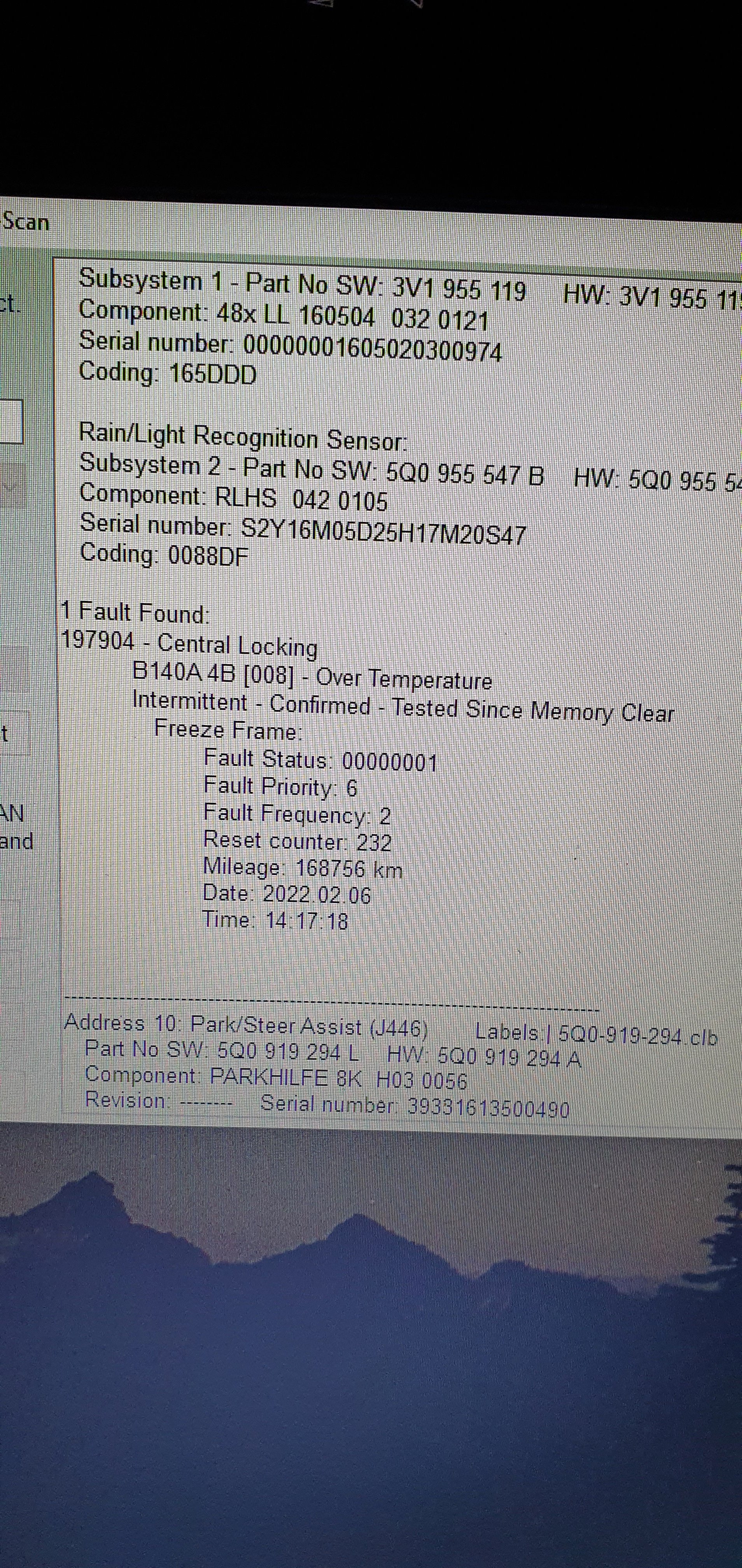

Okay, got vcds and scanned, got 1 fault-what does it mean?
Is it possible this can be the reason for my problem?
