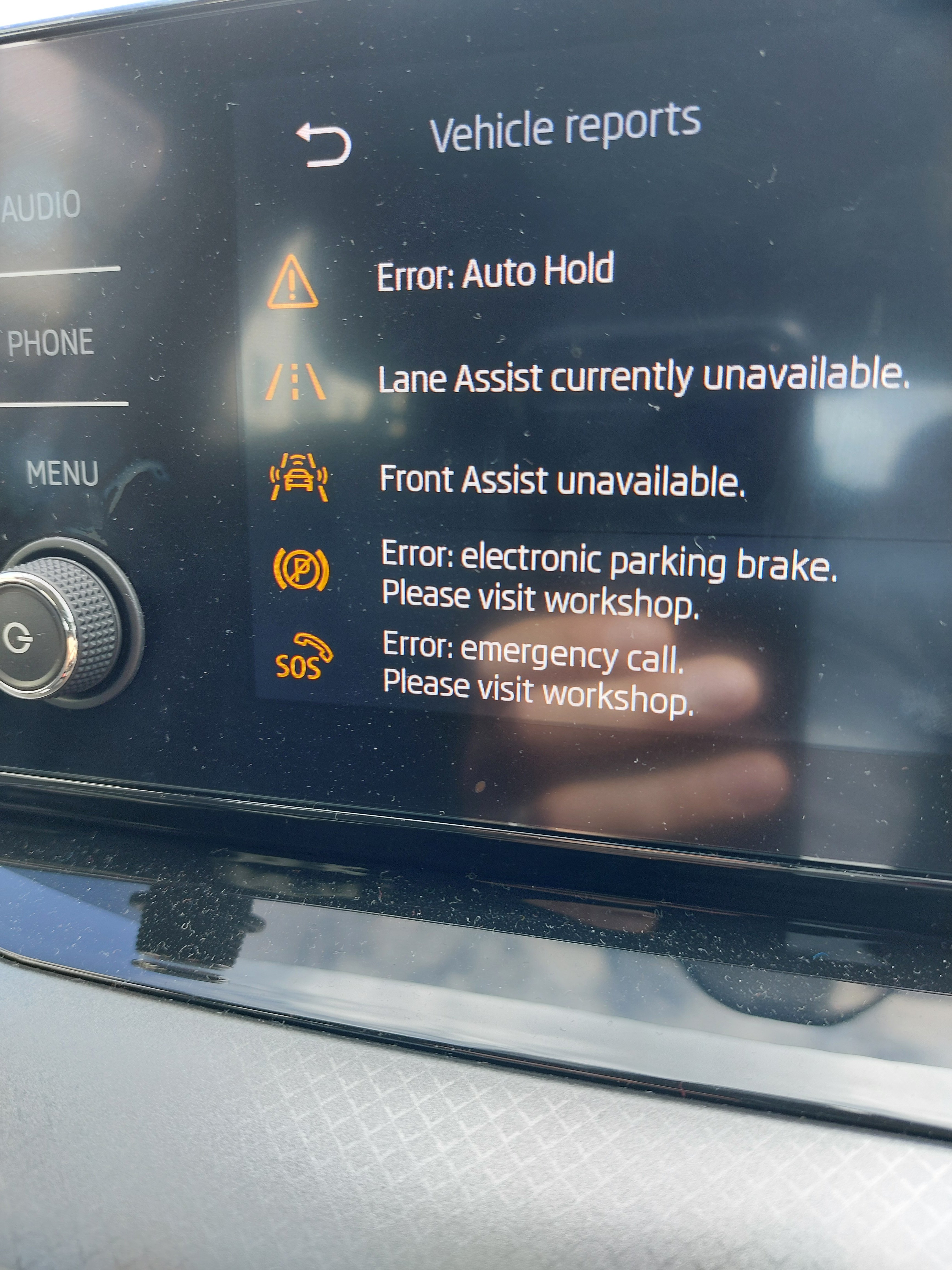

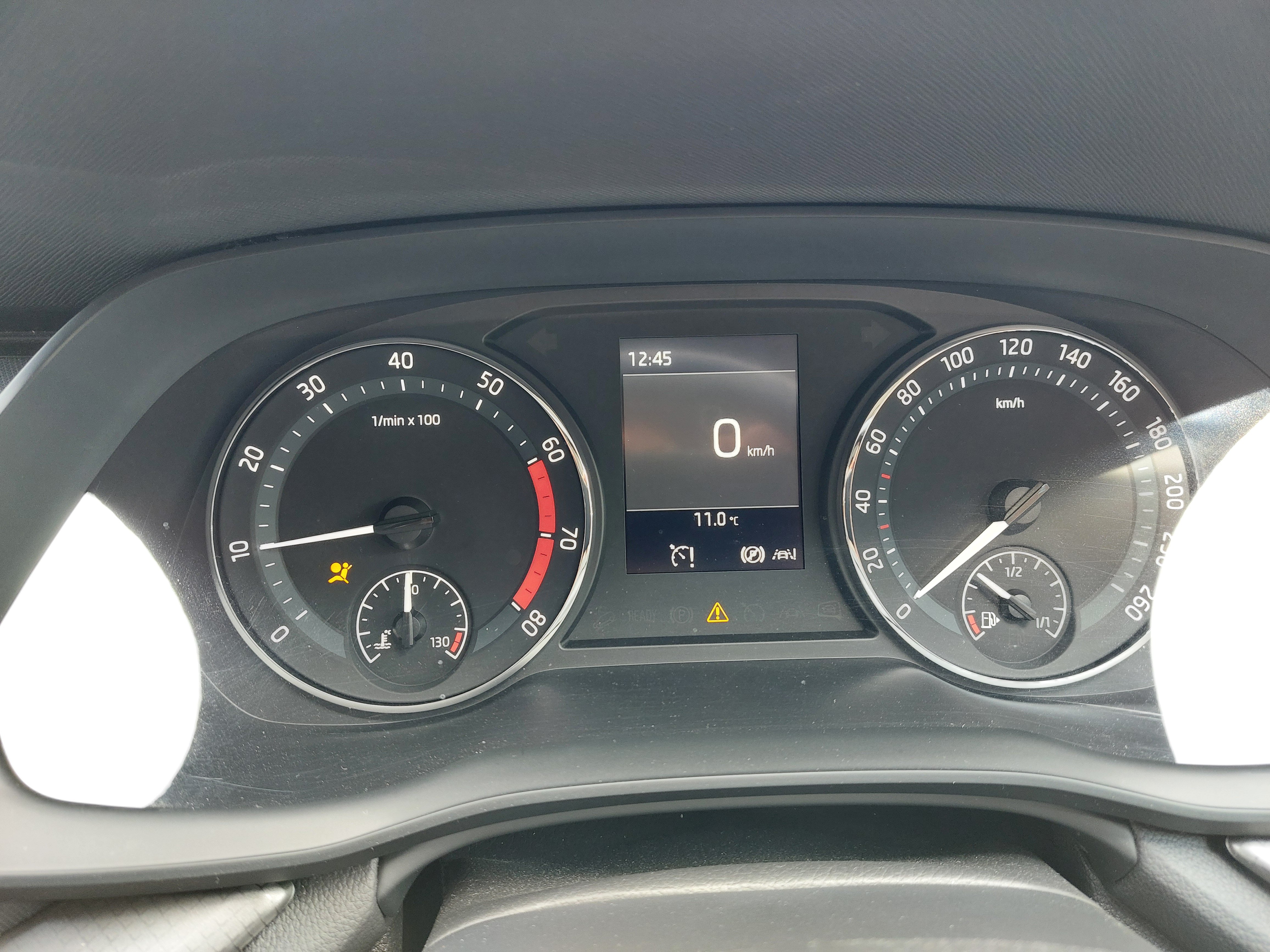

Hi guys,
Few days ago I had the same problem. When I started ignition, I've got several errors. Airbag, lane assist, start stop, auto hold, SOS, tyre pressus, ESC. I disconnected battery for few minutes and then I went to drive, all errors are gone except Airbag. I went to local garage to clear it but unsuccessfully. It showed airbag unit fault. I must go to Skoda dealer to check that. I found on this forum that could be problem with Airbag control module.  If is the problem with that, this will cost me €1000+. Car is out of warranty and Ireland doesn't have an option to buy extended warranty after 3 years20240427_123915.thumb.jpg.fc0617182202febbd0d39f510f66d8e8.jpg20240427_124516.thumb.jpg.9f352335b3954b32bd38d4af65d83331.jpg
