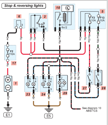

my right taillight plug has a adapter to tap of the grey red wires towards the bumper. as wel as a other cable. not the brown. are those for my back up sensors ?
please advise if
brown truely is earth.
and blue black is reverse light. currently i disconnected the camera to not create a short. or dagerous ( basicly i got a dc plug at the present.
ps blue black is pin 3 and brown is pin 4
if that helps
friedly regards michiel
It would seem that you have the right colours.
thank you so much for the quick reply.
i have some other suspisions. but i first wanted make sure i did good. i couldnt find this diagram. so wow thank you so much.
i wil keep topic active once i figur enit out
You are welcome :)
as stated above. it was the right wire. had to redo my connections. created one that did light up the cam nothing on the head unit yet. but wil work on that issue in the next days depending when my new electrical measurement comes in :)
#skoda great excuse for new tools ;)
