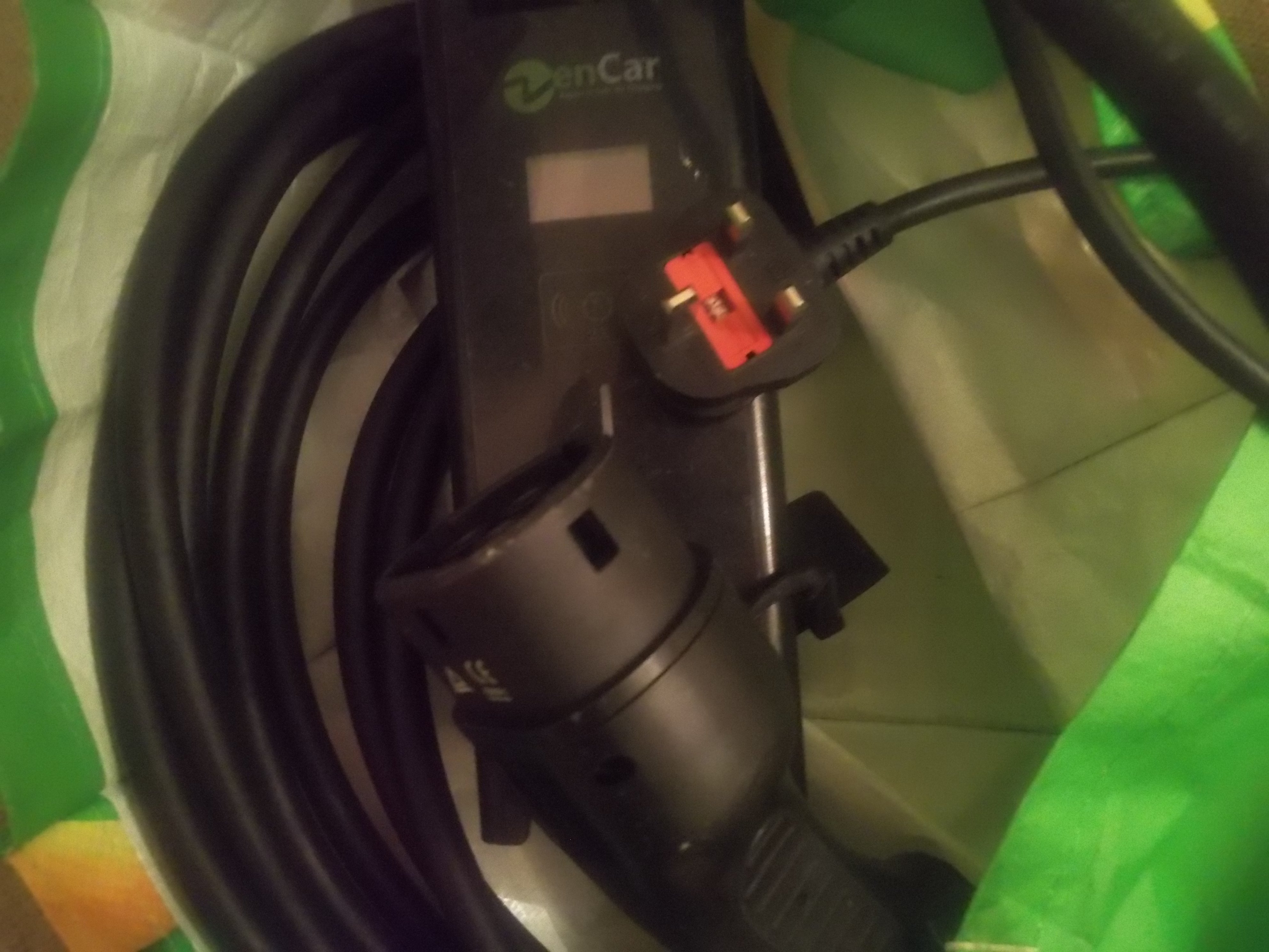

The plug on the cable have a resistor to tell the car how much power the cable is capable of. This information is also communicated by the EVSE (EV supply equipment, the thing shown in post 2) before charging session can start.
The EVSE should also have a temperature sensor on the plug pins so that it would stop charging if the domestic plug overheats.
But! Those domestic EVSE cables are meant for emergency-only, they will charge at 10 amp, not 13 amp due to prolonged charging session at 13 amp is a large ask compared to a few minutes for the kettle. Safest and best way to charge an EV is to get a wallbox (which itself is an EVSE, not AC-DC charger) installed with dedicated RCBO and 40 amp armoured cable from your meter output or consumer unit (fuse box).

The 13amp box isn't for emergency only however, as it's only a small traction battery involved, it will only charge for a few hours at most.
The 13 amp portable EVSE with domestic socket is not advised to be used as primary charging device, the domestic socket is not designed for prolonged high power delivery and the home circuitry is an unknown factor.

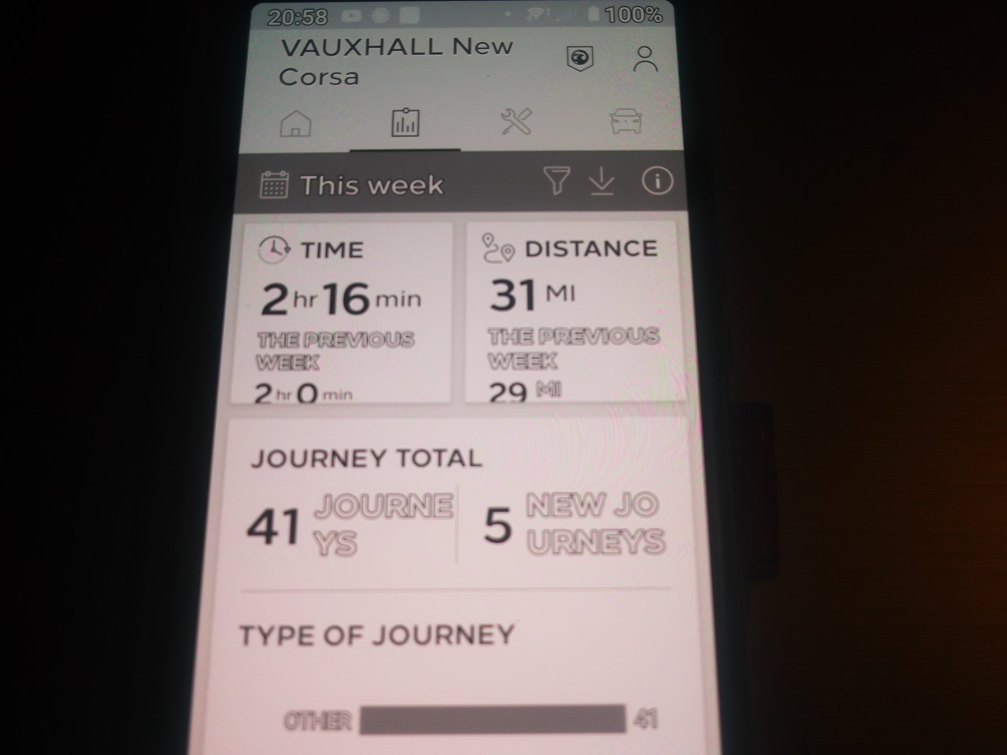

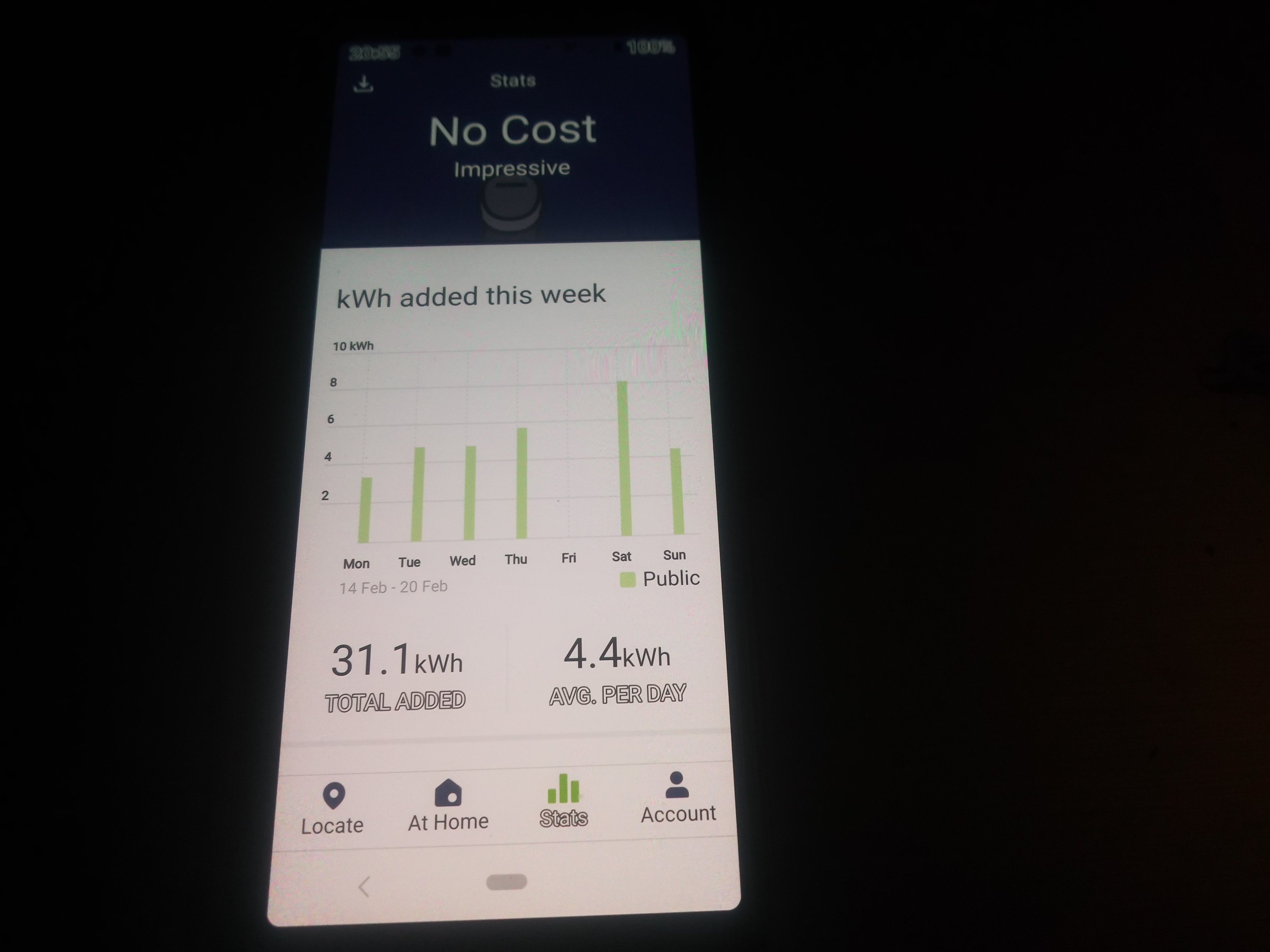

@wyx087  I am not even getting 2.3 miles a kWh at present and that is without an engine under the bonnet.
Again 31kWh of electric used in 7 days to do 31 miles only.
(i could go on a 30 mile run and use only 10 kWh worth.)
