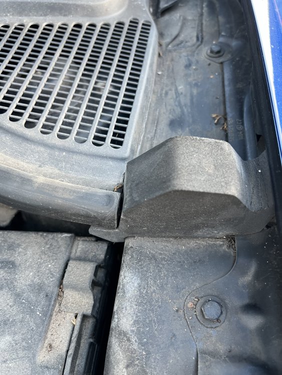

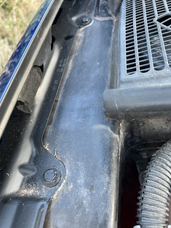

Elderly neighbour pulled out of their drive a few months back, straight into my Yeti. Nothing I could do as she was shooting out on to a single unsealed track towards me, whilst looking the other way to her right. She didn’t know I was there until she hit me! I had slammed on the brakes but she hit the Yeti’s front driver’s side. It was drivable but the washer bottle was scrunched and  leaking so not road-worthy. The accident was deemed her fault by the insurers and off Yeti went to the approved garage. Firstly, the car had to go back for another respray but they never put back a foam pad/buffer they cut off before re-spraying the side panel. It was in the garage for more than a month stripped down (they had covid) and came back a better colour but still no foam pad and an intermittently broken back windscreen wiper. They can’t locate the ‘pad’ anymore, they don't have a part number apparently and they don’t think it’s needed. They don’t think they are responsible for the back windscreen wiper being faulty (it was working fine before).
I need help from you lot with 2 things:

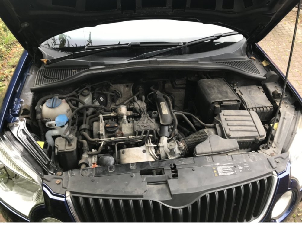

1. I want the foam pad back under the bonnet! I think the bonnet hood isn’t sitting correctly. Also I think there’s more engine fumes going into the cabin from the air vents. Where can I get one and what is it called?
2. What is going on with the back windscreen wiper?!? The spray always works fine but the wiper won’t come on and then randomly starts up! I finished a journey earlier today and tested again and it worked fine. Then tried later and only the spray worked again. Could it be their fault?
It’s a 2010 reg (I was delighted the bumper was still available as it’s got the older round fog light holes) so can’t understand why a bit of foam is a problem. Photos attached of both sides to play spot the difference (the garage couldn’t?!!!)

This photo shows the missing ‘bung’ the first time I got the car back. Can you spot the repaired side? They also painted the inside of the panel blue so whilst doing a re-spray I asked them to change it so it matches the other side, which they did. So that was good. But hopefully you can see why I am linking more fumes through the vents with this part missing. After all it’s job I am presuming is to support the bonnet hood and create a barrier for fumes (the latter I got from googling what their purpose was and something came up on a Ford forum).

Could you not make the part (a mirror image of the nearside) from some high density foam.
Without that part air from engine compartment can enter the cabin via ventilation system.

Having removed the front wing on mine to panelbeat it I recognise the part, I'm pretty sure that it is number 37 on the diagram and not handed, the wing has to be removed to fit a new one as the bulk of the part you see illustrated (badly) is underneath and supports the wing.
You can see the remains of it under the wing where it has been torn off.
