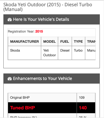

As for a re-map - I have been considering it, local garage are offering a Quantum ECU Remap for £200 + vat - which will take my 109bhp upto 140bhp .... which will be more than enough for me.  I don't tow, so don't need much more.  As for the VAG emissions fix, I don't believe my Yeti requires it - I checked with the local main dealer and also an online checker @ https://skoda-recallactions.skoda-auto.com/en-gb (with VIN) also confirmed it wasn't one of the affected models.
