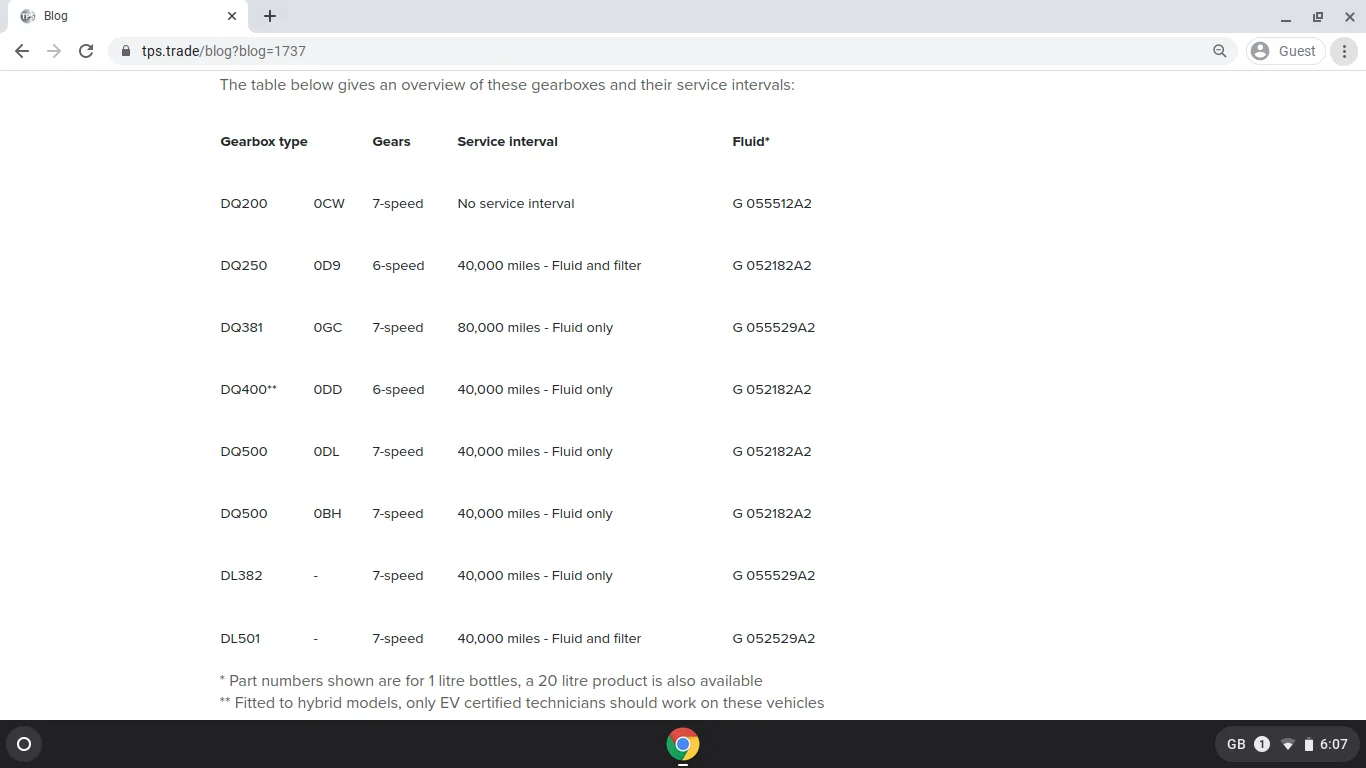

1168293554_37335614_Screenshot2021-09-14at07_38_18(3).webp.ee5b8a609f78b3b2f42441d7532010fa.webp.03b06c85571b53b664b7942fca3ad3bc.webp

 I could have been clearer about my question  - I've been trying to fugure out which gearbox I have which would have allowed me to figure out when the interval is from all the excellent threads on this site  & thanks @roottootfor posting the detailed table. No confusion about what to do once I know which type of DSG is fitted.  Question was never about Haldex, but all noted & seems a common thread on here, as with DSG's. Thanks @Schtumappreciate your post.
Found a gearbox code on an invoice & am certain mine is the DQ381 which matches others experience & advice on the 2.0 TDi 4x4 (invoice code is SWT - https://www.proxyparts.com/car-parts-stock/information/gearbox-code/swt/part/gearbox/partid/10426766/) so looking to be an 80 000 mile service interval, which is what one dealer told me.

So is the wet clutch dsg version now on a 80k interval instead of prior 40k, or is this a decision that a dry clutch gearbox actually needs an oil change at 80k rather than never needing one as was the case with petrol Yeti dsg’s?
I believe my 190 tdi has a wet clutch gearbox, as I would not knowingly buy a dry clutch version with the certainty of eventual clutch replacement.
Certain Wet clutch DSG.  So you need to know which you have.      ........  Nothing to do with DQ200 DSG 7 speed twin dry clutch DSG,s.  The OP does not have one. There is no change with them. There is no service schedule, guidelines or recommendations from VW Group for changing oil in them.  Regardless of what someone at a dealership says.  If they do say there is ask them to show the paperwork / TPI from Skoda.    As to eventual replacement of clutches.  Plenty 2009 / 2010 DQ200, have not yet required replacement clutches and Skoda were building more than 2,500 DQ200 a day for the VW Group.   PS.  Service campaign 34F7 called in 2014 in Europe on 2009-2012 DQ200,s was when VW group paid to replaced synthetic oil for mineral.  There are 2 oils in a DQ200. In the box and in the MCU.
