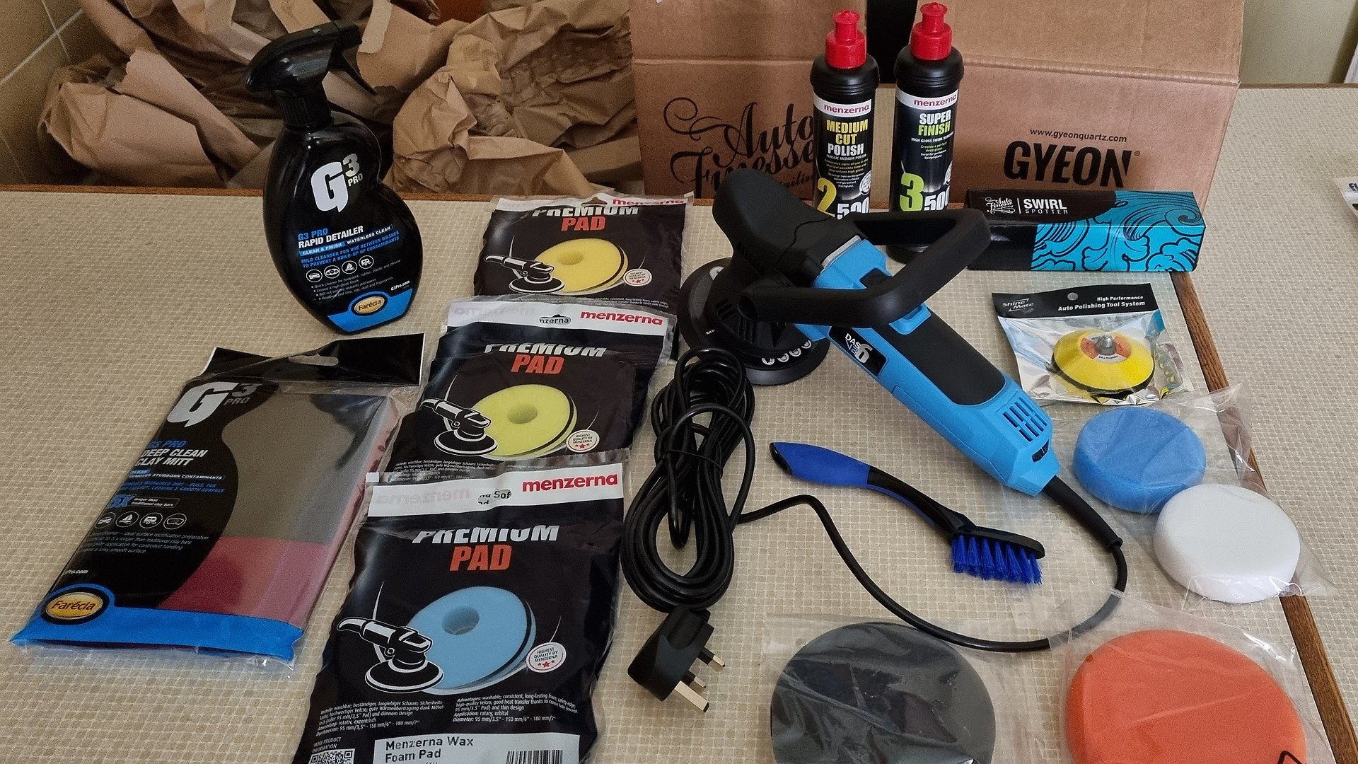

Well all the bits that make up my "beginners polishing kit" have arrived, just got to wait for a good time and the nerve to tackle the job now 😄
