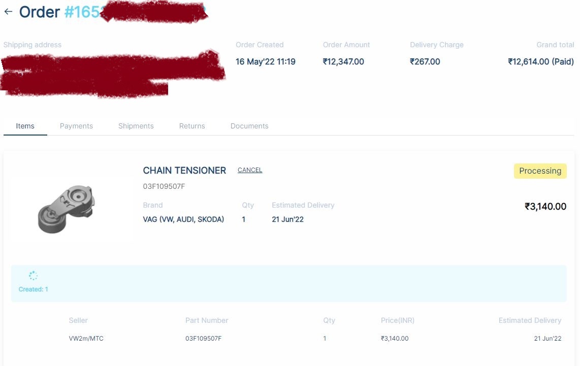

I have ordered the chain tensioner with the part number 03F109507F on the16th of May, but unfortunately it has not reached me yet. I'm guessing the part needs to be flown in from Europe that's why the delay.
I have already received my water pump, rear shock absorbers and rear shock stop buffers - only the tensioner needs to arrive for the work to start.
I'll surely post the results here once I install it.

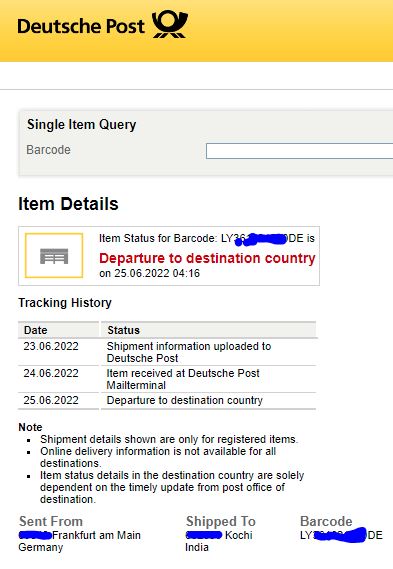

The item has been shipped to me from Germany through Deutsche Post - last status update was on 25th June
I remember many years ago getting an item from Deutsche Post (DHL Paket International) and I remember it being quite slow to arrive - so I'm guessing this package too will take a lot of time to reach me.
Will surely post an update here once I receive it
