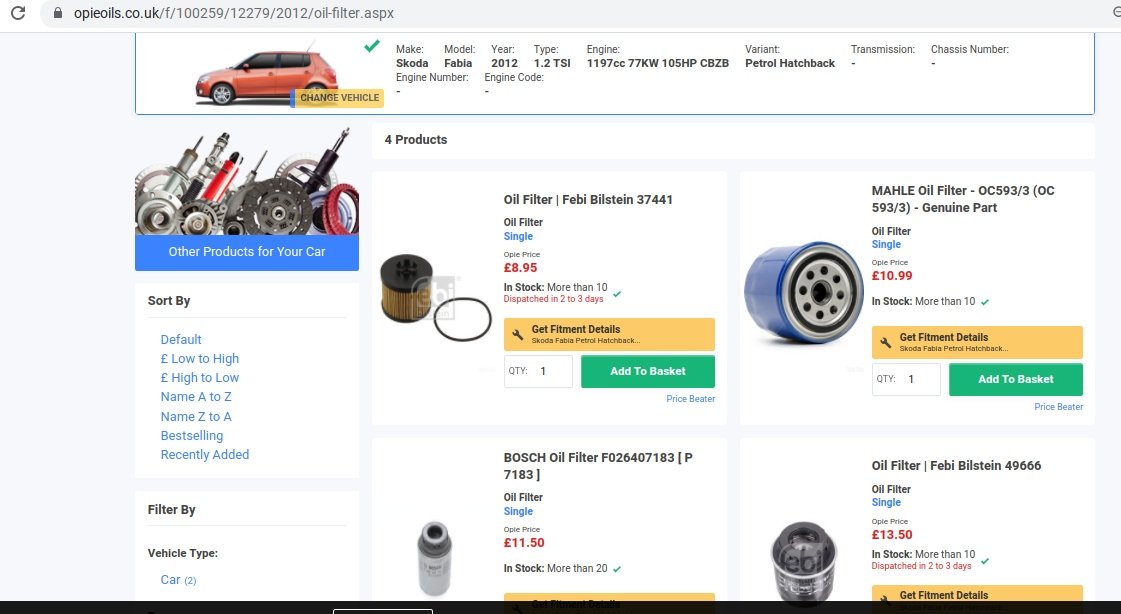

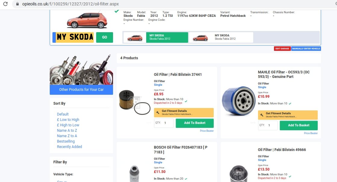

You need to get the correct Oil filter using the VIN.
The Euro 5 1.2 TSI engines had a change of oil filter and there was a time that Dealerships / Garages fitted the wrong ones, so engine age is important.
Also the Oil capacity changed from 3.6 to 3.9 litres as shown here for Skoda Fabias.
