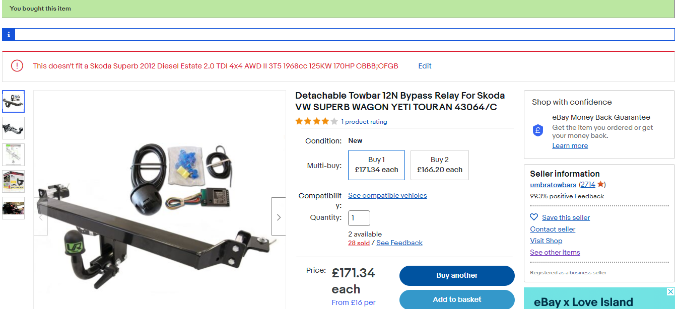

This the Ebay listing I bought the tow bar (generic tow bar photo) which now says it doesn't fit AWD or FWD ? I do remember messaging the seller and asking if it would fit my car and they confirmed it would.
Do the fixings of your towbar resemble those in the first or 3rd picture in the listing?
That is to say does it have plates that slide into the chassis rails and which are bolted laterally through very large holes (picture 3) or does it perhaps bolt onto the crash bar fixings (picture 1)?
My towbar gets a real lot of abuse and I have found the chassis rail fixing method on the Yeti and my 2 previous Octavias would become loose due to the clearance around the fixing bolts, the only way to mitigate it was to overtighten the fixings to death dishing the washers so that they deformed into the void between the bolt diameter and the clearance hole.
JR my tow bar resembles the 3rd photo. you remove the crash bar and and slide mounting arms down inside the chassis rail as you describe. It's had an easy life so far I've not done much towing with it. Biggest thing I've towed is a 6x4 single axle plant trailer  .

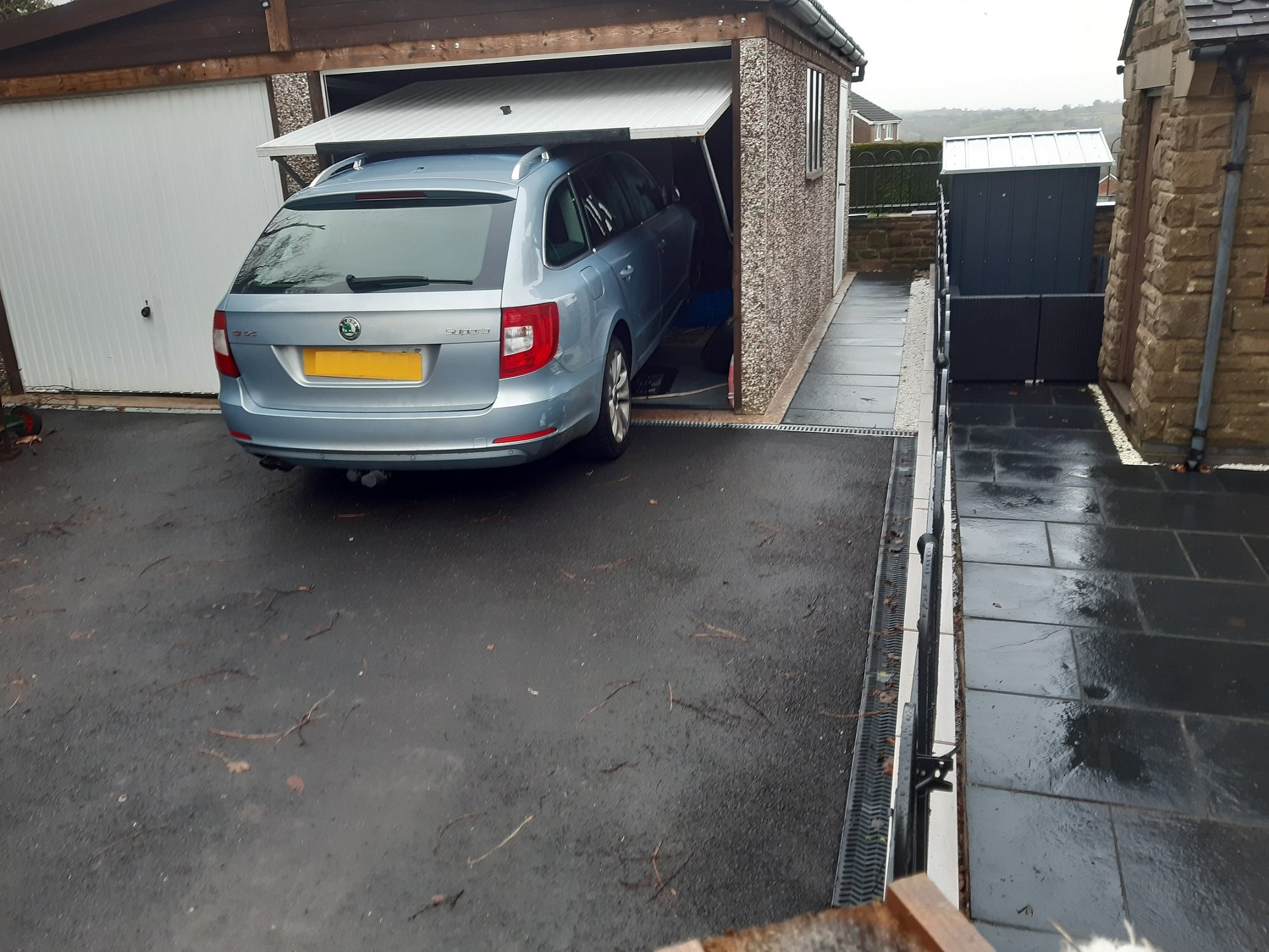

Some photos of my Tow Trust bar:
Nothing to see unless you get really low down:
Plug socket dropped down:545889938_towbar2.thumb.jpg.c6aa67238c4b7136c95b4a5927d30b4a.jpg
Swan neck in:383692620_towbar3.thumb.jpg.d4fa2c1fc442d8700fb9f1ab27d086bf.jpg
