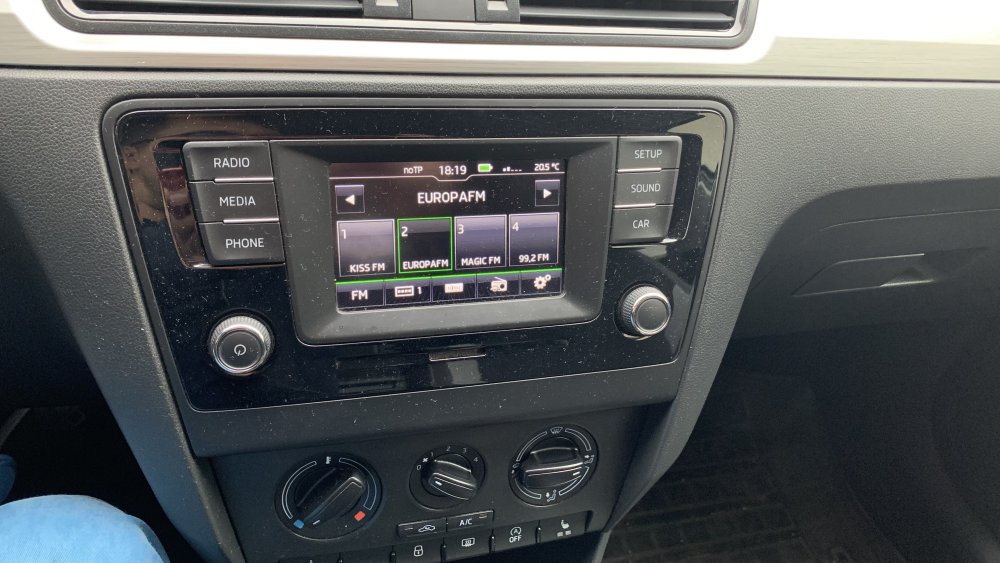

I have bought a skoda rapid from 2016 with the swing multimedia and i have a question if someone could help me!
There is no apple carplay on this model but on the apple website it's saying that it is supported from the beginning of 2016.

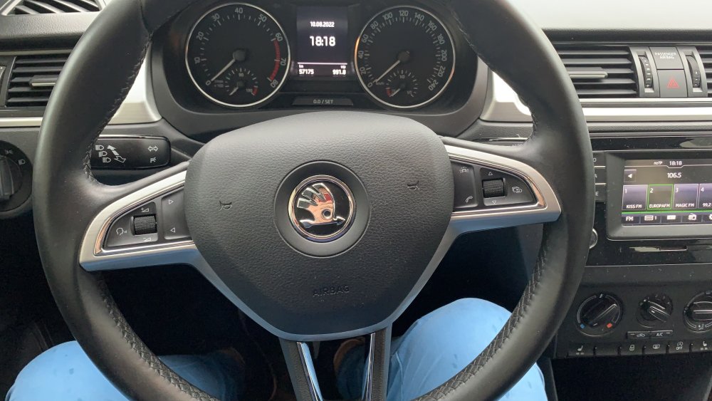

Also on the steering wheel there is a voice recognition button that when pressing its saying "voice recognition unsupported"

There are 2 types of swing on rapid. 1 is without ability to unlock smartlink and there is “sound” button and 2nd variant is the one with “app” button and you can unlock smartlink on that unit

The swing that I have does not have an app button. On the steering wheel I have voice control button but when I press it it’s says on the display: voice control unsupported. And I have another button that says the same. I have talked to Skoda and they say that activating all features will cost me 300 euros. My question is where can I find this type of software whiteout paying or paying but not this amount of money.
Thanks.

Well idk why they said that because the before lift swing you could only unlock not many features and all the features can be unlocked using coding. The lift swing is different story because you can unlock there smartlink which requires swap code

If the voice control isn't working it does sound like a coding issue, maybe this unit replaced an older one and was not coded correctly (or the MFSW was added after)?
