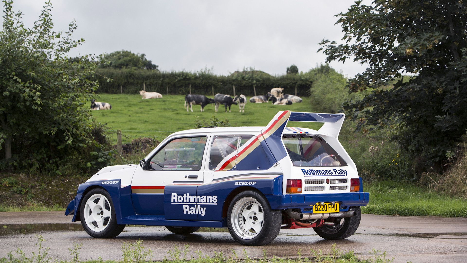

It is always fun and interesting to discover how the engineers overcame the challenges of their time with unique designs which are forgotten now.

True, but that's a (non-turbo) Metro 6R4, not an MG Metro turbo, which was a fairly normal FWD Metro other than the unusual turbocharging arrangement.
