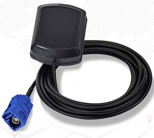

I recently had the RNS510 fitted into my Fabia 1.2 TSi elegance and it came with a GPS module similar the the one below, we took out the indash glovebox & secured the GPS to the metal bar that secures the dashboard etc (bulkhead bar?) using the magnetic back & fed the cable through to the radio area... instantly we had a good signal & NAV reported our location correctly. all stations work nicely although im sure there is a setting for HDaudio somewhere in the settings that will bring clarity to radio stations.
FYi the price of the unit can vary but as long as it says it fits & has a blue connector like pictured im sure you'll be fine.

The link to the antenna above will work fine, thats what skoda supply with the RNS315 aftermarket kit, and as mentioned put it inside the dash and all is good for GPS.
