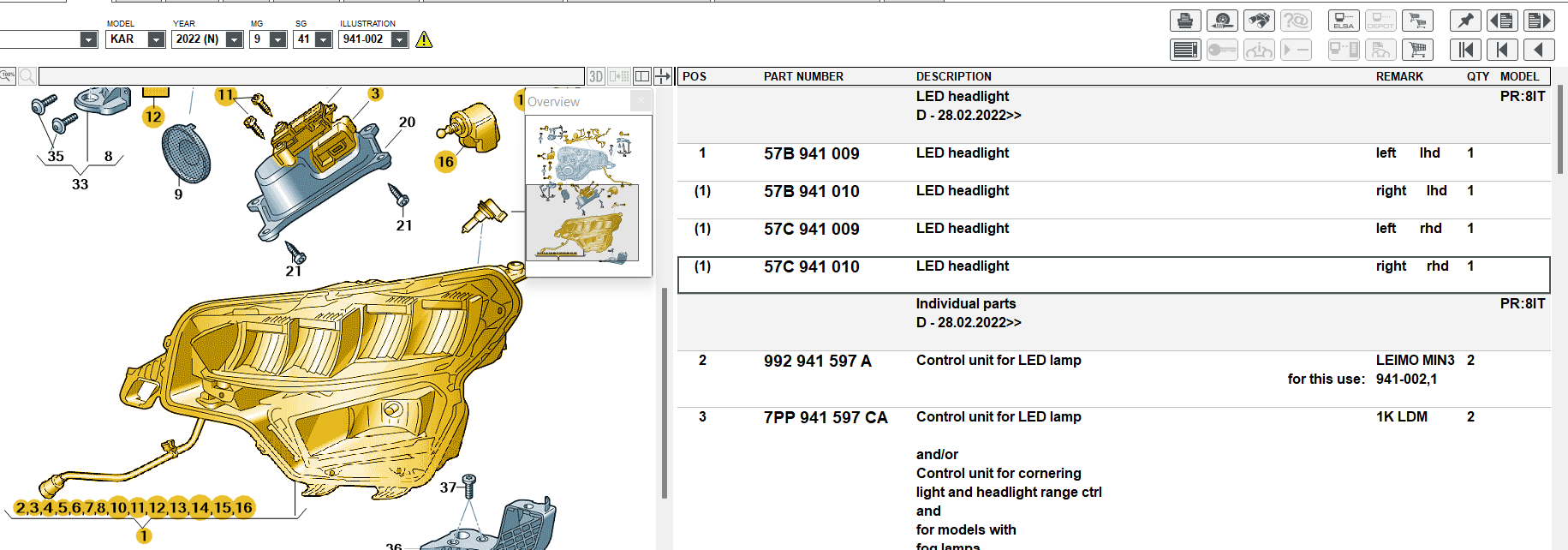

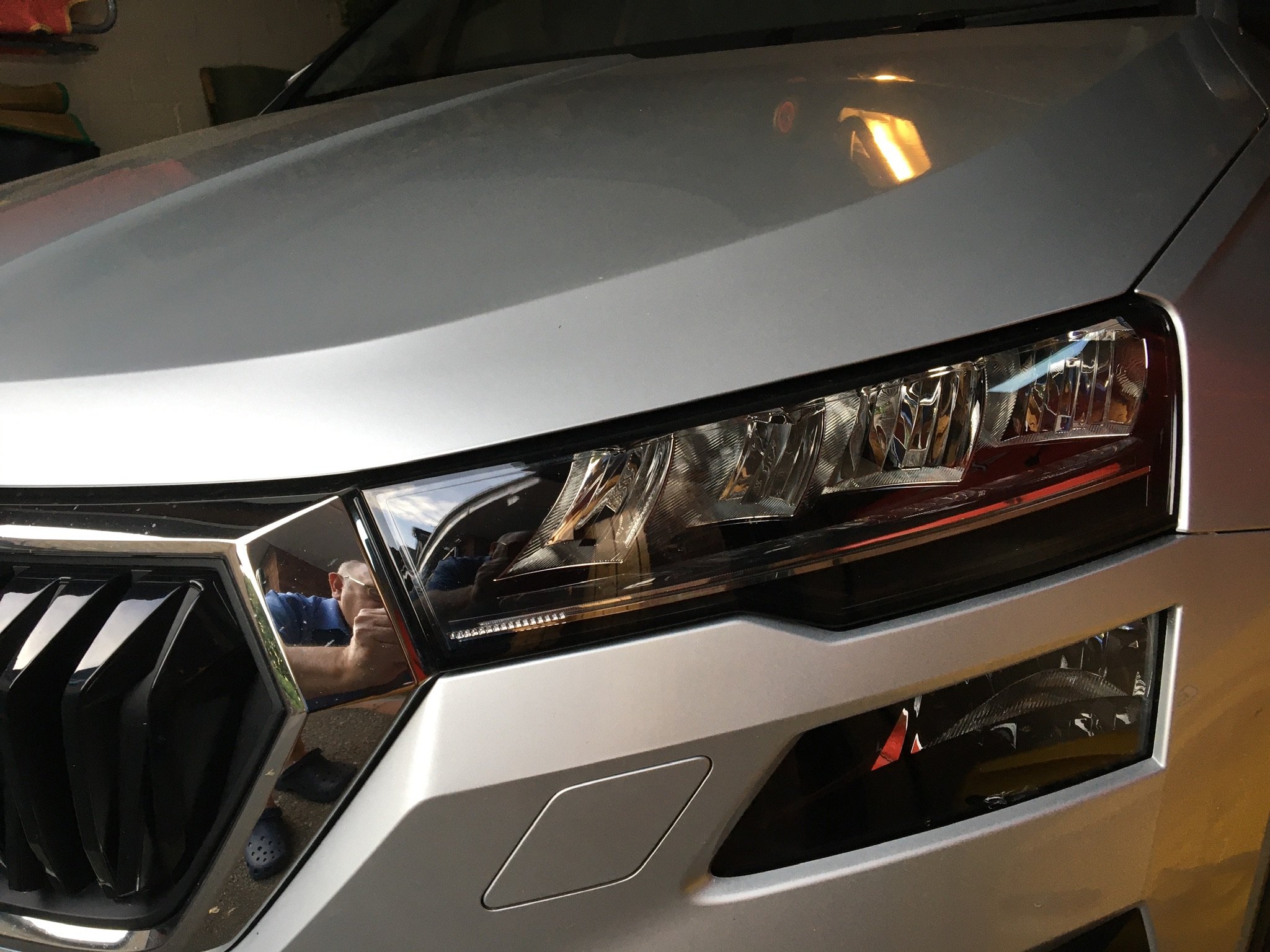

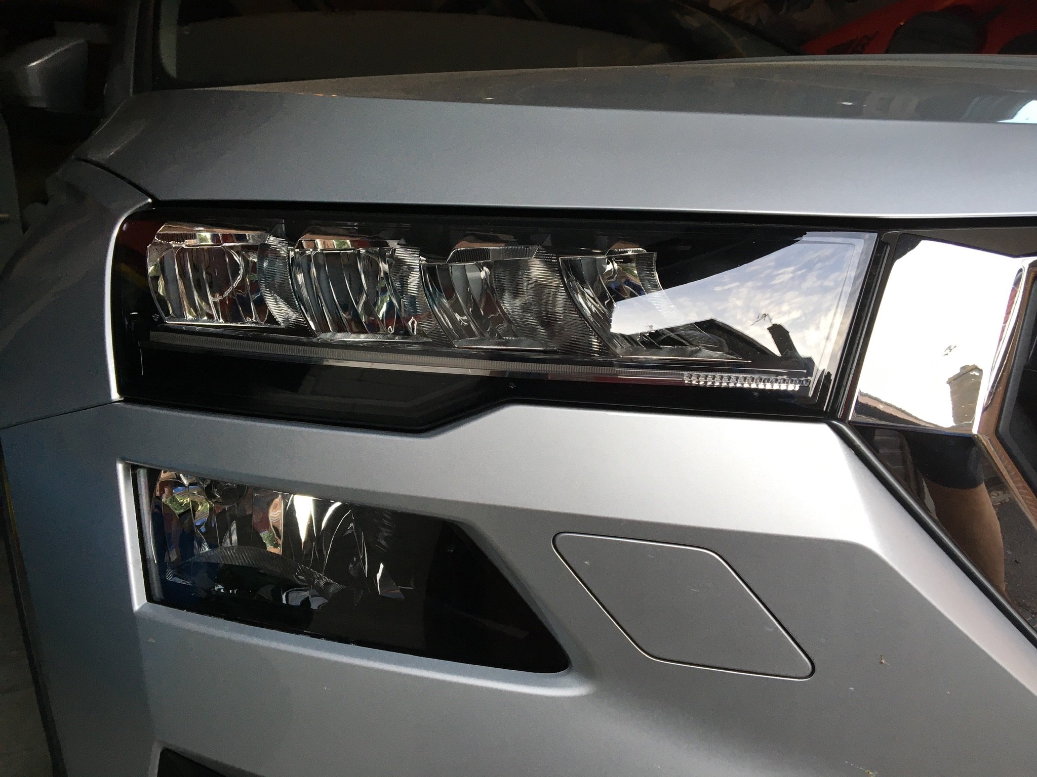

To my eyes, and parts pictures, it appears you have LED style.
Best to either take a picture of the rear of the lamp, or some actual beam shot images as we get darker.

Halogen bulbs when turned off will "dim down" and LED's the light goes off instantly.
Back of the headlamps will be different too.
Dealer should be able to look up your VIN, and if friendly enough could print out what's been fitted at factory.

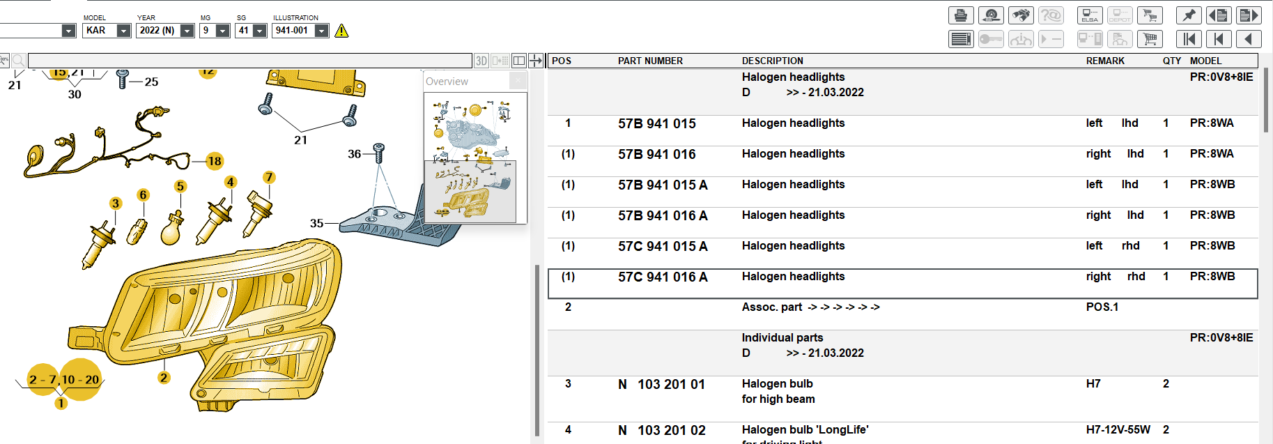

From the April 2022 brochure I think that the SE Drive and SE L trims have halogen headlights as standard (with the SE L having LED running lights).
The LED Matrix lights are standard on the Sportline and optional for the SE L (the 'ordinary' LED headlights fitted as standard or optionally to pre-facelift cars don't seem to be offered any more.)

Travel mode is missing from his menu's.
Still helpful picture for anyone else that needs it.
