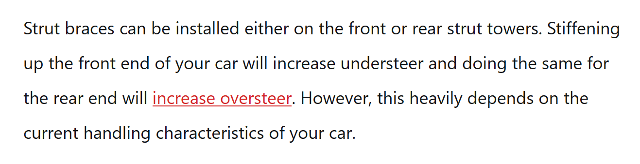

I really wish I knew enough to argue my gut feeling on this, but I don't so I'll shut up and have a Google and see what I can find out.
EDIT: Ah-ha! https://low-offset.com/workshop/strut-bars-explained/
Well well well! I did not expect that.
That said, there's a mix of opinions elsewhere on whether they increase  or  reduce oversteer, so I'm no more sure of the truth of the matter. 😄

41 minutes ago, Titanium_Man said:
I believe the front strut brace will reduce the flex by fixing the top of the struts together, thus keeping the car flatter during the turn and therefore reducing the outer wheel digging in, resulting in the car sliding straighter rather than turning
Edit in italic. Similarly a rear strut brace will increase oversteer by keeping the rear end flatter.
I'm unsure whether both will increase grip or just result in a more sudden breakaway.
It all seems instinctively wrong to me.
I remember when convertibles handled substantially worse due to the body flexing, and so they had to be stiffened up considerably to improve handling (with an associated weight penalty.)
Now too much stiffness is bad?
I'm still uncomfortable with this.
As I see it, and this is my perception/opinion, so please do disagree and set me straight where I'm wrong:
Strut braces = Greater rigidity and thus consistent body geometry for the suspension to work off, an unequivocally good thing and a plug and play improvement. No trade-off, apart from increased weight. EDIT: Note, making the front of the car very stiff while allowing the rear to flex, or vice versa, probably not a good thing unless you know what you're doing.
Roll-bars = Reduce roll, may cause wheel lift and thus reduce grip. Require careful choice, but basically plug and play if you know what you want. (With suspension alignment afterwards, if required.) Can involve a trade-off between desirable handling characteristics, undesirable handling characteristics and comfort.
Stiffer Bushes = Reduce "play in bushes, may cause harshness and reduce comfort. Require careful choice, but basically plug and play if you know what you want. (With suspension alignment afterwards, if required.) Can involve a trade-off between handling and comfort, but handling almost always improved.
Springs and shocks = Adjust ride height, comfort, and handling of care. Require careful choice and set-up, and almost always involve a trade-off between handling and comfort.
(Please note the word "handling" is doing a lot of heavy lifting in the above sentences, including grip, roll, understeer/oversteer, whatever.)
