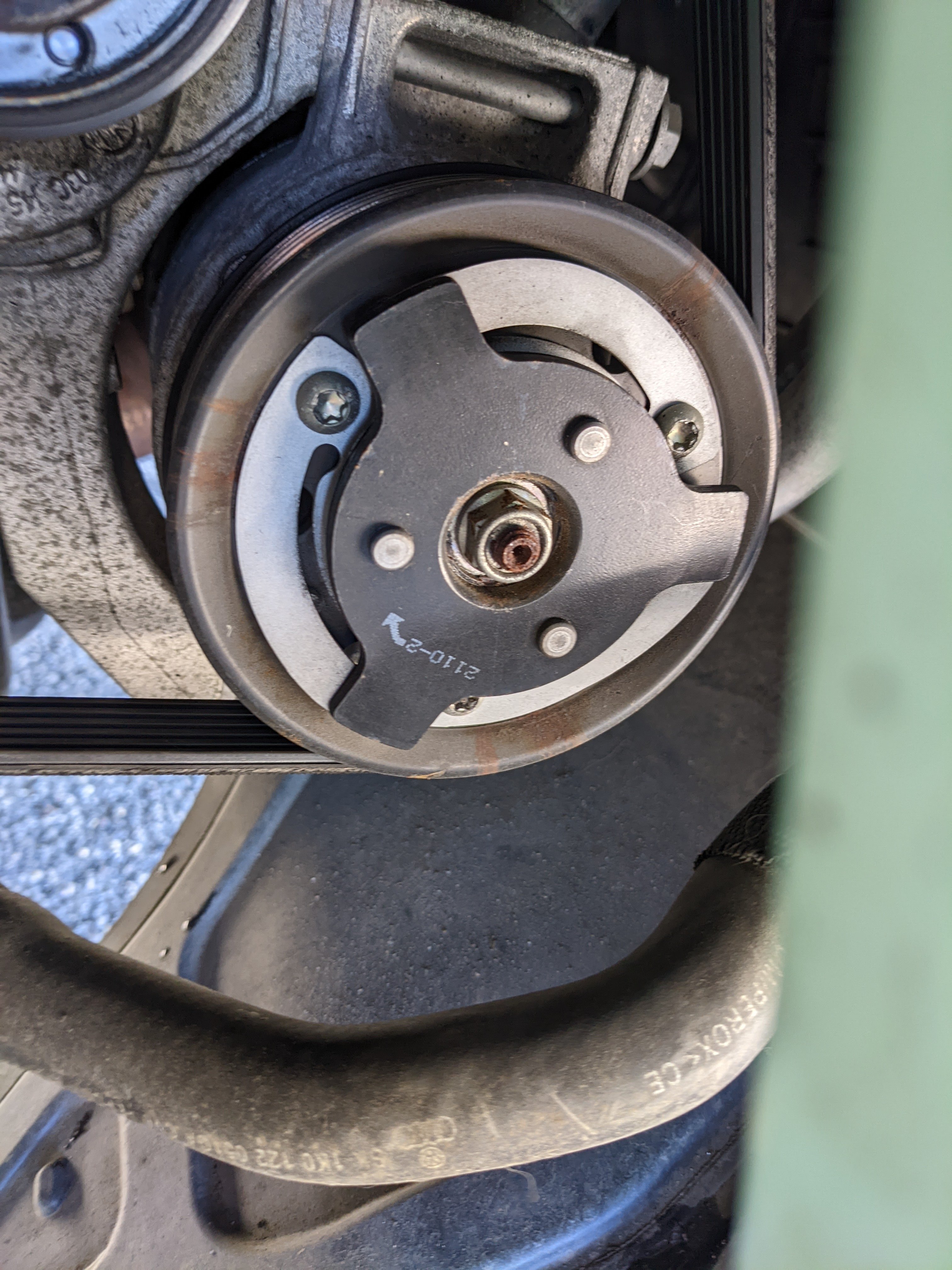

Have you checked the 3 Torx screws that hold shear plate to pulley?
I haven't, but just took this and they don't look loose.
