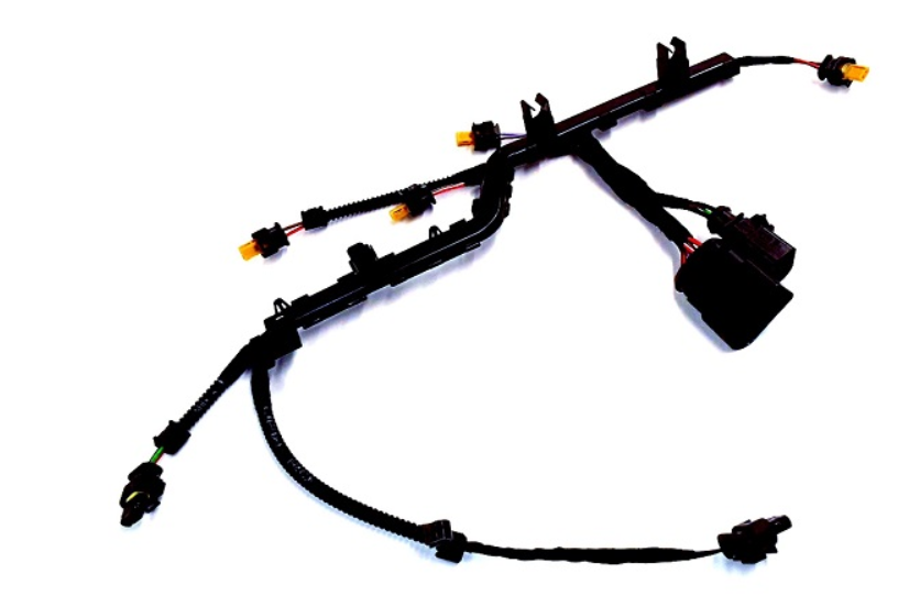

Well here is an example loom, take a look and see if you think you can deal with a few plugs 🤔
Shouldn't be too technical to fit, cost is around £100+

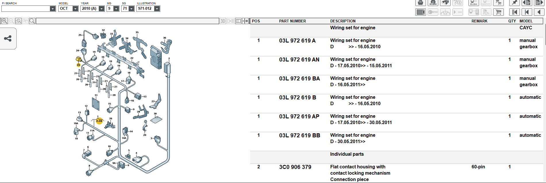

Looks to be CAYC
2 hours ago, octaviaguy2519 said:
Looks to be CAYC
Not good news I'm afraid.
CAYC does not have a mini loom option for just the injector set like a different engine code above.
You are looking at £400-600 depending on which gearbox you have and when exactly your car was made.
And fitting such a large loom will not be an easy task.
If you are still going with DIY choice, then get a multimeter to start probing.
