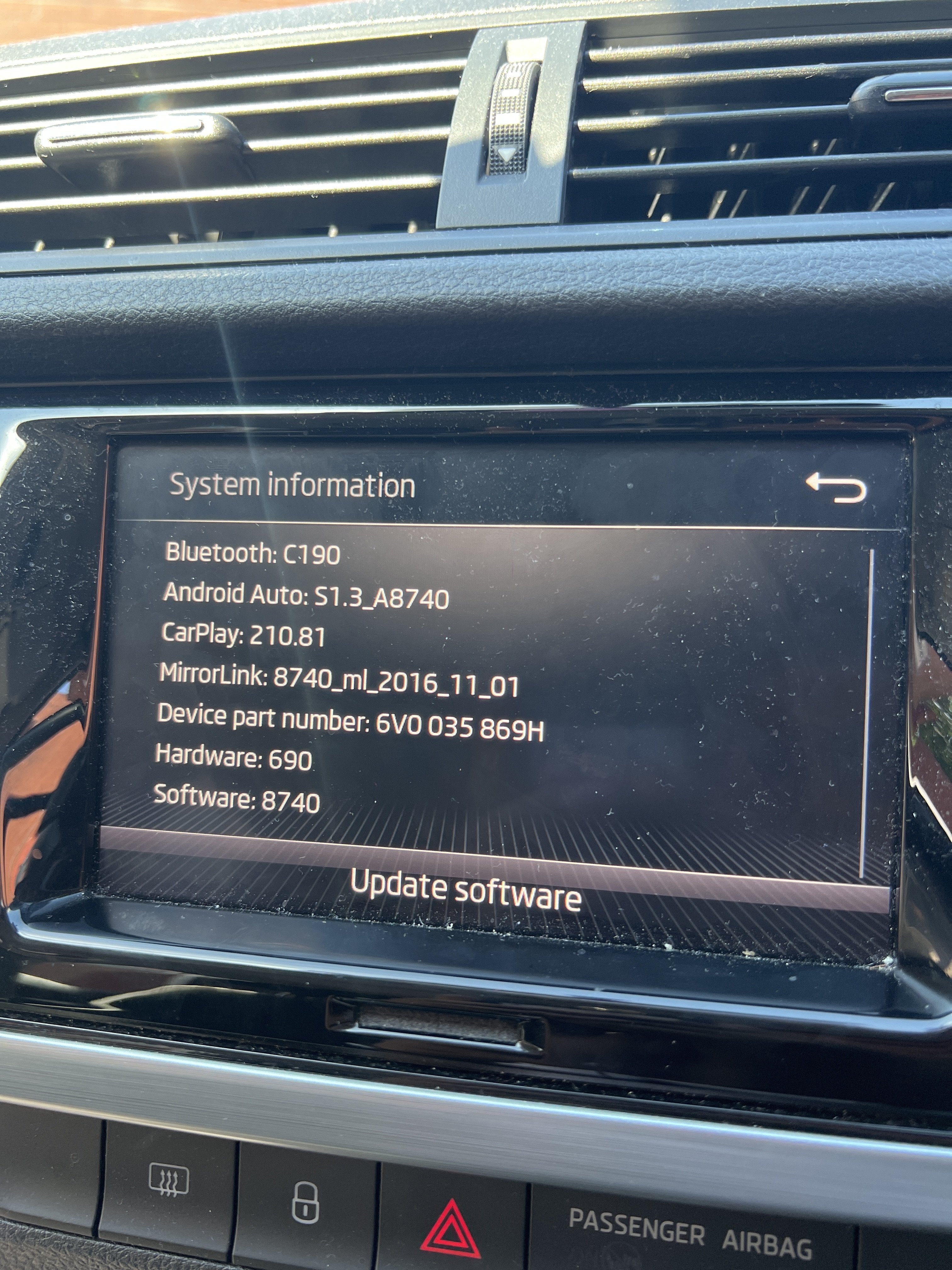

Hello, I have a 2019 fabia SE and my apple carplay has issues where it has static and music jumps all the time.
Does anyone know how to update the system? It's going into skoda tomorrow but might be worth a go
I have heard of this issue reported by someone for their apple doing this, can you get your version information up and report back?
Hold down Menu key usually a few seconds, you are looking for Software Train, I can at least verifiy if there's an update for software probably.

You have MU 8740 version, exists MU 8755
You have two choices: 1. Visit Skoda tomorrow, and pay for update (if they even apply fix!)  2. I can send file over and you apply yourself at your own choice and fix = free potentially.

I am seeing software 8740 though in system info
If you scroll up, you will see image of the Software Train.

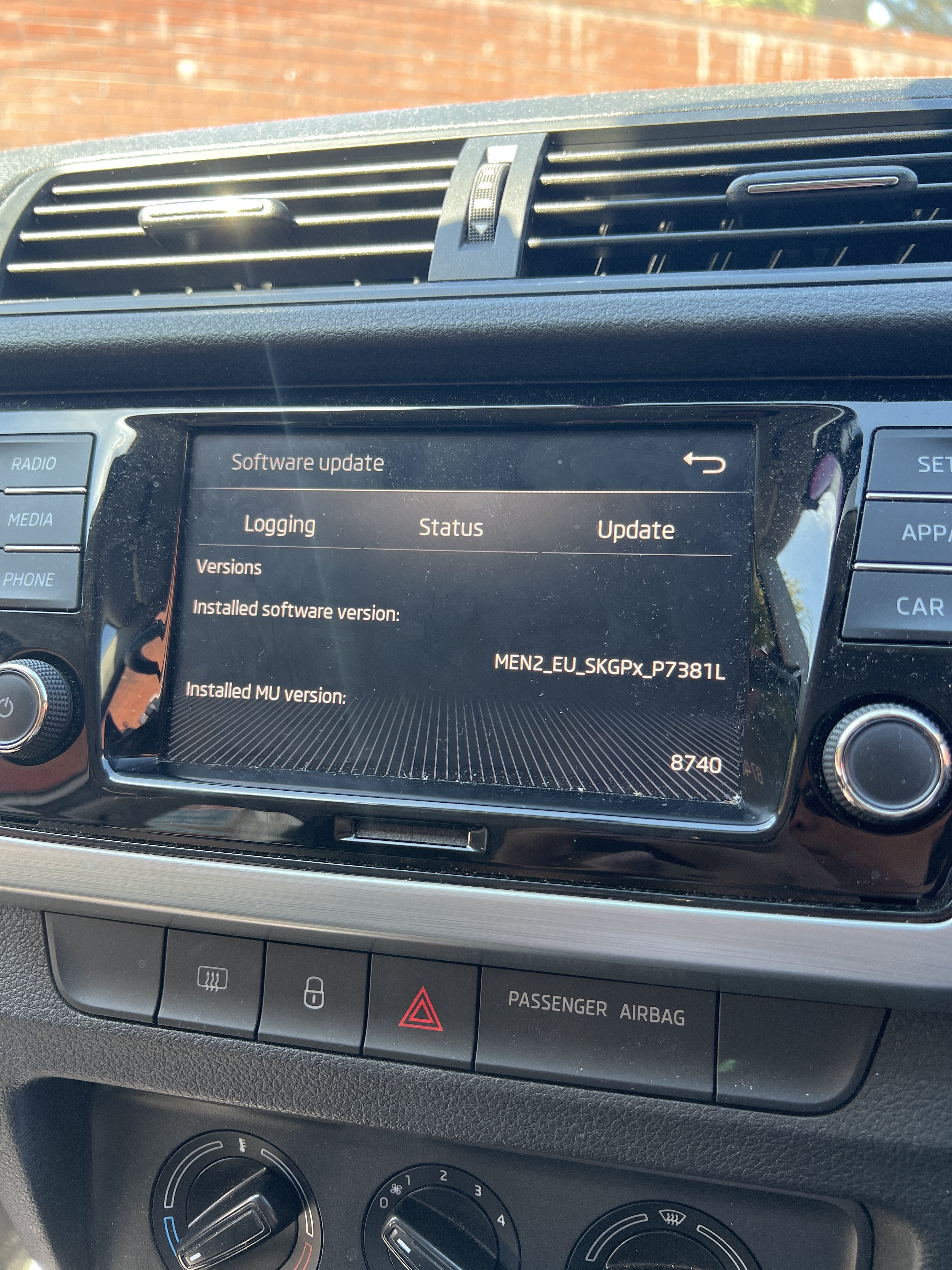

Hi Hopefully someone can help me with this too! Fabia has recently started to do the exact same issue so I was wondering if anyone could point me to the correct firmware update. Im not sure why they are not just released by Skoda to be honest!
Currently on:
Carplay: 210.82
Hardware: 690
Software (MU Version): 8740
Installed  Software Version: MEN2_EU_SKGPx_P7381L
