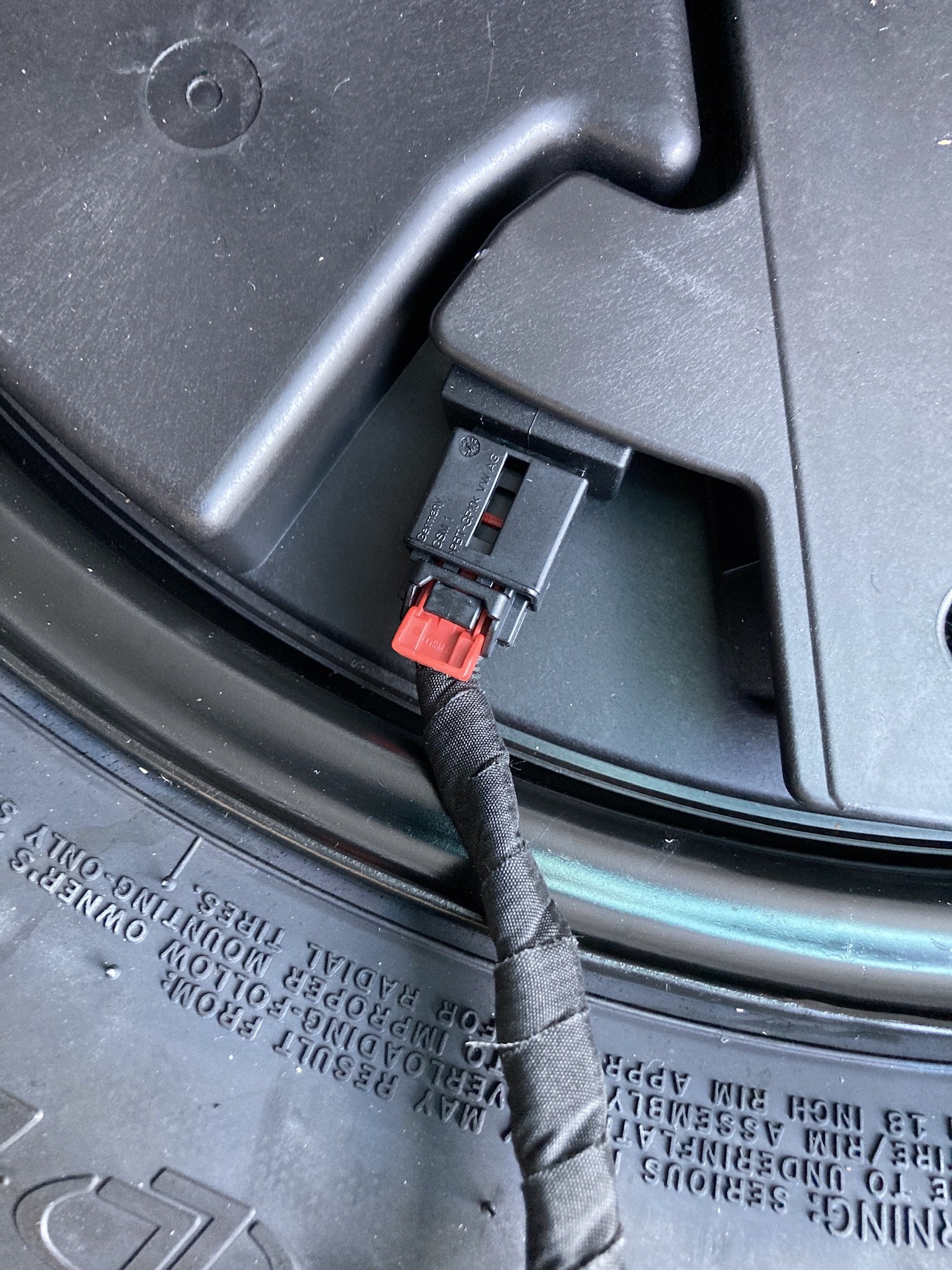

How do you disconnect the electrical connector to the sub-woofer speaker located inside the spare wheel? I've read the instruction manual. The instructions and diagram are unclear. Can someone tell me just what to do please! I'm afraid of using too much force and breaking it.  Thanks.

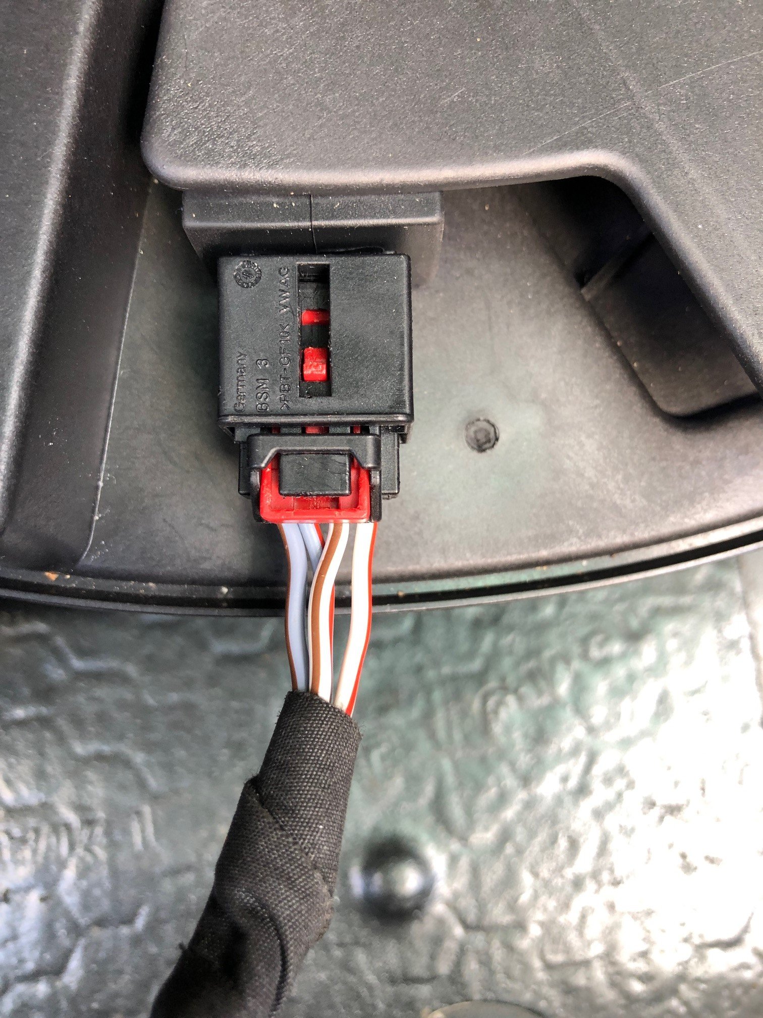

Haven’t tried it , but it looks like you pull out the red locking catch, then push down on the central black button and pull out connector.

Thanks. But you will see that the illustration in the manual shows a different connector to mine. I have tried what you say, and it doesn't come out *easily*. I don't want to force it. I'd like to hear from someone who has the same connector as mine, and has successfully disengaged it !
Thanks again.

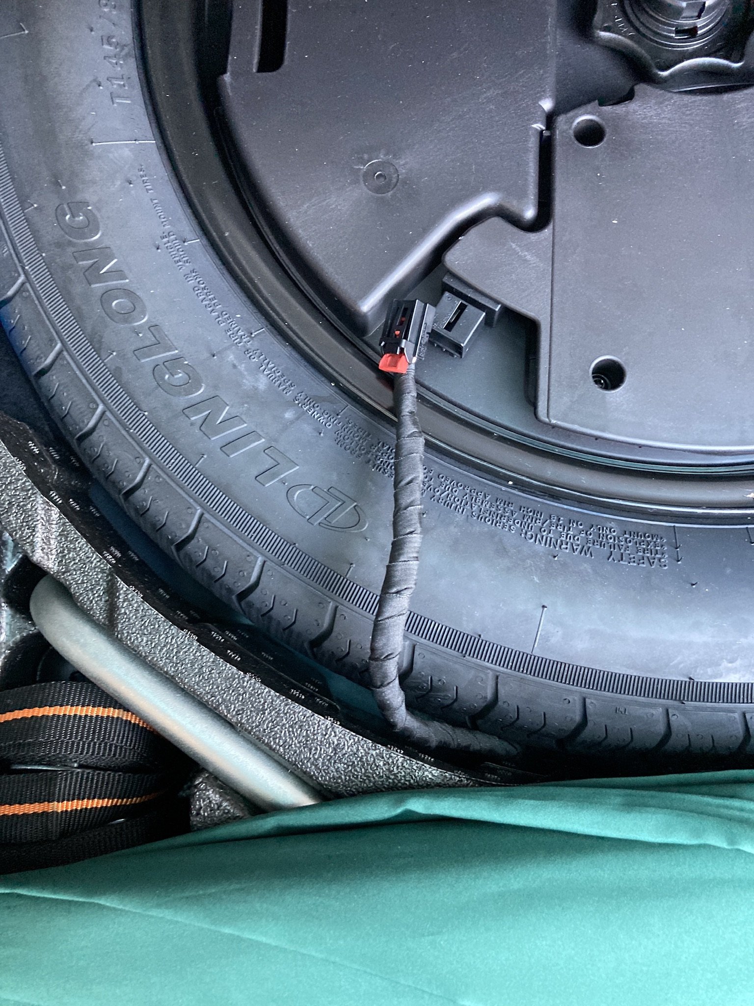

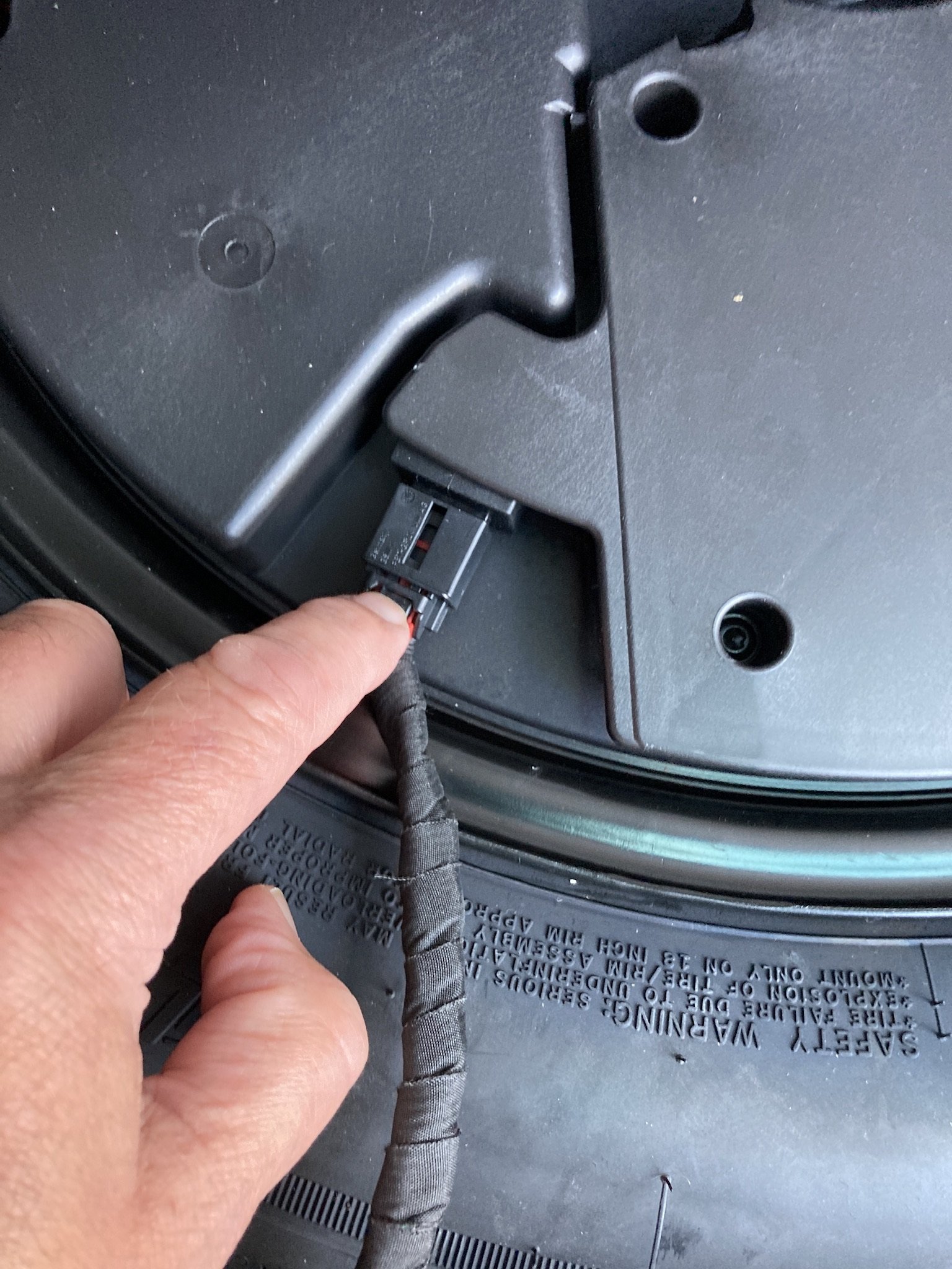

Just been out and tried mine and it is exactly as described. Pull out red locking tab, push central button and pull out connector.
That's great. Thanks Kenny. It seems that I wasn't pulling out the red tab enough. I can't check it now as I've just loaded up the boot for tomorrow!
