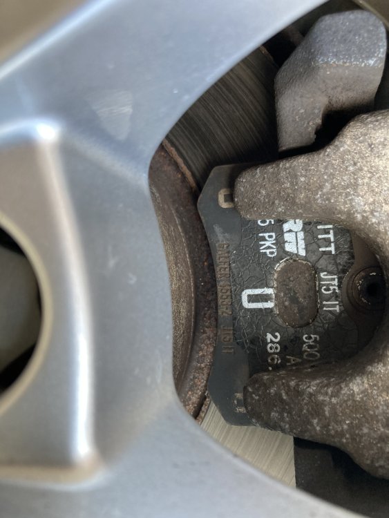

Wow. I wasn’t expecting such a comprehensive reply. Thank you! The trouble I now have is determining the build code. Any easy way of finding this out? Picture of what’s on it at the moment. Could have been changed from oem before my ownership as the cars on £60k miles with very little lip on the disks.

From your photo it looks like you have 253x10mm rear brake discs because of the shape of the brake pads.
