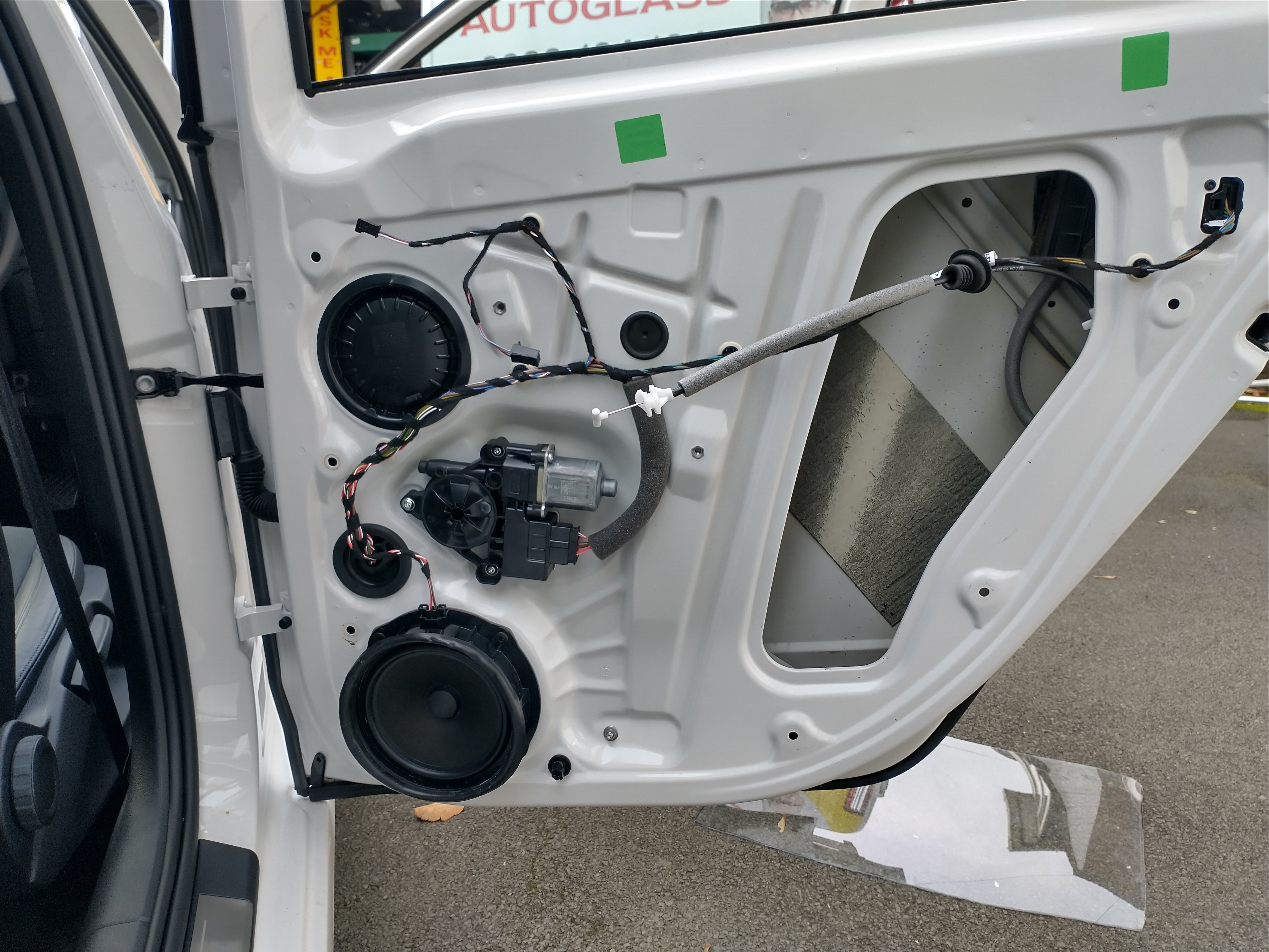

The window seals come in two parts (not 3, IIRC) and one includes the small pane of glass at the rear of the door. It's worth noting that there are metal inserts in the door glass rubber seals which can easily be damaged, so they require handling with a little care as they can be deformed or broken pretty easily if you're rough with them. Also worth noting is that the interlocking of the window seals is a bit complicated where they meet with each other, and the Autoglass tech (a master tech, no less) didn't interlock them properly, but it was easy enough to sort that out by comparing them with the other side. (Which is how I noticed they weren't fitted correctly in the first place.)

If anyone's interested, here is a pic of what lies behind the door card of the rear door on my MK3 Octavia.
