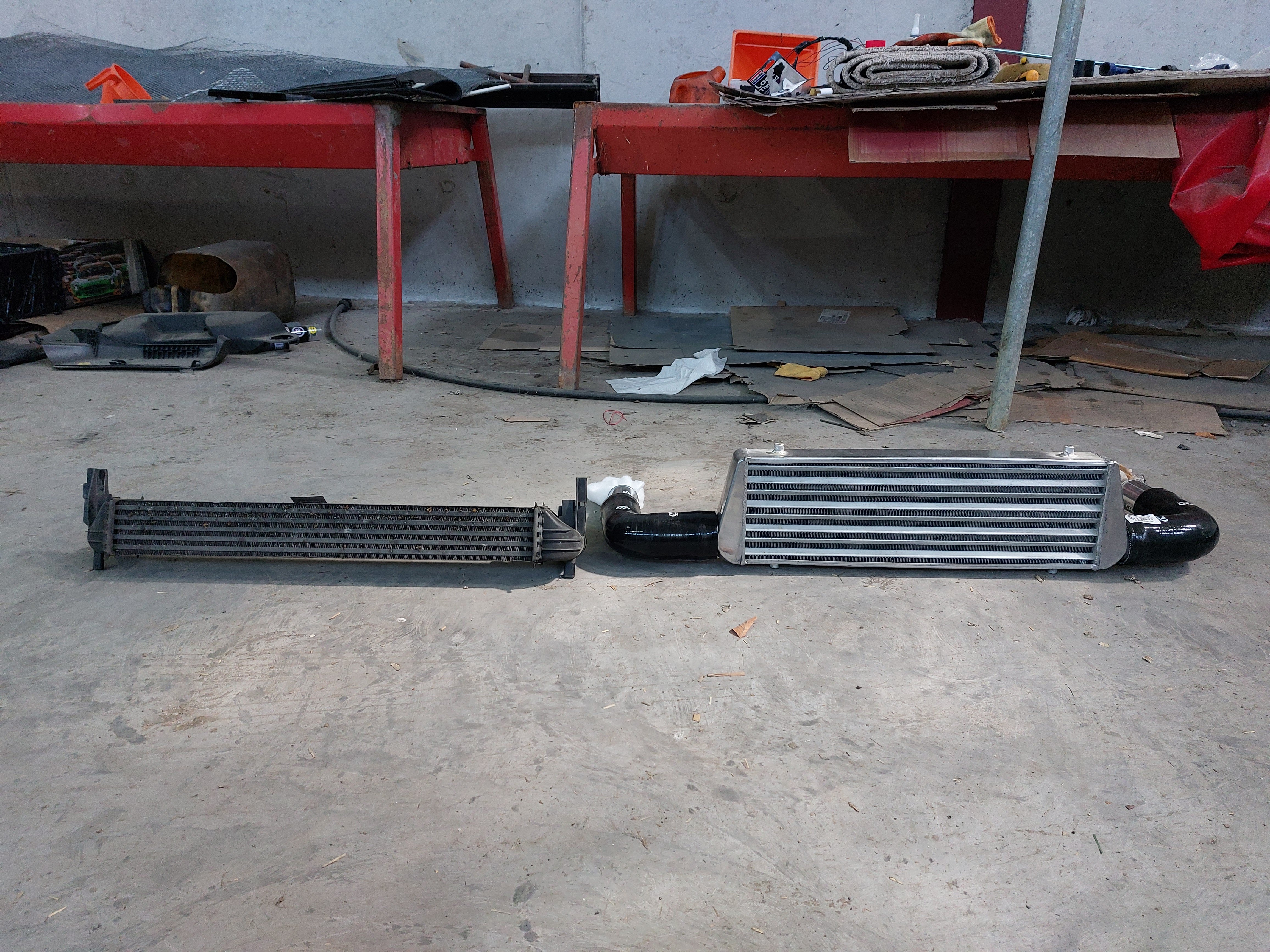

I got a cheap universal intercooler on my monte which has the same intercooler standard.
The intercooler I got is slightly narrower than the standard unit. But a lot taller.
I mounted it as close to the bumper as I could to maximise airflow through it, the standard ones shrouded a fair bit.
I used 2 90° 2.5" to 2.25" reducer pipes either side with 2.25" joiners to connect to the old boost pipes.

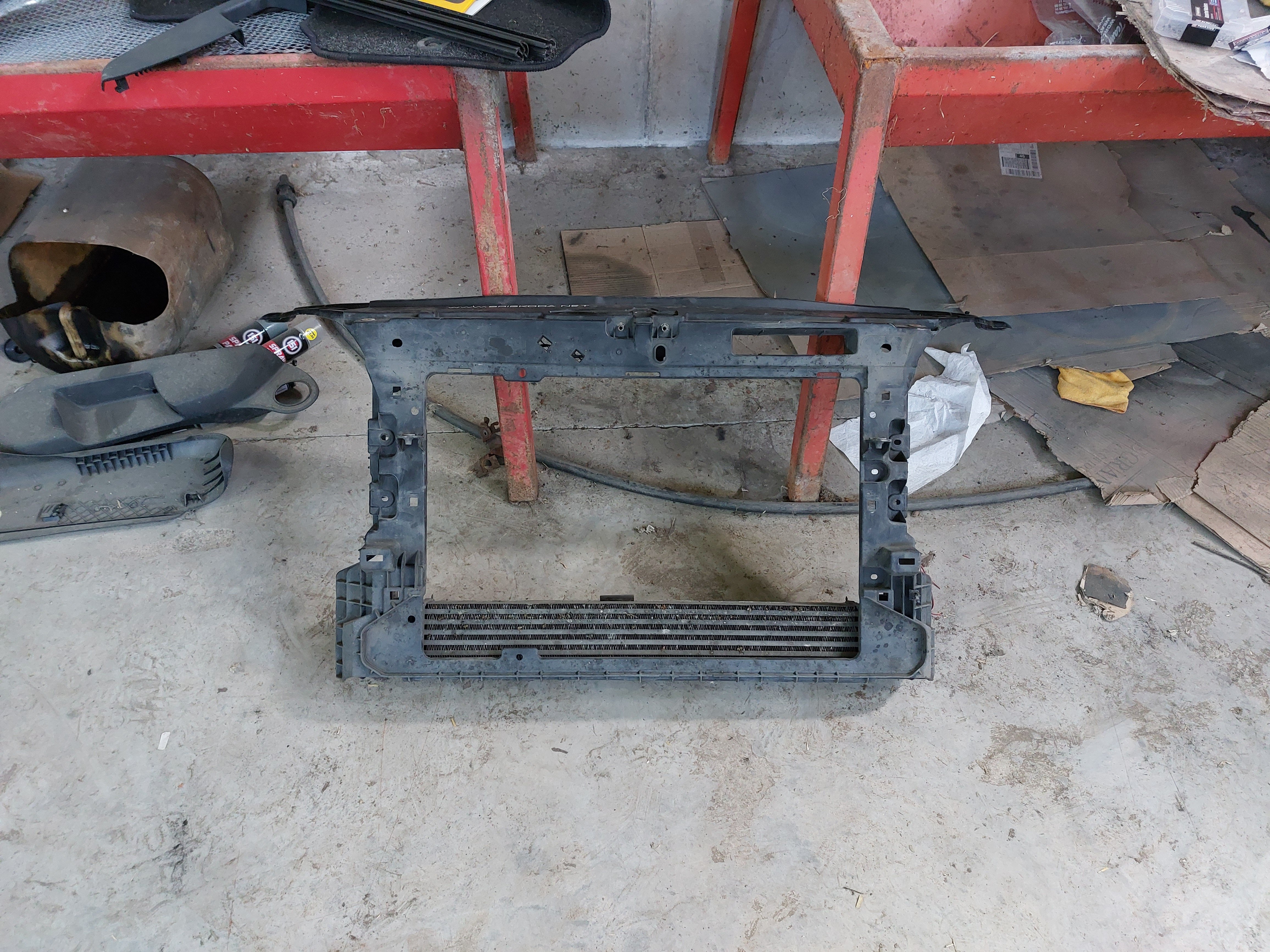

Here's how the stock intercooler sits on the car.
Quite far back crammed in with the radiator and condensor.

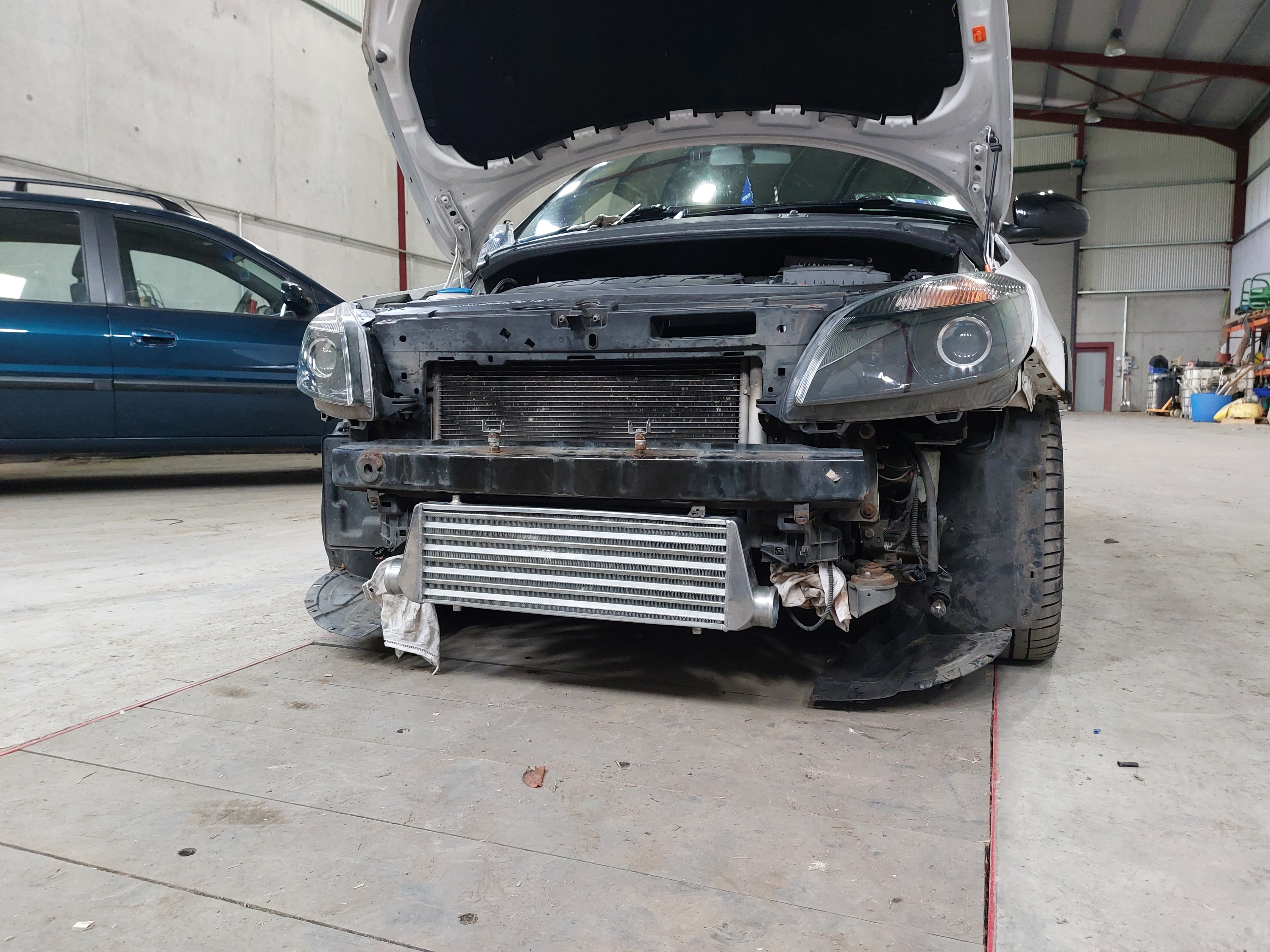

20220625_143706.thumb.jpg.821a0a16a63878d3709082cbd756c987.jpgPic of the New intercooler in its rough position.

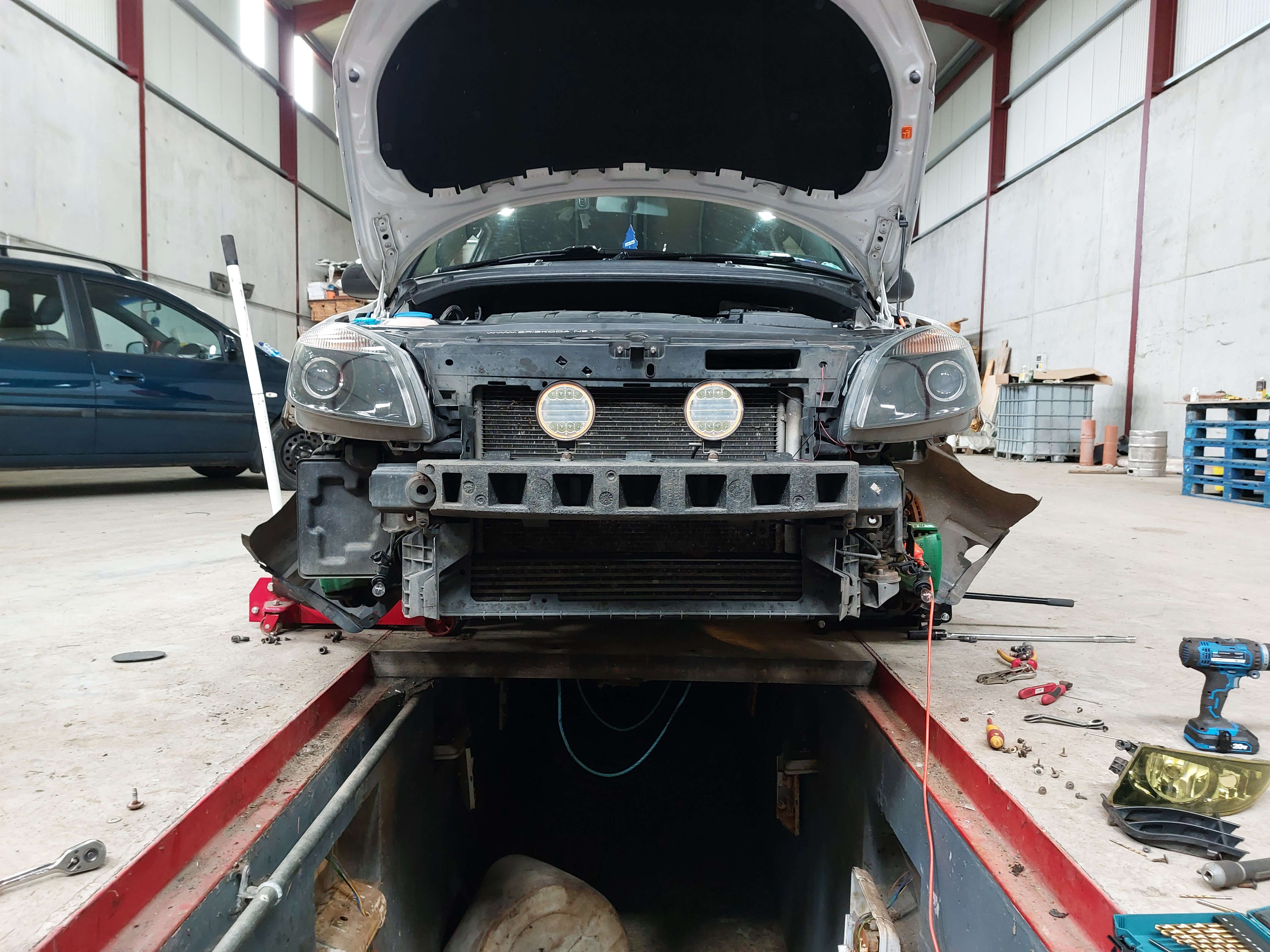

I chose to drill the crash bar to bolt the intercooler to it.

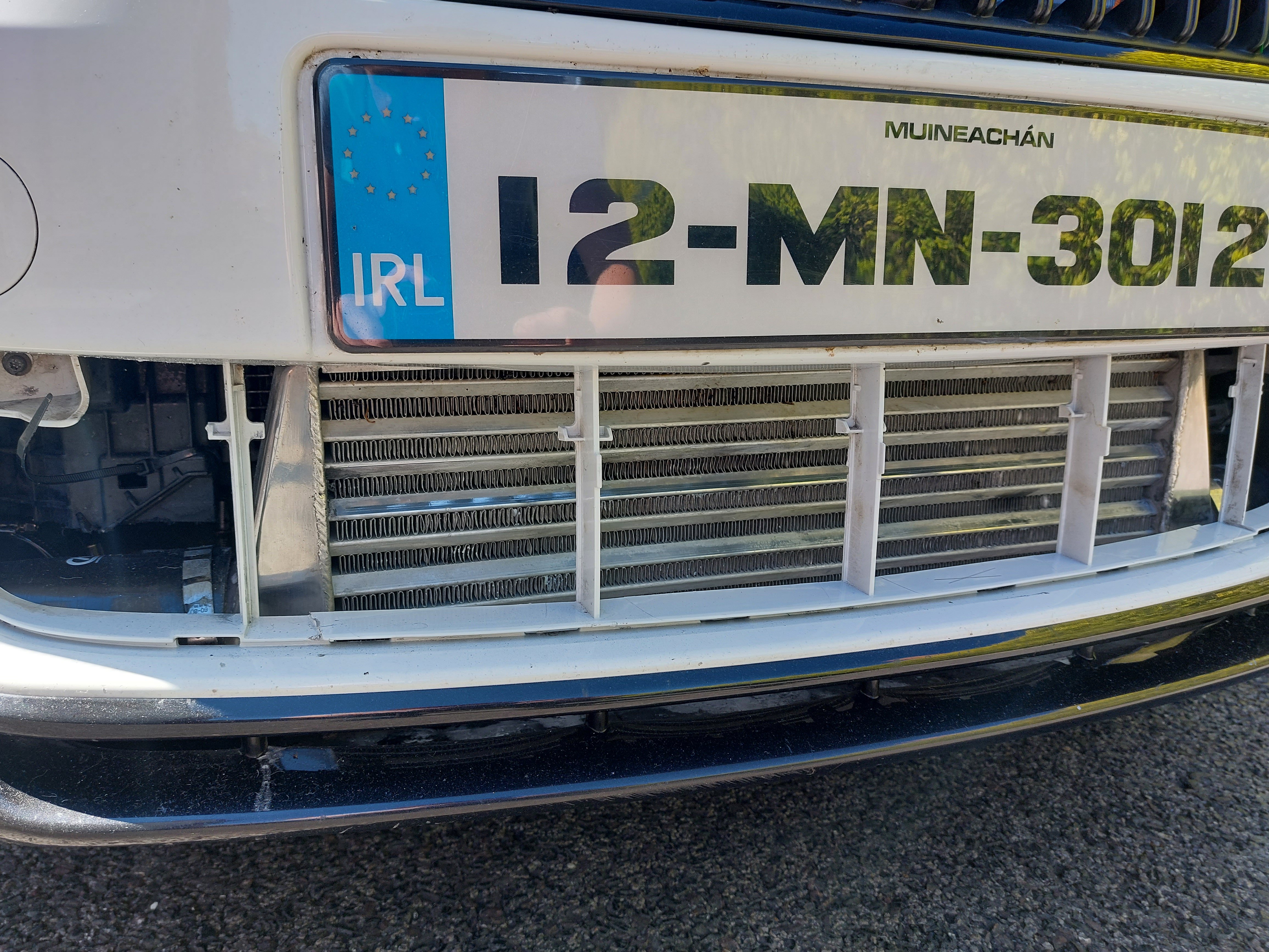

This does fit behind the bumper ok, atleast it did on mine.
Including this photo to show that it's not terribly noticeable on the car.
