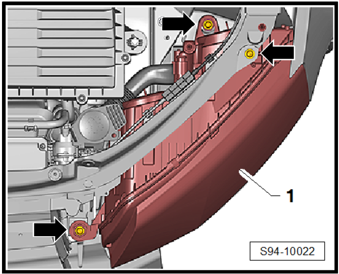

Oh wow this is great thank you! Is there an equivalent page for removal of the headlight (or perhaps it is straightforward when the bumper is removed?)
They are usually fairly straight forward, but you need to help by stating which headlights you have.
You have halogen headlights?
And you should be pre-facelift.

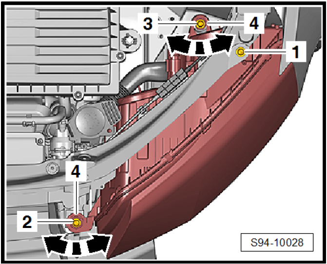

3x screws should do it, pic to follow once you confirm if correct statement.
EDIT: Taking a guess you have Halogen's
Fitting
– Align the headlight according to the contours of the vehicle
body (maintain the gap size ⇒ Body Repairs; Rep. gr. 00)
and loosely tighten with screws.
– Install bumper.
– By turning -arrow- the setting elements -4-, the headlight is
moved and thereby fitted to the surrounding body parts.
