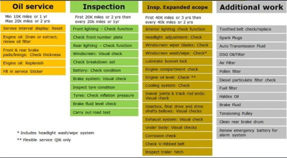

Bottom Menu was how Dealerships were up to 2020 on Interim & Major Servicing,
2021 Skoda UK changed to the Oil & Inspection Services & Extended Scope.
You only get extra stuff done like Haldex, Water Pump / Cam Belt, Brake Fluid. Fuel Filter, Pollen or Air Filter by paying for that.
*Get brales Serviced.*  Dealer Servicing might not have the wheels off for many years.
1168293554_37335614_Screenshot2021-09-14at07_38_18(3).webp.ee5b8a609f78b3b2f42441d7532010fa (3).webp
827614452_SkodaFixedPriceServicing.JPG.3dbea7606c029076ed94e2f0216199b6.jpeg.689c25a185d90e4e44889f342770023b.jpeg
