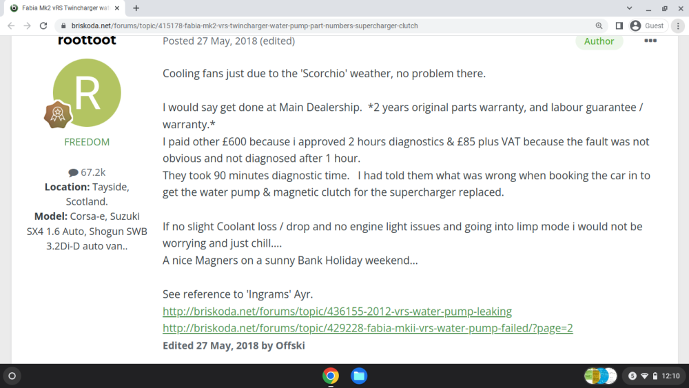

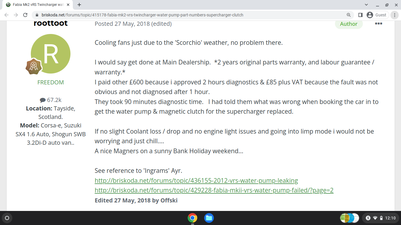

First 30 minutes of Diagnosis is £60 at a participating dealers.    No need for them to milk it.
My linked post / thread tells how much i had paid.   They can take the diagnosis of the price if you are telling them to change the water pump, 2 belts, seal and coolant.
I knew what was wrong,
but there was a reason i had the car at a Main Dealers.
they did say might only take 30 mins for diagnosis, but if they say it took an hour how do i argue that? They didn't say anything about taking the cost of the diagnosis off the price of the work. Will certainly asked about that
If the Technician is just going to get on and do the job once the car is in then the diagnosis charge is taking the pith.
Maybe the connector has corrosion, maybe he can diagnose something else as well and want to measure the Timing Chain.
But if it is the Water Pump then from getting the car into the workshop and pulling on their gloves they know the water pump needs changing.
Simple as that.
They will plug in, get the fault codes logged if any and even if stopping 10 minutes to have a coffee and make a phone call they know within 30 minutes.
Only with me could they not diagnose in 60 minutes and wanted permission for another hour.
I do point out that a kick in the balls hurts if they want to go down that line.

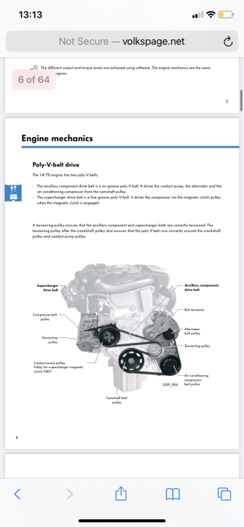

You could do the job yourself in honesty if time is an issue @Mickmartindid it on his drive, also the coolant pump is not on the timing chain its driven by the crankshaft pulley so I would drive it till need be just would monitor coolant loss /temp 421B973C-3069-41A7-A1D6-C96F6012C07E.thumb.png.64a811260413b325e743c2e9b031c184.png
