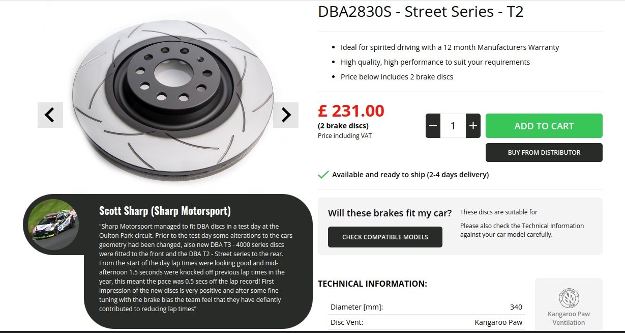

A picture of them when new and how the slots were machined would be marvellous.  Were the grooves of even depths the full length of them or deeper at one end?
Saying who these discs are maybe by or sold by would be super-duper.
How long and how many miles /km has been done using them would be interesting.  IMO.
http://briskoda.net/forums/topic/455363-aftermarket-brake-pads-or-brake-set
