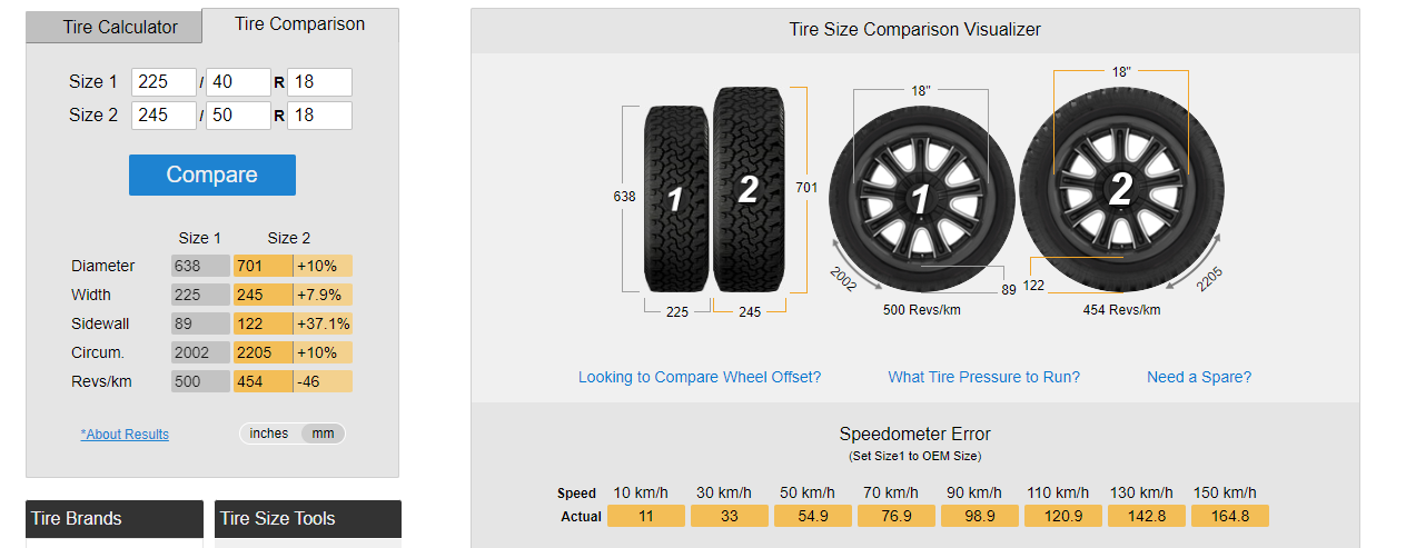

  2. use a tyre calculator like this https://tiresize.com/tyre-size-calculator/ and try to find a size that is as close to your current size as possible. I don't think there will be any issues with ABS/ESC as long as all 4 tyres are the same size.

  9. although all relevant, i think the main point here is that I don't think that tyre will physically fit under the arches, especially the fronts on full lock.
  10. You don't say which Octavia you have but I don't think it matters. What matters is that these are critical safety items, you really need to be putting the correct size on for the wheels and space available (or at least very close). Plus, any difference in size will also effect your speedo. The standard size for the 18" wheel is 225/40/18 so the original tyres were off to start with, but what you have purchased is way off and I don't think they will even fit without rubbing. I would be cancelling my order sharpish and order the correct size. Look at the image below and you can see how much bigger the tyre is that you have just purchased, and your speedo will over-read a lot. Why did you purchase such a large tyre? if you are after more grip then really the only way to get that is to buy a better, high performance tyre like PS4's or Goodyear F1's
