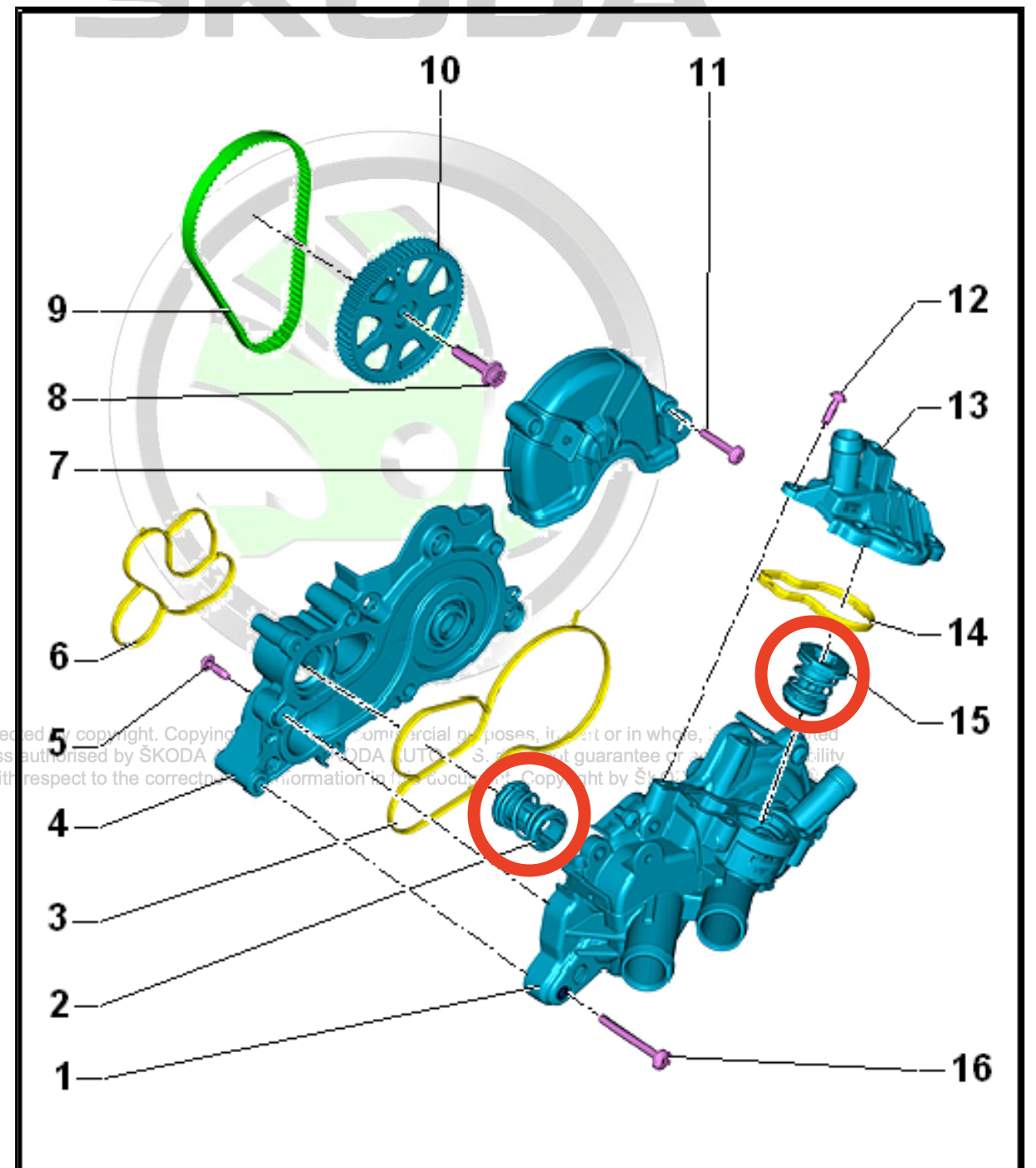

3) According to the workshop manual (below image) and Skoda part catalogue (https://skoda.7zap.com/en/cz/octavia/oct/2013-753/1/121-121003/#2), 1.4 TSI engine has two 105 and 87 degree thermostats (2 and 15 in the image). Which one should I replace? should I replace both thermostats?
4) Are the Gaskets (6, 9 and 14 in the image) needed to be replaced too?

Aftermarket pumps and thermostats are avaliable cheaper, we bought an FAI one for around £75 and fitted it ourselves, but that was only part 4 from the above diagram, around 2 hours work, probably came to around £120 with new pump, coolant, belt and clips.
You could just replace the thermostat(s) but the waterpump has to come off to replace them anyway, and waterpump reliabilty not a VAG group strong point.

Just realised that the thermostat number 15 in the diagram is acessable with out removing the waterpump, so like J.R. says if might be worth testing this one first, this would make it a much cheaper/quicker fix (seem to remember that there are a few topics on here featuring this as failing)

I would start by testing, and/or mabey replacing the thermostat numbered 15 because I'm pretty sure that this is the one that controls the flow of coolent to the radiator.
It's a very easy job to do, half drain the coolant, move some hoses and pipes to gain access, undo a few trx-star screws, and you've gained access to the thermostat.

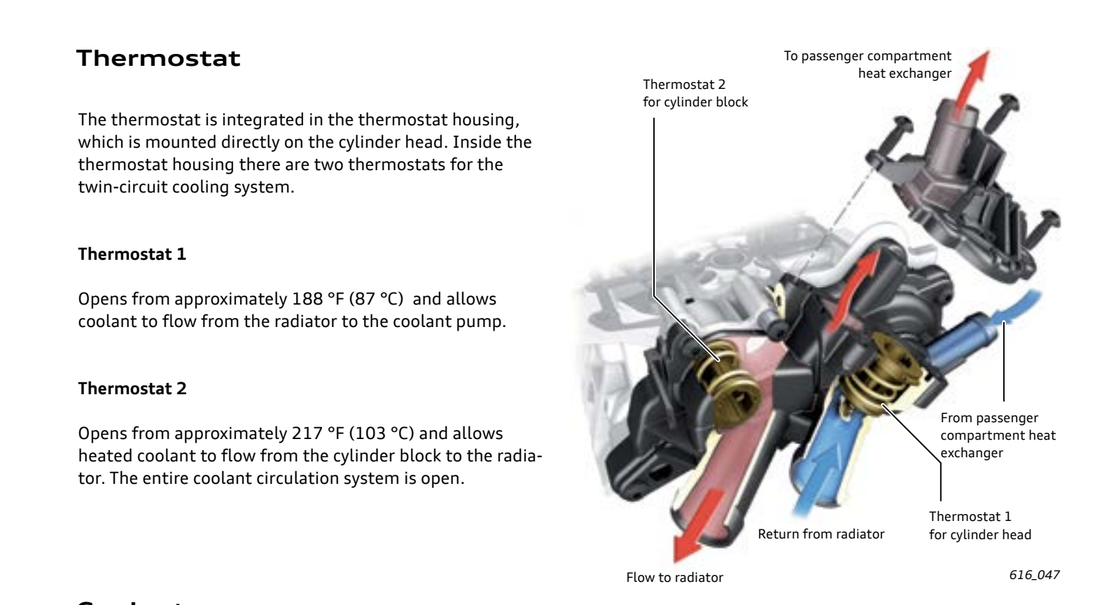

@R_U_AFA and @J.R. thanks for your help. I will do as recommended, but I think the 103 degree thermostat (#2) is the broken one because I can feel it get warm gradually before the engine gets to the 90 while the 87 degree one (#1) is cold . From the guide below, I think the 87 degree thermostat is for the water returns from the radiator whereas the 103 degree is for flowing to the radiator.
