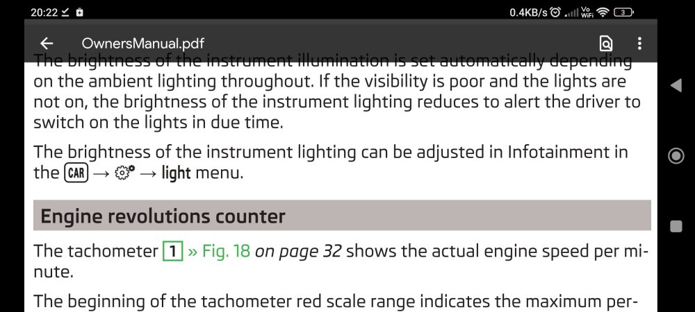

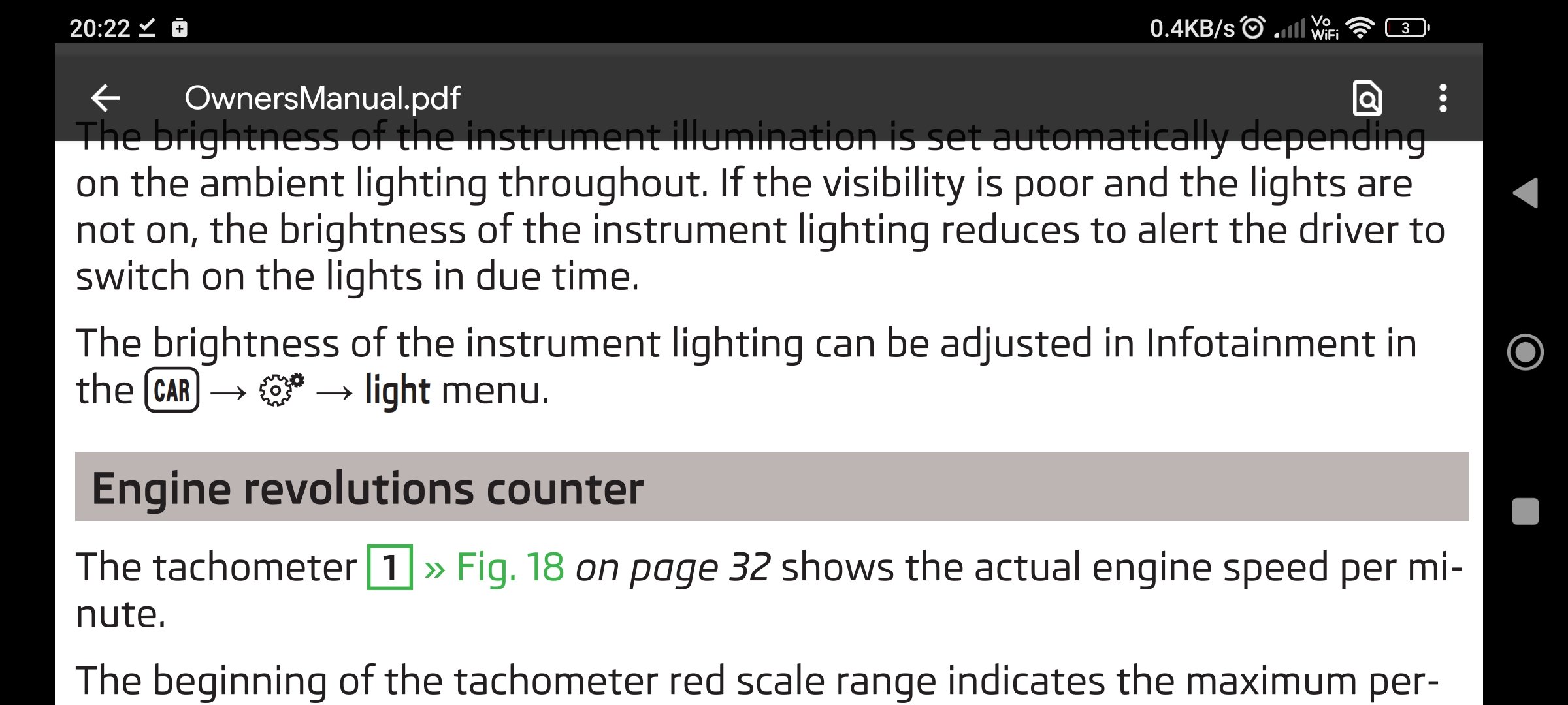

OK, so I’m embarrassed to admit I’ve completely forgotten how to adjust the lighting level of the instrument cluster 🙈; all reminders most welcome.
Sunglasses 😎
Screenshot_2022-09-28-20-22-10-089_com.google.android_apps.pdfviewer.thumb.jpg.e52e91dc7d247125ce574333445c0491.jpg

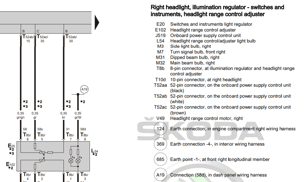

On a Yeti, the dashboard dimmer is a rotary dial next to the headlight range dial. It's optional so probably not fitted to your vehicle...
Example part: https://www.ebay.co.uk/itm/325291042469
Should be pretty easy to retrofit, it's just three wires and I don't think it needs coding:

That would need to be popped out and replaced by the headlight range and backlight brightness version. I'm not sure if you'd need to replace the connector too or not.
Brilliant; found and done!👍🏻
OK I understand now, its a dual switch, perhaps the ones on my Octavias were also, I had assumed they were seperate switches.
I have just looked in the car and the cut out looks big enough for a dual switch 👍
From the diagram I should be looking for a connector with 4 pins hopefully populated with 8 wires, is that correct?
Other way round...
It should be an 8 pin connector and it'll have either 5 or 8 wires.
I say that as the headlight range dial uses 3, the LED backlighting use 2 so I'd expect 5 to be populated.
The final 3 would be the backlight brightness dial but as Skoda don't tend to add unused wires, you might find these are missing :)
