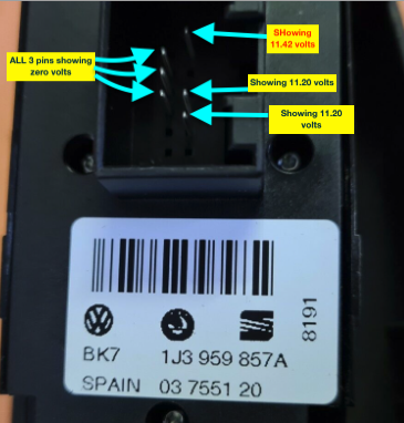

Hi Guys though to update as I have never got this info straightforward may help somebody , my window switch (Fabia mk1 2007)  have intermittent issue and when it is NOT working just checked the voltage and it seems 3 pins at (one side- as shown in attach image ) out of 6 pins have voltage , One pin had voltage of  11.42 volts   and other 2 pins had 11.20approx . Rest 3 pins on other side had zero voltage so I assume   car computer is sending correct voltage  and now will see the Window motor voltage and update you soon once I find time please. If motor have issue I may have to open and test the bushes and clean for garbage inside groves or even replace new bushes if I get it( not sure ) .   Please note that car key was switched on position but car was not started.

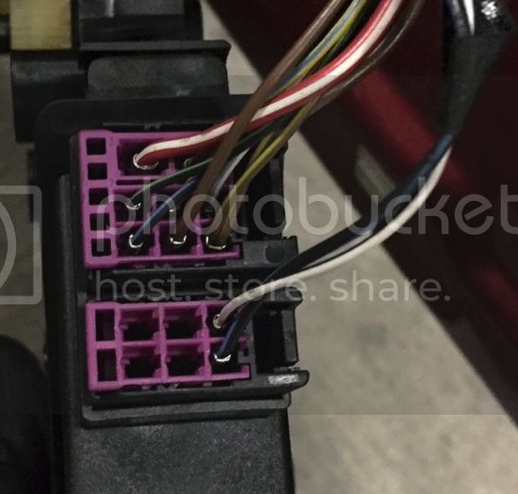

I have removed the inner connector from brown holder just pushing slider& inner black connector came out easily and  one can clearly see/test the pins -( 3 + 3 pins ) with voltmeter.

I will check later on my test rig, but I think it's probably normal for you to see the voltages that you do there, until you start pushing/pulling the switches, at which point the voltages will decrease to either zero, or somewhere in between 11V and zero depending on which way and how far the switches are moved.
You will probably find that the middle one and possibly the lower one of the three pins that you have measured at zero volts show a voltage if you put the car's lights on. That's the feed for the LED lighting of the switch panel.

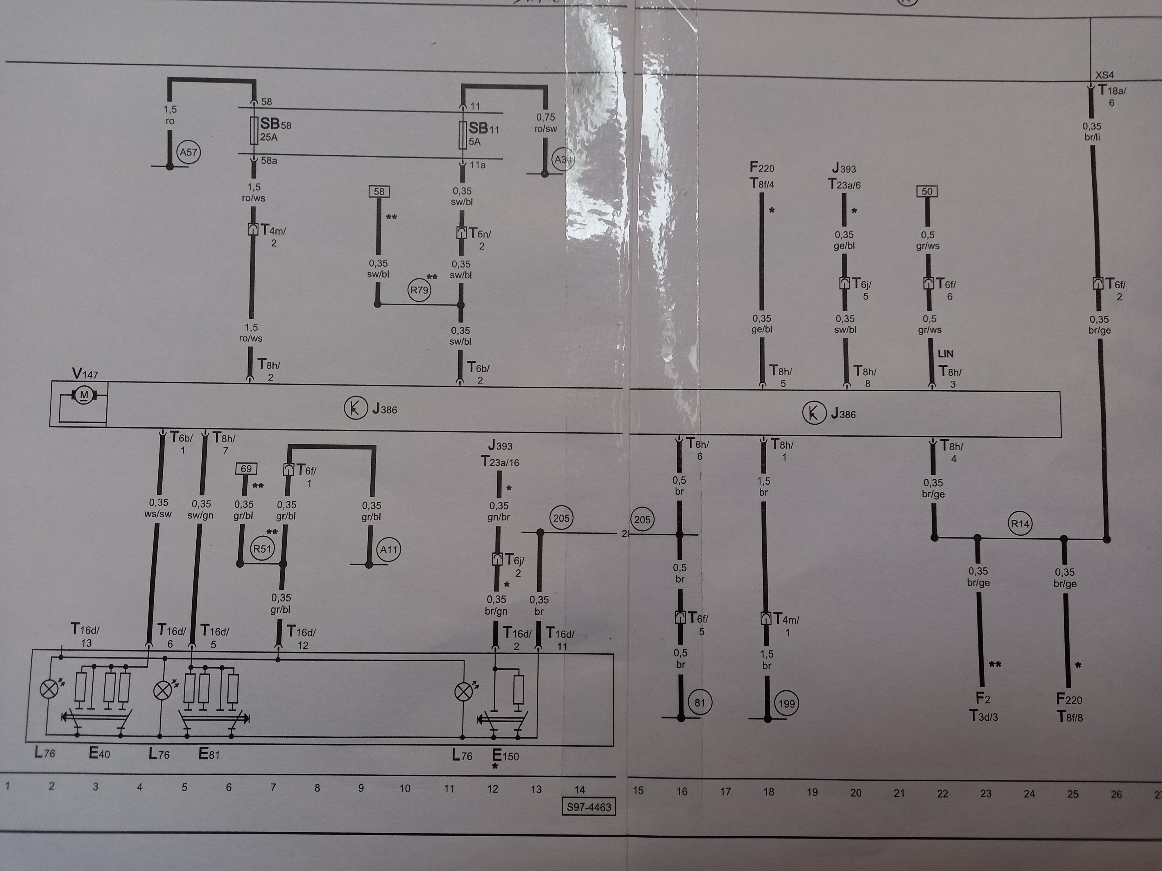

The wiring diagram for driver's side looks like this.
J386 is the motor module. Below it in the diagram is the switch panel. F220 is the lock module. J393 is the central convenience control unit.  The fault on a mk1 Fabia is almost always inside J386.

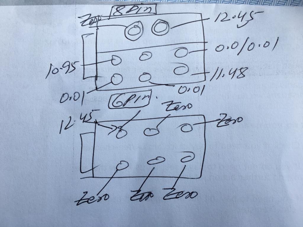

Thanks Pete , I think I have done further investigation on motor 8 pin and 6 pin connectors because I had brand new switch from SKODA bought 6 years back when I  had issue and observed that motor connector pins voltage does not change even when it is working or not or switch is up or down,   so I presume it is not switch issue.  I have jotted the voltage after pressing switch up/down both and found that only 1 pin in both  connectors value changes from 0.00 volt to 0.01 volt which may be shown in multimeter but it may be LIN or other types signal which needs oscilscope or other specialise tool to notice the wave of voltage. Please find image , I think culprit seems motor unless you have other views. I have also noticed that when connected motor body have 0.01 volts which was puzzling if there is ground issue or still short circuit. I would seek ur help in this matter and possibly after one more check of bushes short-circuit.
