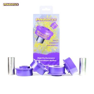

You could of fitted Powerflex bushes and never worried about them again and they are a doddle to fit
resize_image__74680.jpgI done my full car but would now fit PSBushings as they are cheaper but slightly harder to fit as a harder compound

I did look into that option but I installed a subframe mount insert some time ago and I hated it. It was a red one so the softest one but it was so harsh. Looked at psb option as well.
Everything I read online suggested stick with rubber.
