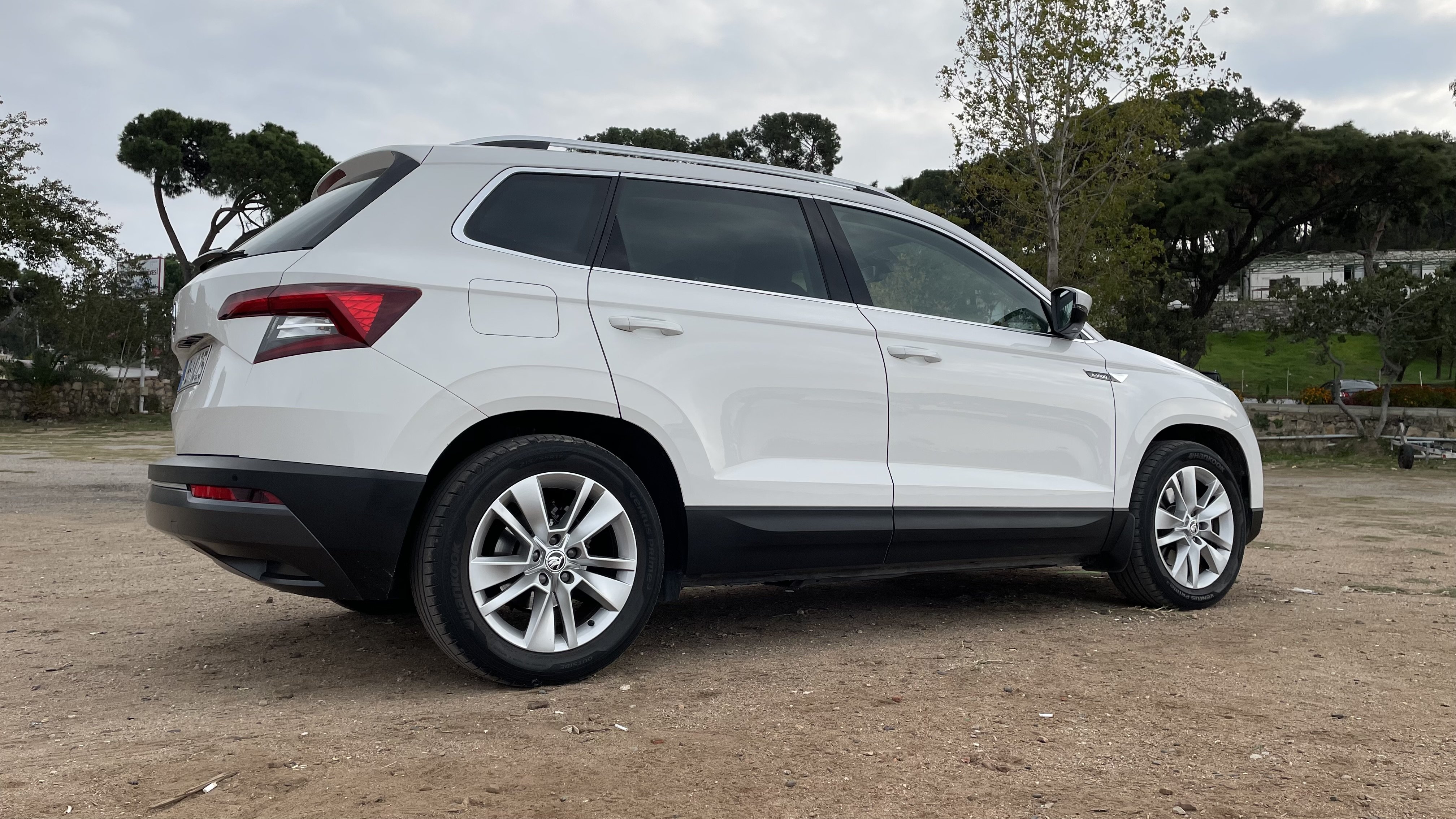

Got 30 mm H&R sport springs and very happy since 2 years about handling and better feel

This sounds the kind of thing I'm after. Did you notice any significant difference in the ride?
The driving become more stable. Especially when cornering at low or high speed you feel stiffer ride. 30 mm lowering did not reduce the comfort, no bumpier ride. Car is still high to easily pass speed bumps.
