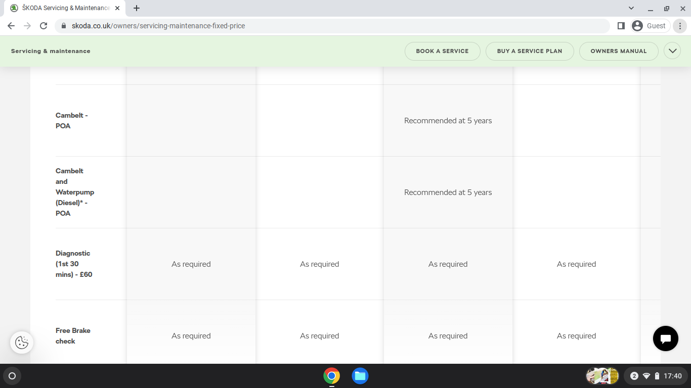

Did the person on the phone at the dealership not explain that Fixed Priced Servicing and Maintenance at Participation dealers means that the first 30 minutes of a Diagnostics is £60 including VAT.
That might be all the time the diagnostics takes.

18 hours ago, roottoot said:
@MikeStoner
No they didn't. At the time I didn't have the odb details, so the fault was vague and they just quoted 1 hour.
