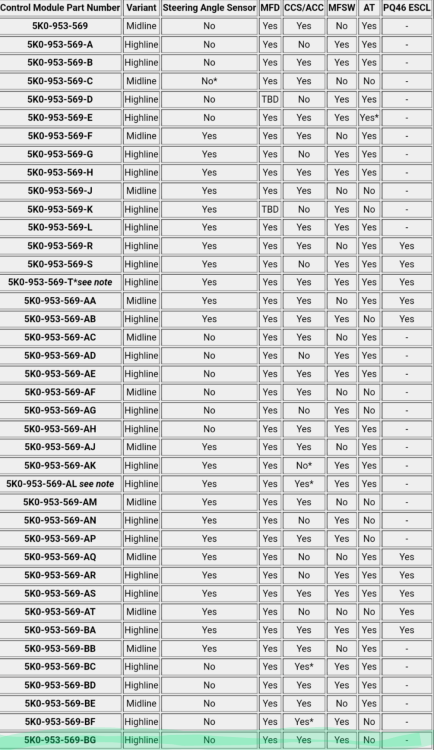

Hi I've just bought a steering control on eBay to work with multi function steering wheel (5K0953569BG)
I've installed it but now my cruise control won't work. And the buttons to change the instruction cluster screen for temperature, mpg etc
My car is a 2011 estate, does anyone know if this module is made for steering wheels that have a separate stalk for cruise, and the buttons for display on the steering wheel itself, I've coded everything to work, like the cruise by turn leaver and the board computer control via wiper lever.
I'm thinking this might be a bit too advanced for my car or should I have got the 5K0953569B
Thanks for any help as this has got me scratching my head :s
