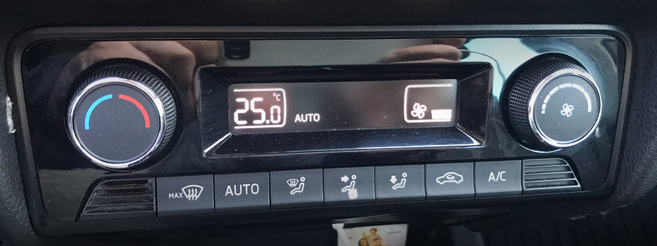

Need How to remove Skoda Fabia 3 AC Control Control Unit
Hi Group
Need how to remove AC Control Control Unit. But don't know how.
Can some tell me or share manual please
must send it to fix button

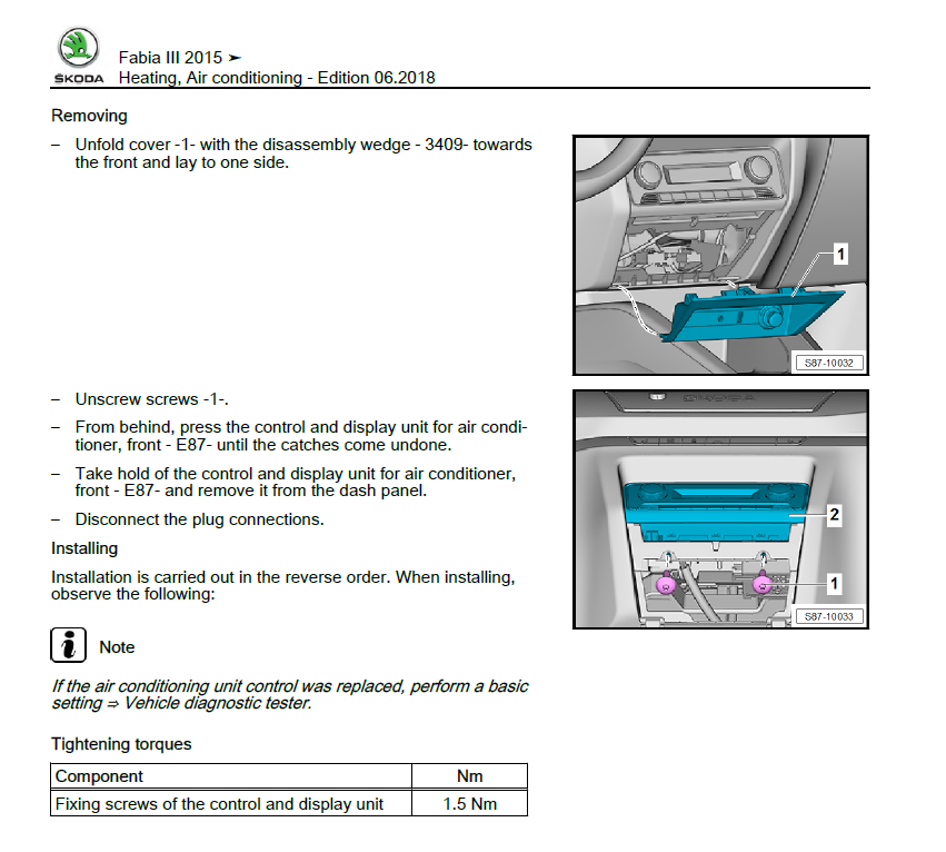

I finally found the documentation. I hope I helped someone after me.
