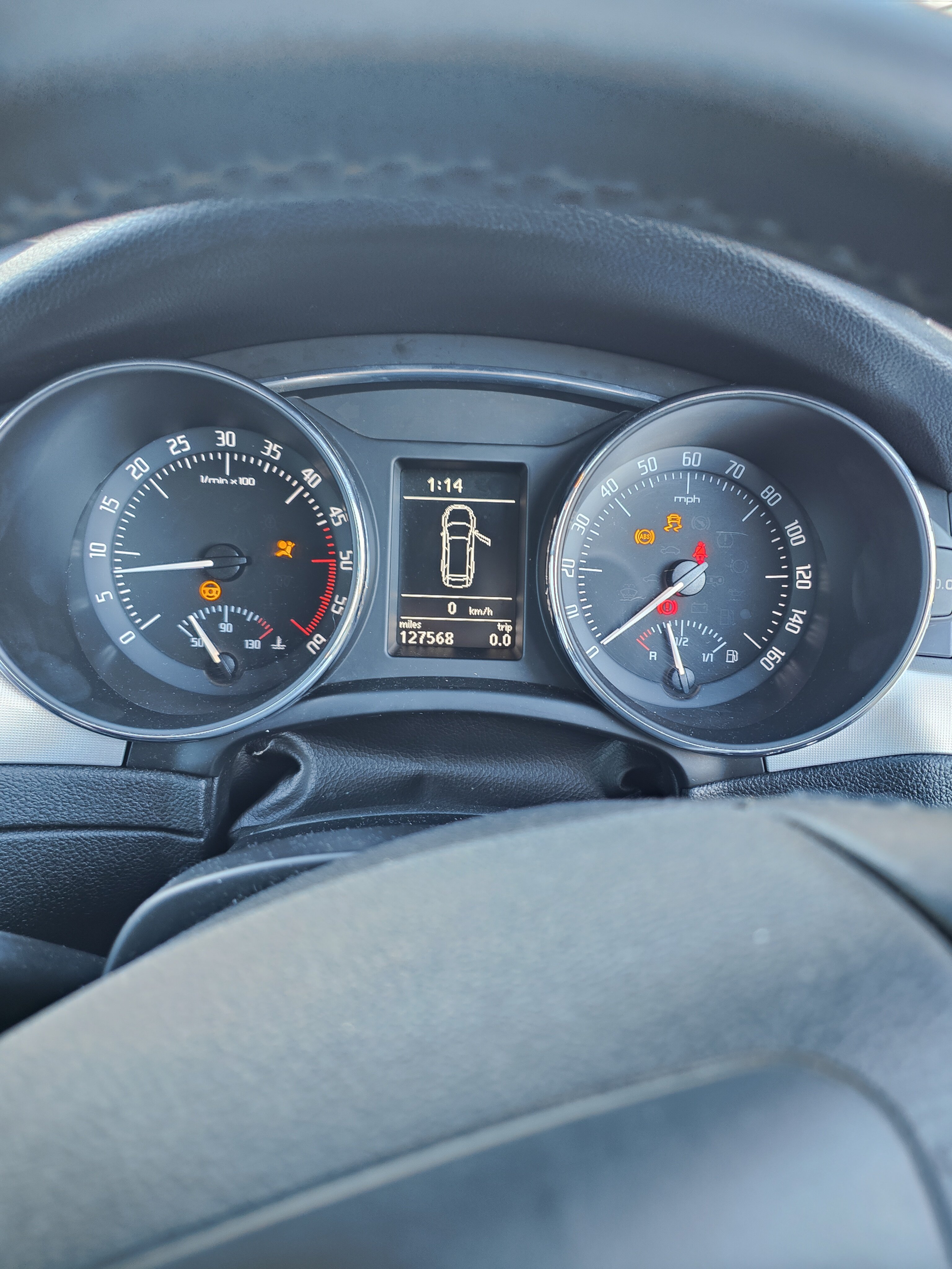

hello guys i need some help.i bought a skoda superb mk2 2010 and i tried to change the cluster from another car just because my speedometer was flashing a bit.when i pluged6the new cluster car started and stoped in a few seconds.i put back my cluster car drives well but i have some errors.i tried to erase them but the one with the steering won't go.it say something about some sensors and because of that error the abs and handbrake and dtc are flashing.any ideas how to get rid of it.thank you in advance

maybe i am bit off topic.i am sorry.but i have few days now and we can't erase the errors.i will try tomorrow to see if i can get the errors.thank you for your reply.the abs,handbrake and the skidding car are flashing.

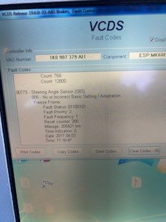

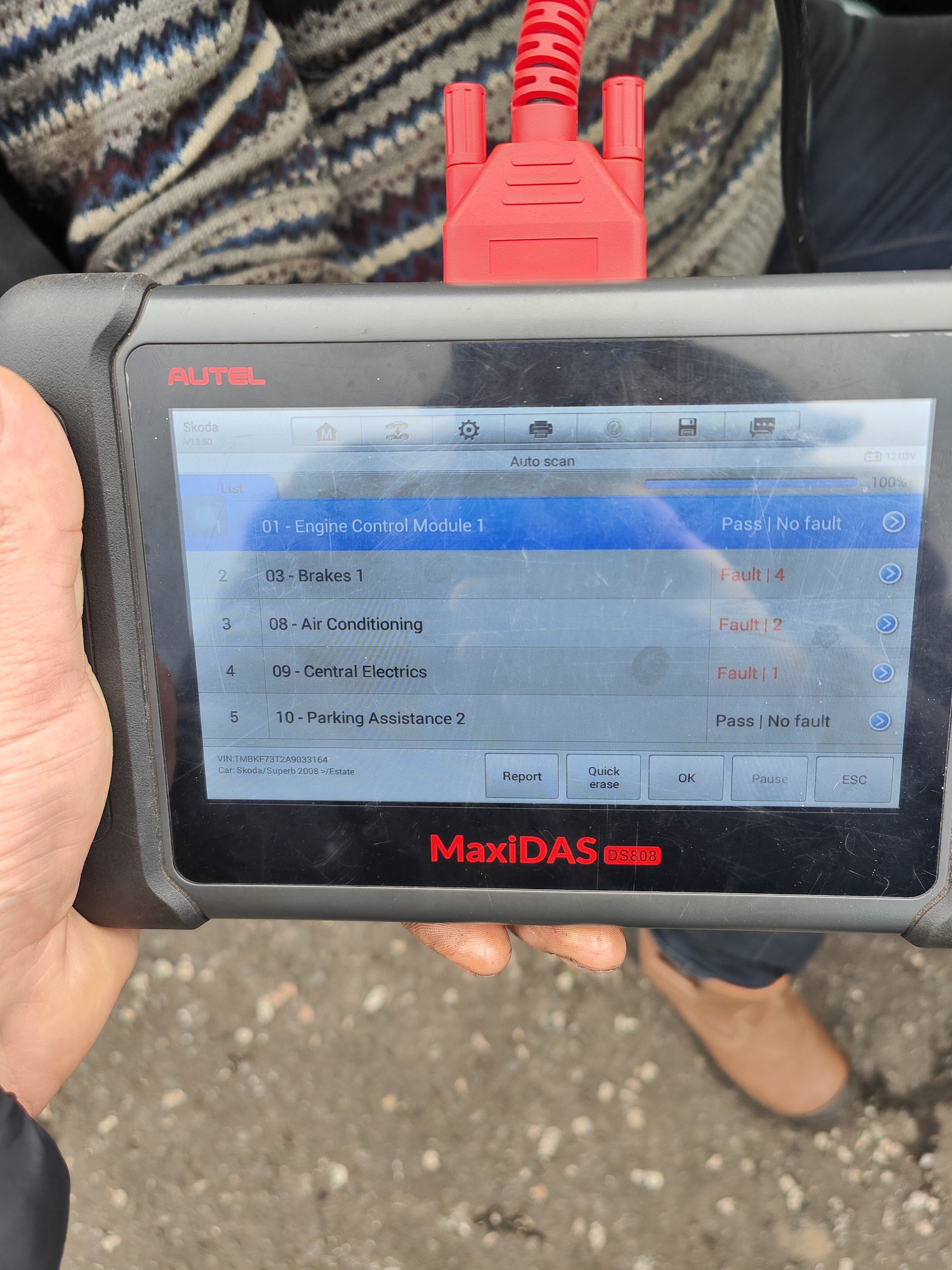

as my English is not my primary language....when we checked the error...one of thw guy told me something about a sensor behind the steering....it reads that wheels or steering are bot straight....and all this errors came up just because i tried to change the cluster.after puting back my old one the beeped a few times and asked for radio code too maybe something happened in that time.i am trying to get a pic from the guy with the vcds...
not the best pics.
i will upload few nore photos later today .i have a neighbor with different computer .but it reads same errors...will make better photos

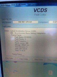

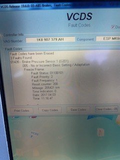

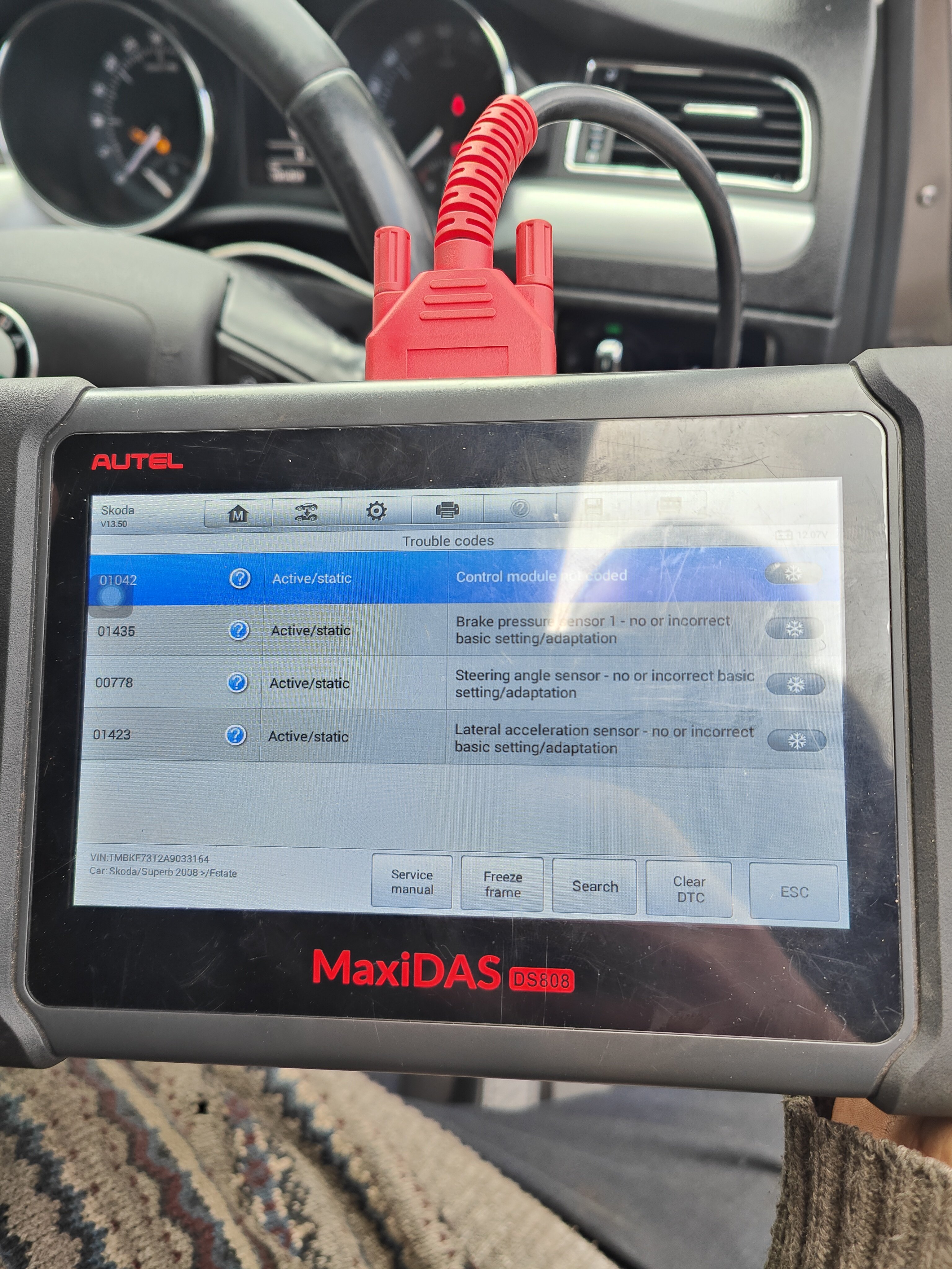

hi guys.i am still waiting for the guy with the vcds to call me .he is away.but my neighbor has computer decent one.buthe problem he doesn't know to work with it to well.i will put some photos with some errors wich they require some codes.im the second pic you can see that it say control module not coded.IMG20221112114324.thumb.jpg.31844e13e563e8dc797e1f7089be82a5.jpg
fault code is 00003.control module

Software Coding: 00000000000000000000000000000000000000
That's your problem...
By replacing the cluster the ABS module has lost it's coding.
