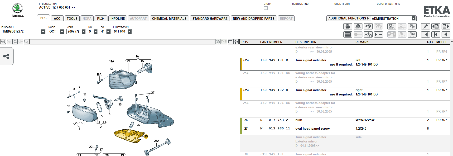

This is the parts diagram for an '07 Octy.  You may need to look at the option codes to decide which one applies to your car.
https://skoda.7zap.com/en/cz/octavia/oct/2007-419/9/941-941040/#25
This shows a separate bulb so not a sealed unit after all. 🤔

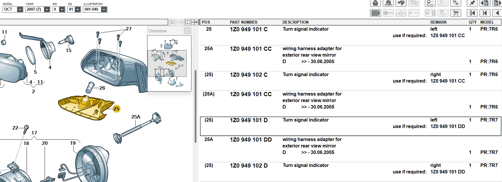

Got delayed a little, try to check out these choices.
Exploded part diagram, I am sure it should be this part seen if I have got your request correct for the bulb under wing mirror.
1Z0 949 101 D
I think this is your likely PR Code, but of course I could be wrong

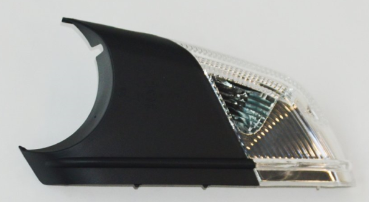

This is what the part looks like, it should be same on other side in mirrored orientation
Just checked the '08 Octy in case you had a late '07 build but it looks the same.
https://skoda.7zap.com/en/cz/octavia/oct/2008-419/9/941-941040/

@MikeTheThinker Just need to know if the image above is what he is after, looks like a wombo combo unit to me?  But not seen one in the flesh.
1Z0 949 101 D

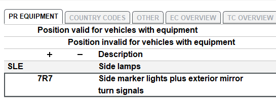

If I've understood this correctly, the PR code 7R7 denotes that the item includes the puddle light - is that right?
Yes this is how I read it also, it's best if you can compare the image above to opposite side.

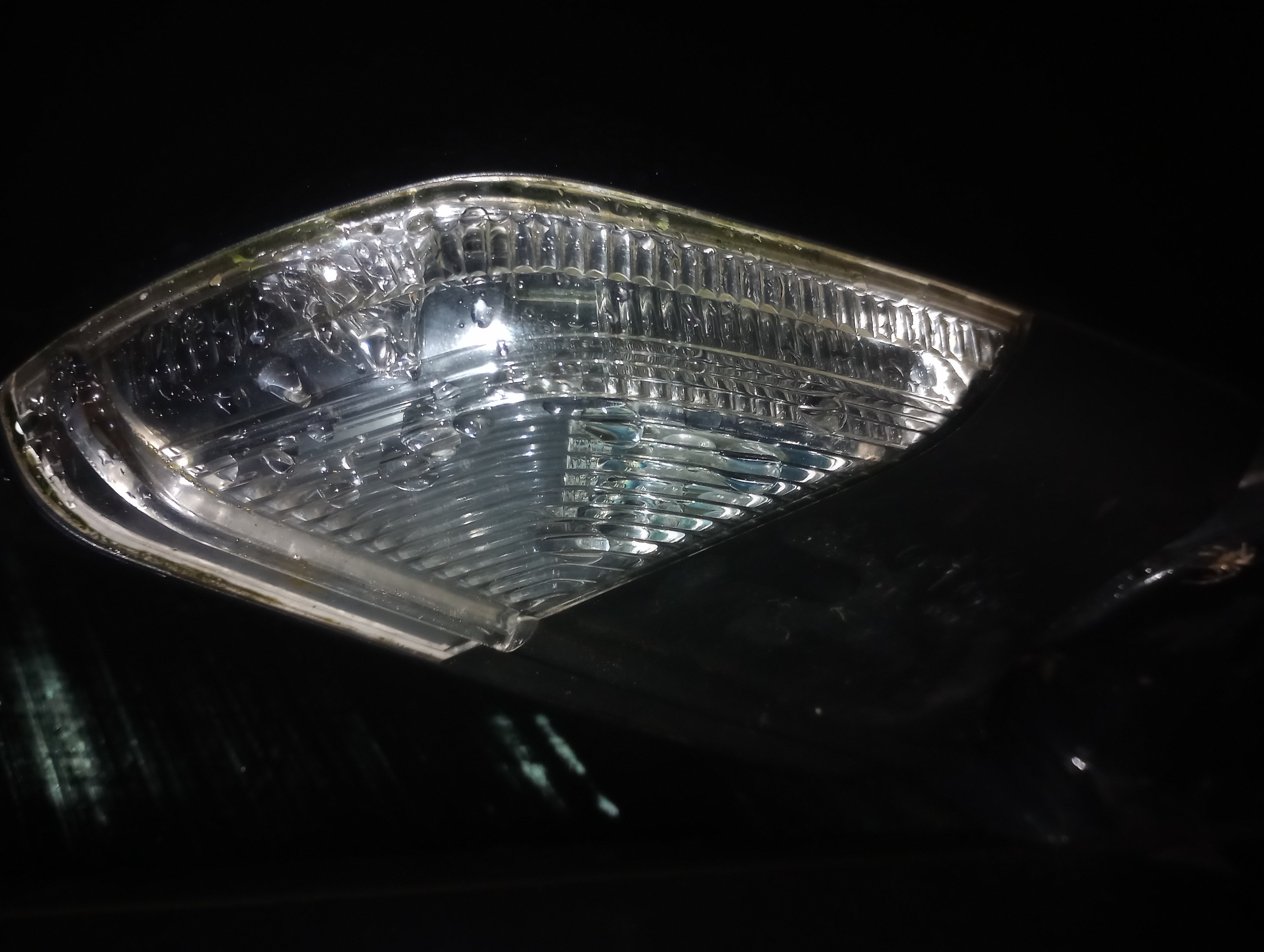

Just nipped out for a look and this doesn't look quite right. Here's mine. Sorry, it's dark out there...
Might need a daytime shot, if not send PM with full VIN.

I'm beginning to think the 5W5 bulb is for the puddle light and that the indicator is a built-in LED necessitating the replacement of the bottom of the mirror. 😭

1Z0 949 101 C
I have done the VIN filtered search, and it seems you have the original part mentioned fitted.
Oddly doesn't look like yours, but you either need to get old one off, or opposite side if needed (part number will be 99% same, just 101 / 102 for left/right for example.
@StuartA
The repaeater is LED, the puddle light incandescent bulb.
Should corrosion not be the issue I suspect you have a bad wiring connection necessitating disassembly in situ of the mirror housing and jiggling the wires into the door with the relevant indicator active to check for operation.
