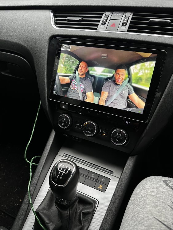

so after deciding to upgrade my stereo I got one from our friends at Ali express and just fitted it
nice bit of kit

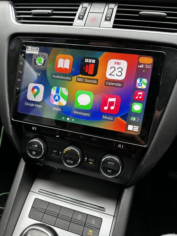

although I can’t seem to get Apple play working through the link app  or DAB to connect..
any ideas?
all wired in ok pretty straight forward although the main look doesn’t give you much room to play with coming over from glove box side … and stupidly I disconnected the switch for passenger Airbag… and Yep I have the airbag light on dash now 🤨

Ok Apple play working now 😛

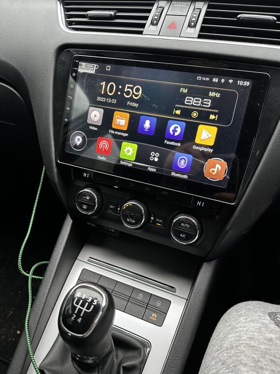

just DAB an the consumer information I can’t find anywhere
mpg info etc etc…
On 23/12/2022 at 13:09, DervMaster said:
Dab isn't included, you need a USB dab adaptor. If your previous car had dab, you can get the antenna back, otherwise you have to add an antena.
This adaptor works good with dab-z or the dab included software
