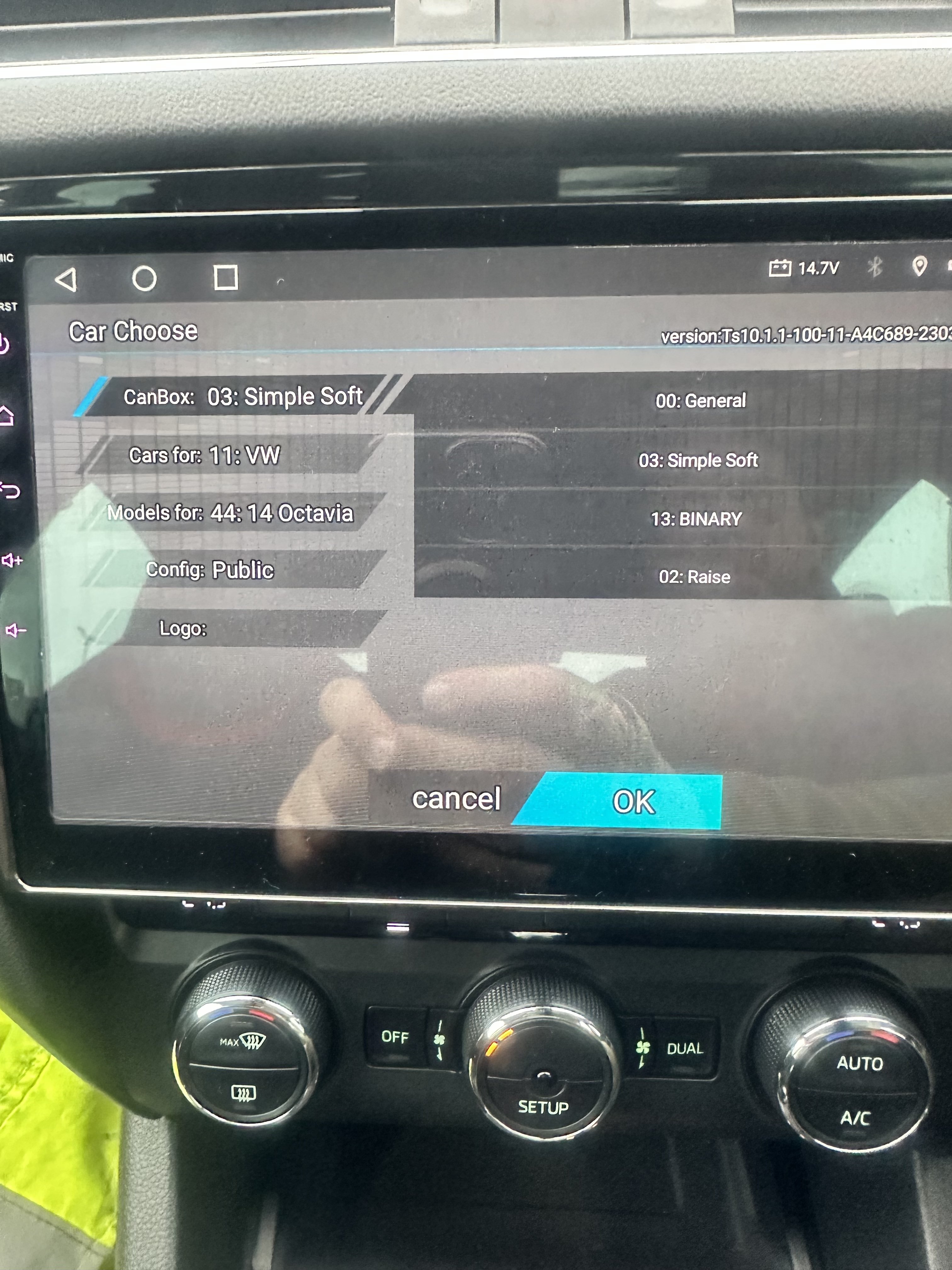

  3. I've been although the menu and it appears it's the same as photo so will select Vrs jist with the Button am look at the box between dials speedometer and rev counter
  4. I had it a 2015 estate 1.6tdi.. Now ive fitted it to a 2015 Vrs 2.0 tdi So presumably Canbus is same as same year?

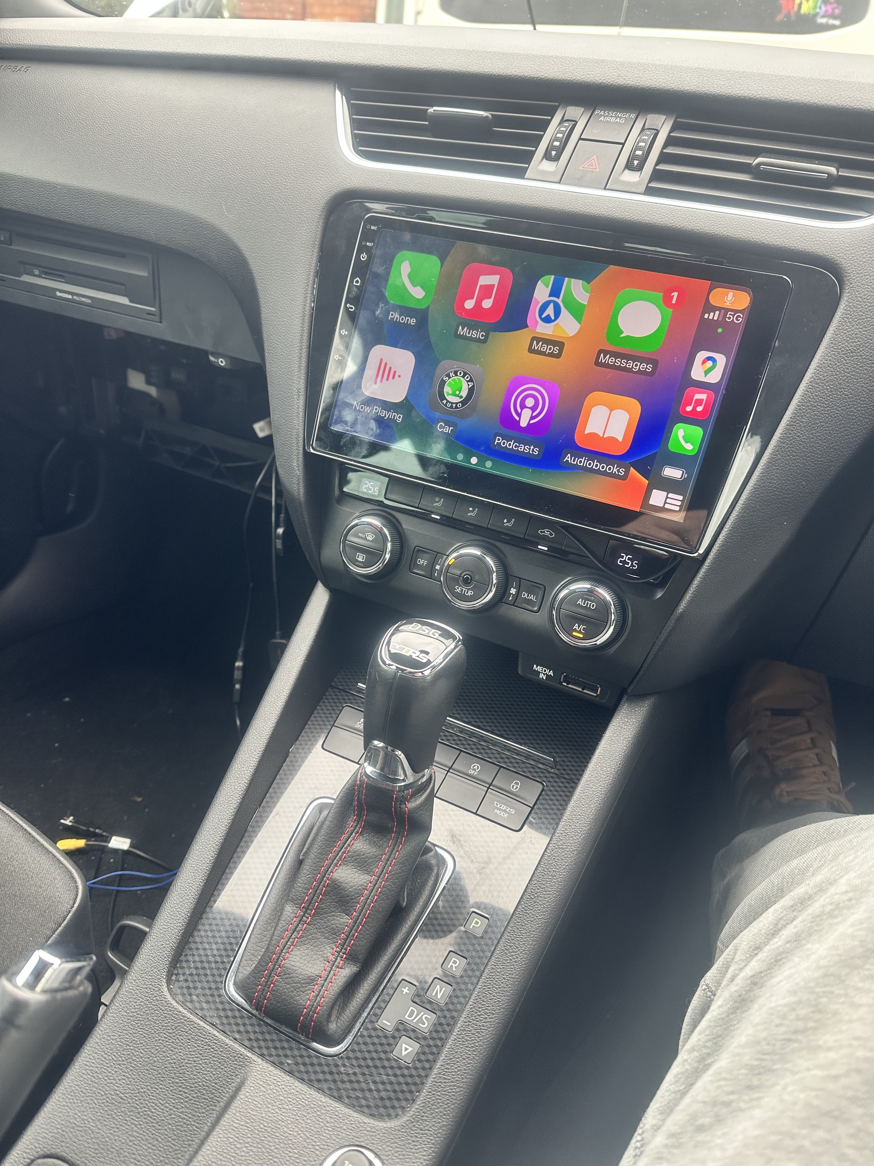

  5. Good afternoon everyone hope your all having a lovely weekend 😁 Out of interest has anyone fitted this stereo to their octy Vrs and if so how do you get it to display The Vrs mode selection on the screen like the factory stereo? I have a changed my 1.6tdi octavia (which I had my andriod unit fitted too) and got into a Vrs diesel and today fitted stereo all ok heater display..door open display etc...steering wheel etc...but Vrs selection when pressing button by gear selector nope Any ideas please

  7. Ive had mine in and out a few times but it does fit after pulling cables through and re-routing..their isn't much length on the main harness from behind glove box at all and first time was a right pain to plug it all in at rear but you can do it 👌🏻

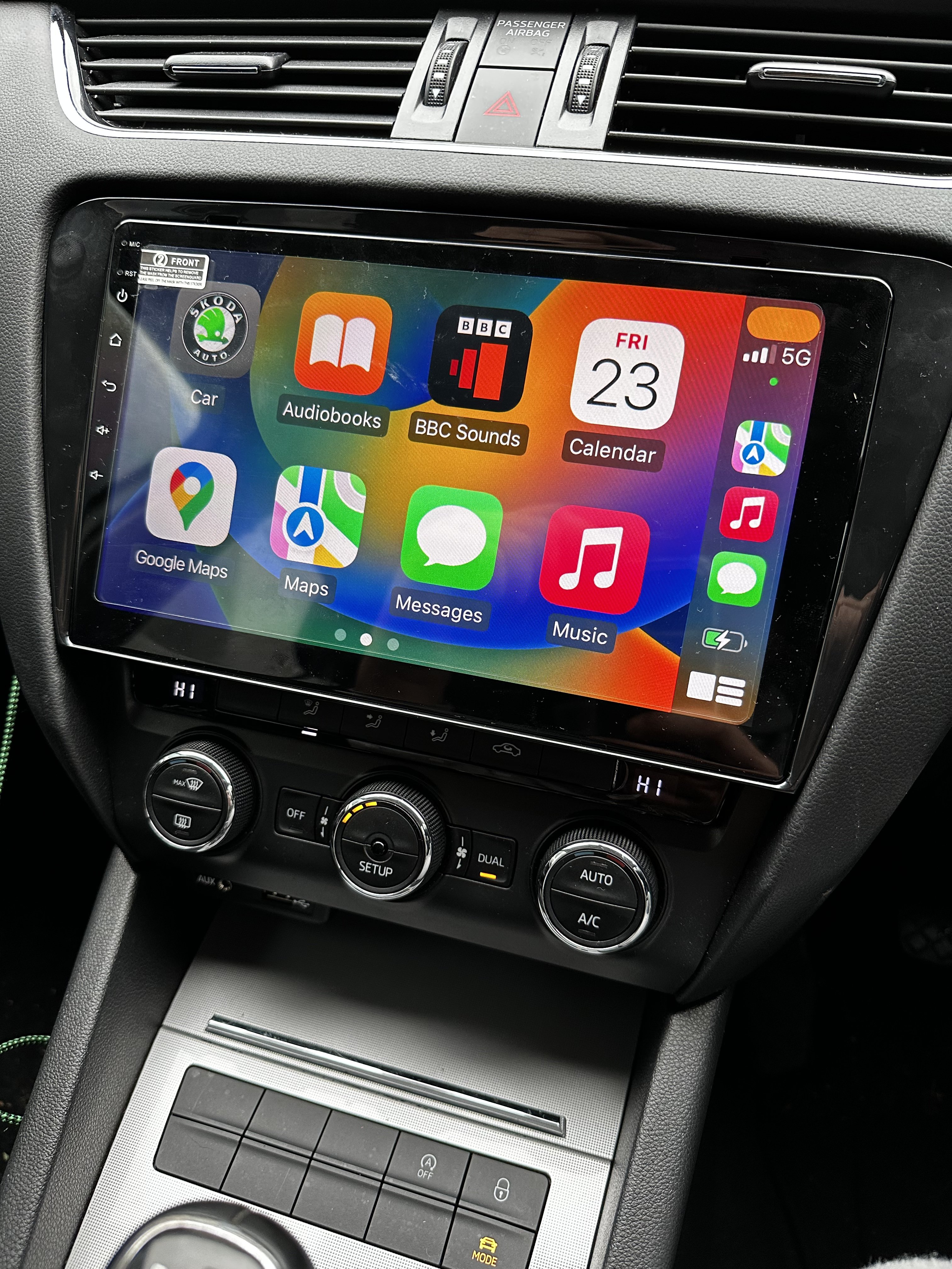

  10. Ok Apple play working now 😛 just DAB an the consumer information I can’t find anywhere mpg info etc etc…

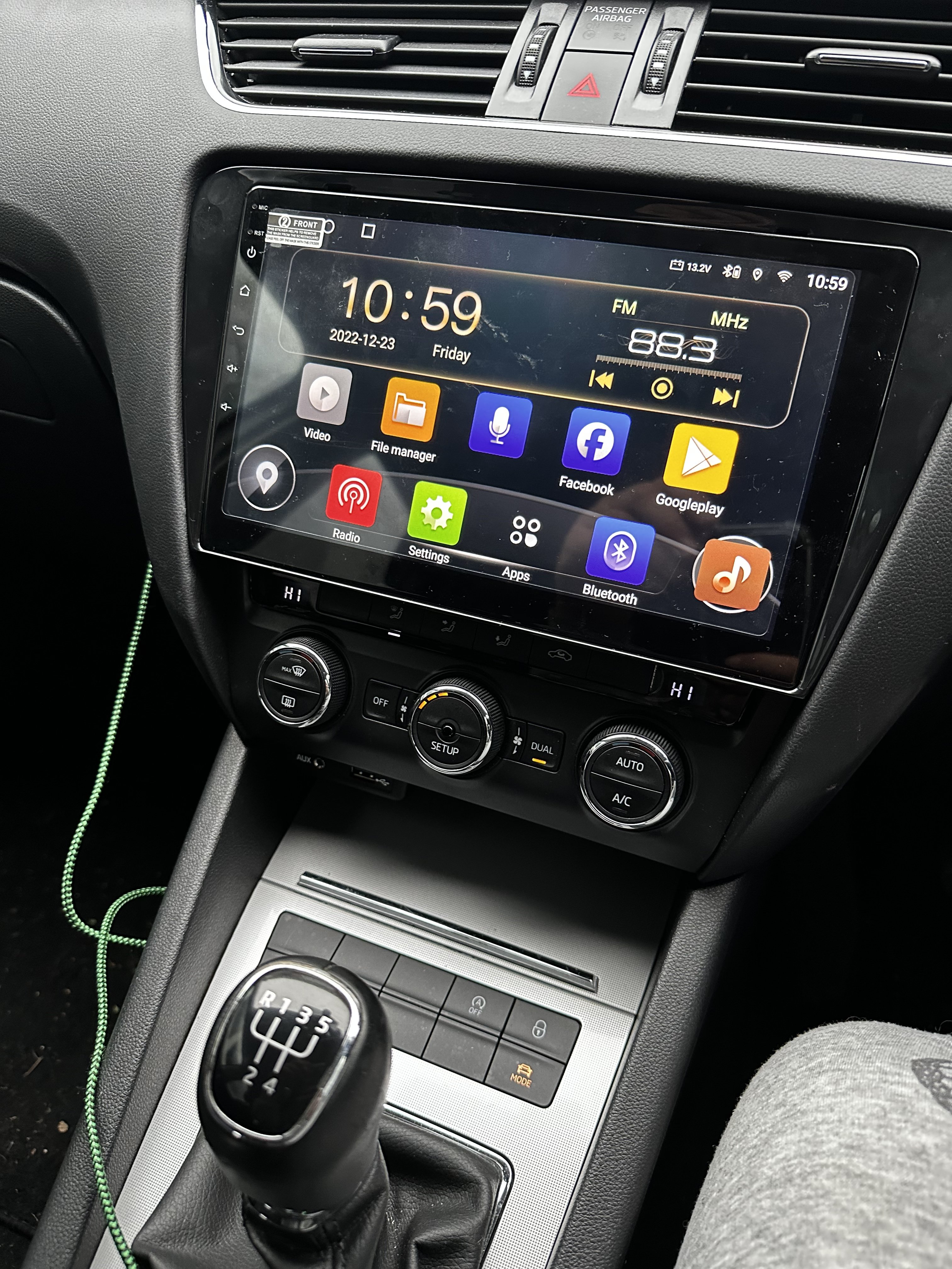

  11. Good morning and happy Christmas to you all.. so after deciding to upgrade my stereo I got one from our friends at Ali express and just fitted it nice bit of kit although I can’t seem to get Apple play working through the link app or DAB to connect.. any ideas? all wired in ok pretty straight forward although the main look doesn’t give you much room to play with coming over from glove box side … and stupidly I disconnected the switch for passenger Airbag… and Yep I have the airbag light on dash now 🤨 my scanner won’t get into it screen quality is fantastic
