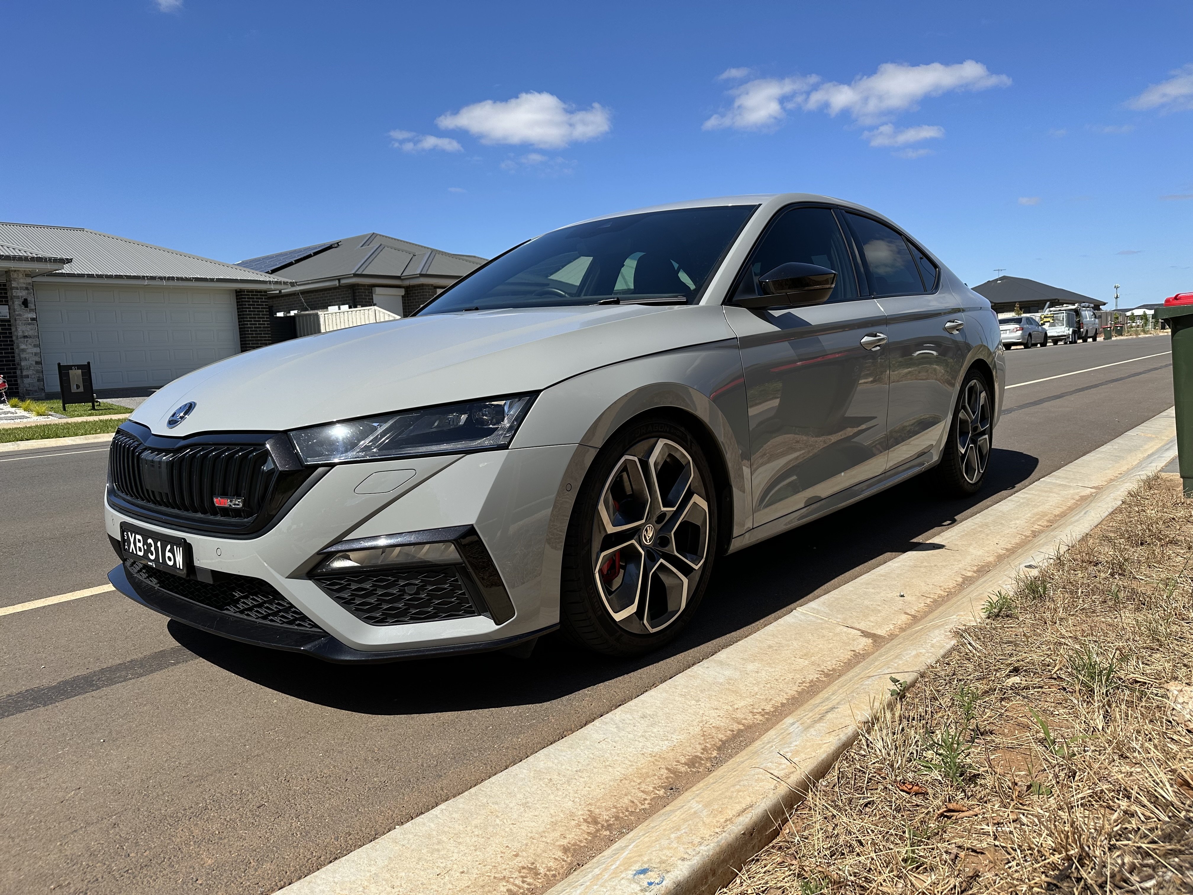

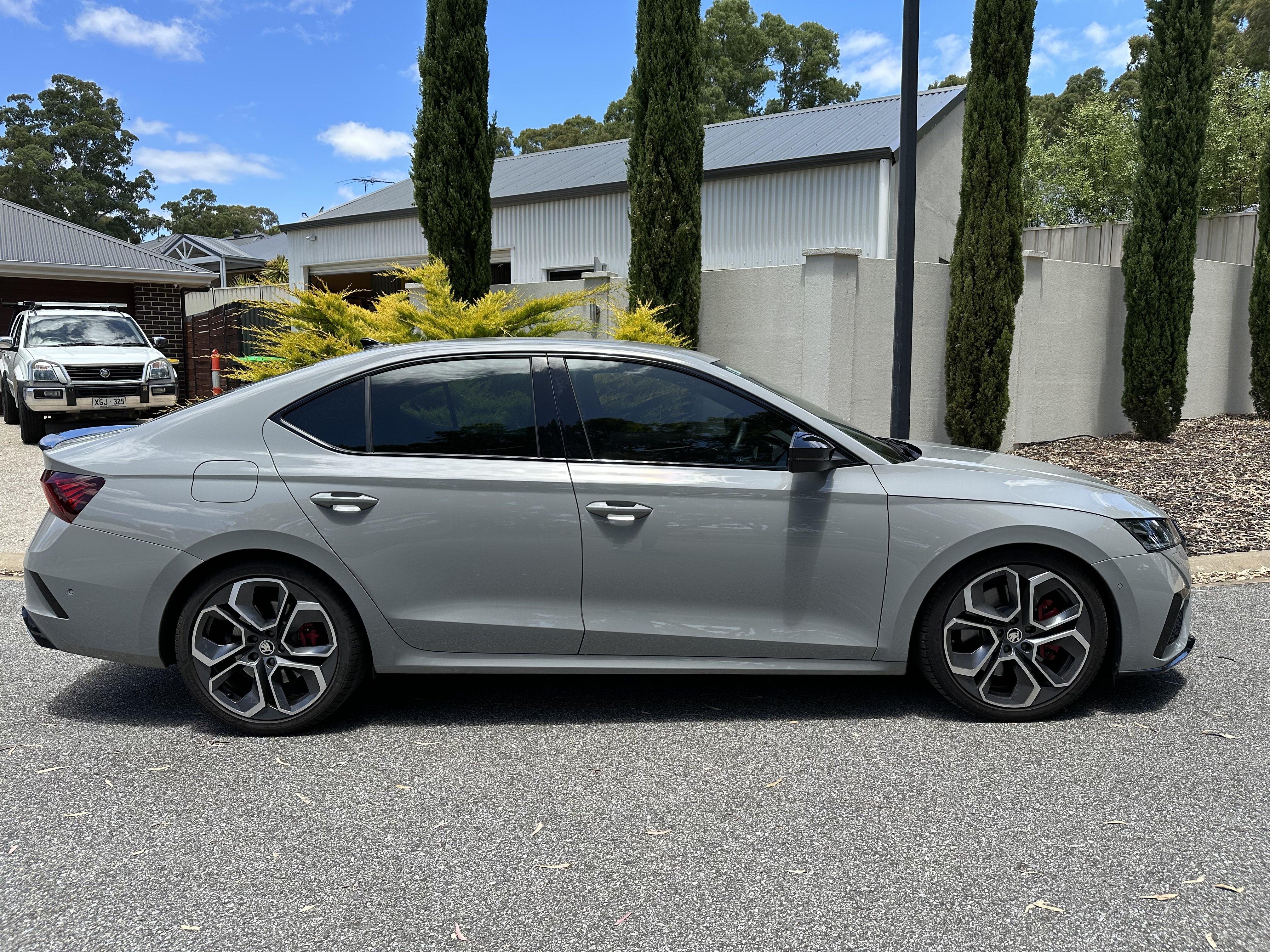

I just bought and installed these springs yesterday - https://vwcentral.com.au/eibach-sportline-performance-springs-skoda-octavia-iv-rs-wagon.html
I have the sedan model, but emailed VWCentral to confirm if the kit would work on sedan and they weren't sure. They got me in touch with Eibach, who sent me a kit for a decent discount to do some R&D for them.
So far so good, the front is 30mm lower and the rear is 10mm so far, but the kit was made for wagon so you should be seeing the 15mm that is expected on a wagon.
I have DCC too and whilst the ride is definitely firmer all around now, comfort mode is still very comfy.
