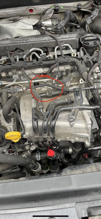

Found it as per
Sadly, much too small for my endoscope 😞
It’s the sensor with the green mark on it that allows you to see the charge cooler
Thanks - my brain is struggling to parse where that is on the engine though!
I'll have to have a root around!
Take the engine cover off and you can see it. Either needs a deep socket or spanner to remove. Think the spanner was easier
Ah great, I see it now. Thankyou.

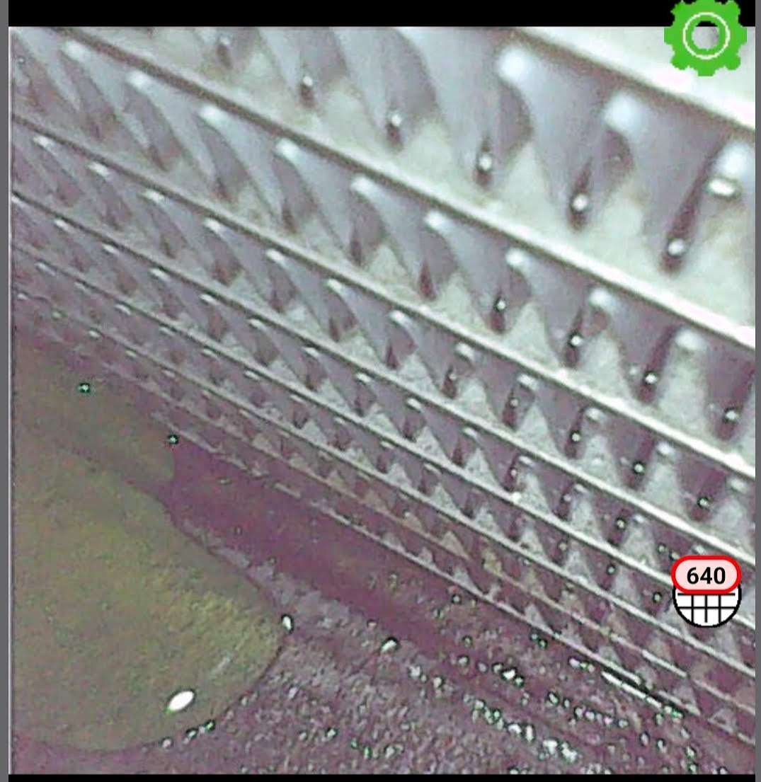

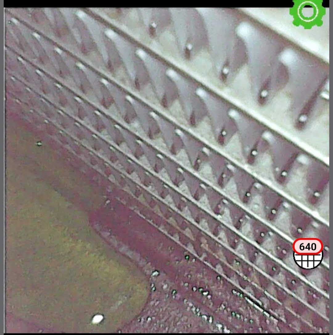

Finally got around to getting an endoscope inside the charge air cooler (thanks to @T07 for the helpful pics above).
I got the engine hot and spent a bit of time on boost - presumably as that drove charge-air into the coolant, pressurising it more than heat-alone, then went in the IAT and saw it fill up before my very eyes...
So, at least it's not the EGR Cooler, or a cracked head...
Photos below for interest.

My coolant is greeny-yellow rather than pink, thanks to the fluoroscein UV dye in there.

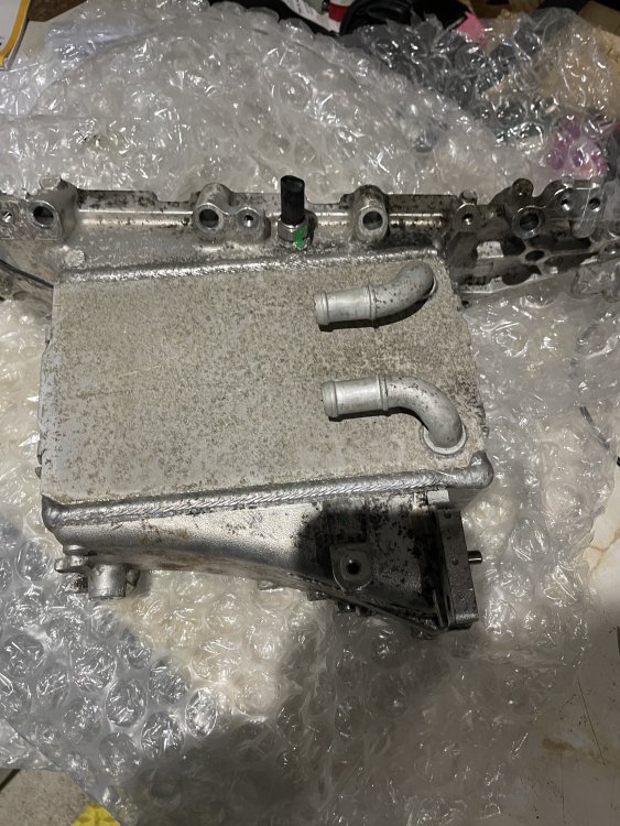

I opted for a used cooler. New one was around £800 or so. Nowhere could get it other than the dealer. You may have a slightly different version though so may be able to find one cheaper? There was no high pressure Egr on mine, not sure if this was introduced to the Octavia but appears on other revisions of the part from golf’s, tiguans and passats.
I also now have yellow coolant due to uv dye!
